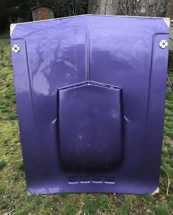

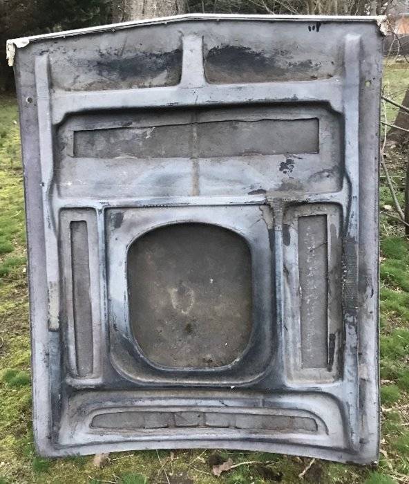

Friend contacted me, a friend of his who’s husband passed away, car is already sold and gone, was a hemi clone...she found this hood and wants to know WIW, I only have the one pic and it looks rough to me underneath, any help appreciated, ty and stay safe all

Someone forgot to pin it at one time. Try to get a pic from the top and the side to see if it is warped.

between 600 and 2500 depending upon the shape of it. this looks pretty rough from what we can see so I say just under 1K. Plus you have to figure shipping unless someone local can pick it up.

I told my friend to try to get more pics, we’re on Long Island and shipping would probably be a problem, fiberglass and large...I know nothing on these hoods other than that the hood pin bezel screw holes look oriented correctly, but the duct work/fresh air area looks like it’s been worked on...

Thank you CudaHunter...see the added pic and info

The vents are solid, if it's original, then someone fiberglassed over the vents. Also no holes for washer nozzles. I'm skeptical it's original

Not an original hood, if you have ever look underneath one this is not even close.

Thanks guys, I didn’t think it was, guess now it’s a WIW..

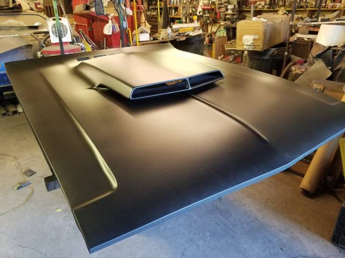

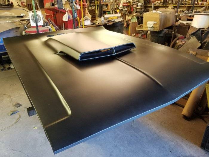

I have what I was told is an original T/A hood. I am also in Long Island if you want to see it to compare

I just saw your post brotow, I will pass your post onto my friend who is helping the widow, but I think we’re going with that it is a repro, thanks for the pic...where are you located on the island, I think the hood/widow is on the north shore, I’m on the south shore...regards
