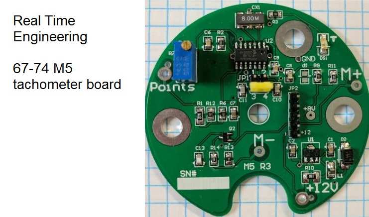

If your tach worked before the changeover from points to electronic then you have a couple of options to stay with the same electronic ignition.
1. MSD 8920 Tach Adapter Available on Amazon. Converts tach signal for factory tach compatibility.
2. Replace the factory tach board with an aftermarket, and more accurate, aftermarket tach board. RT Engineering (RTE) makes the M5 Tach Board for E-Bodies. An article about the conversion to the digital tach board.
If you choose the RTE Tach Board, you should also consider changing out your Instrument Voltage Regulator (IVR) to a digital version. RTE has those as well. That way you take out the Rallye dash and fix both issues.
The pricing is about the same but the time/labor to install is a bit different. Your choice.
