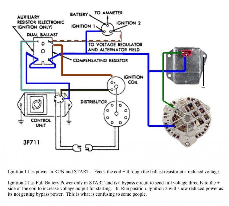

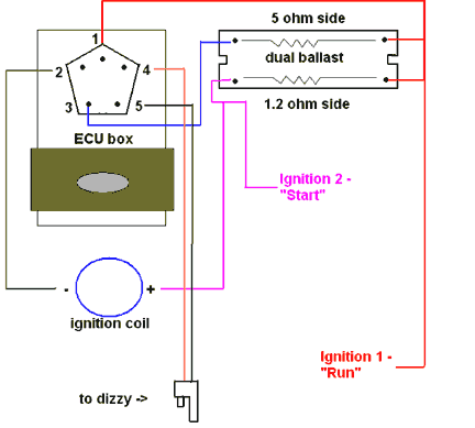

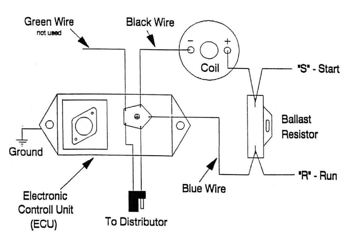

My 72 Challenger will not start consistently. 1.5 weeks ago it was starting fine (after I loosened and tightened the bolt that attaches the ECM to the firewall). If the car sits for very long at all (in a shop/garage) you have to do that or it will not start. It basically tries to fire after you let off the key
When it tries to fire when you let off the key, That usually indicates the ballast resistor took a dump or you have a bad connection in your start circuit at the firewall. (or bad ignition switch)
If you have a bad ground on your ECM, it will still start and run but open the transistor in the ECM after a short time. I'm voting for a bad connection at the firewall since the ballast resistor is either good or bad. No intermittent failures. A wiring diagram and a digital meter are your friends here.

Thanks for all the replies and the wiring schematic.
