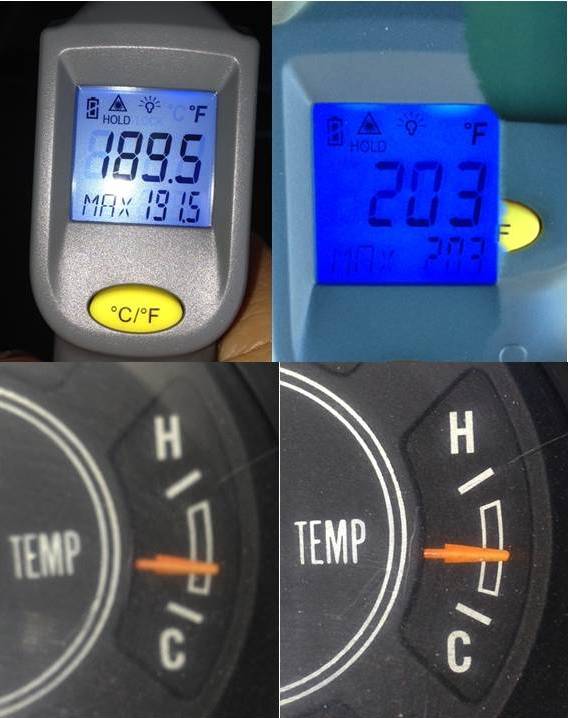

I saved this picture (not mine) from years ago. I don't know where the laser temp reader was pointed.

I believe the factory would have calibrated the original gauge/sender to read about 185-190 mid sweep.
As the years go by changes to senders/voltage regulators etc could affect were that gauge is reading even if your engine is running dead on 185.
Thinking of the gauge/sender and wiring as a circuit any changes will alter were the needle runs.
That's funny, I posted that pic a long time ago
Temp was measured right at the thermostat housing.
