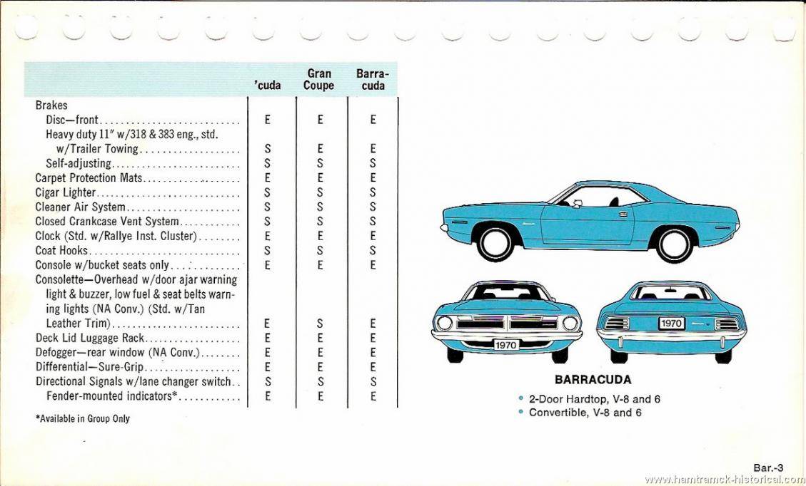

See pic. S is for standard E is for extra cost. This is from the dealer guide that was used when the cars were ordered new.
Yea, your chart is for the 70 model only.
I will concede that the 70 model cuda could have had 11' drum brakes.
