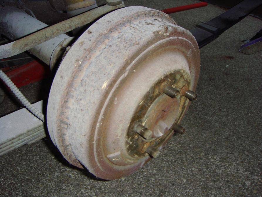

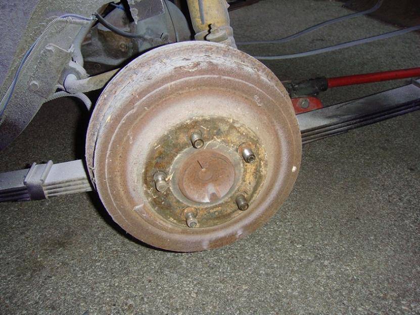

OK, all you brake geniues...
These are pictures of one of the rear drums on my BS23N1B 1971 'Cuda. What size are they?
The fronts are factory disc brakes.

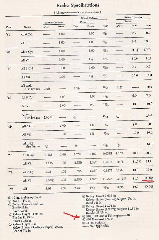

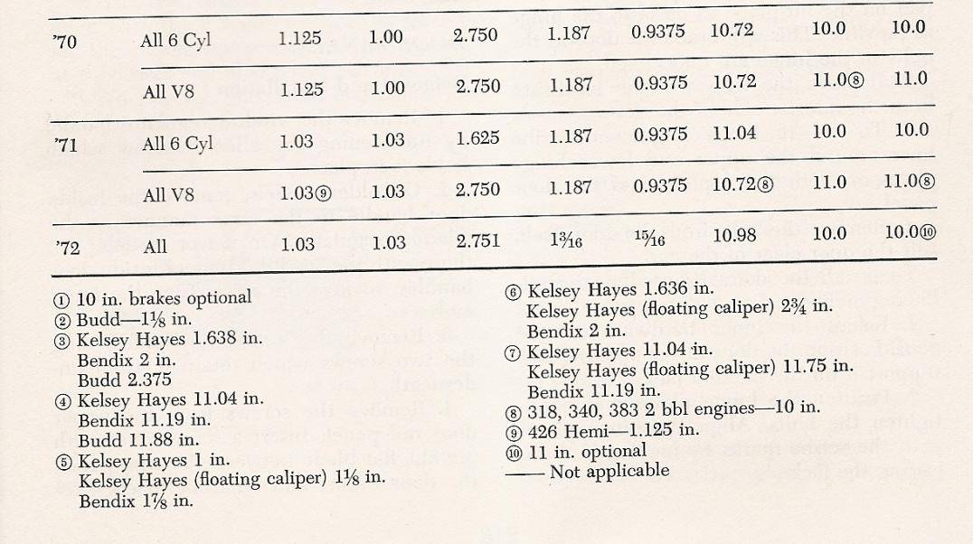

1971 BS23N1B 'Cuda
OK, this is out of a Chilton's repair and tune up guide for Barracuda Challenger 1965-72. It has a copyright date of 1972. I have the 16th printing dated January 1988. This book seems to show 11 inch rear drums for 383-4 engines and larger and 10 inch rear drums for 383-2 and smaller. Correct me if I am wrong, or this book.
My car is a factory 383-4 with front disc brakes. My rear brakes look like 10 inch drums. I am confused.

typically front disc had 10" rear drums which is what those appear to be . the 4 wheel drum cars often had 11x 2.5 rear drum brakes
