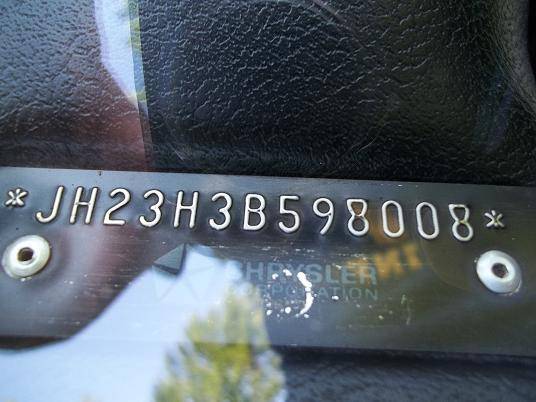

Matter of fact, I will check my 73 challenger to see if it has that code. The VIN sequence on that car is JH23G3B------ but it has a ralley dash, disk brakes front, 8.3/4 axle rear.

Here's the Challenger code.
Well, that pretty much spells it out. I see you guys are on the ball here. I'm impressed. Thanks for the info. Goes to show an old dog can learn or re-learn a thing or two! :sign13:

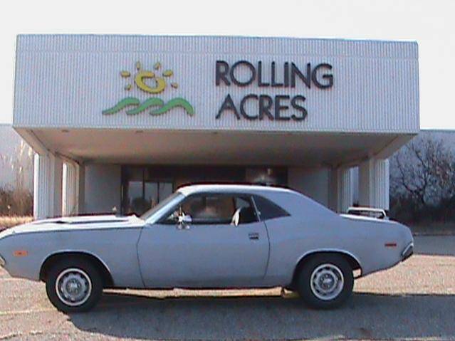

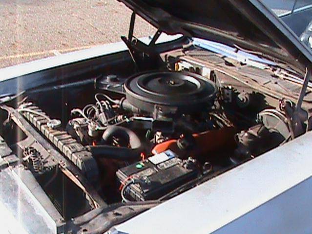

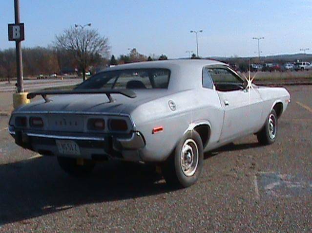

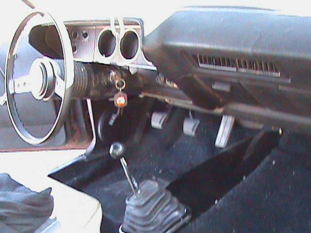

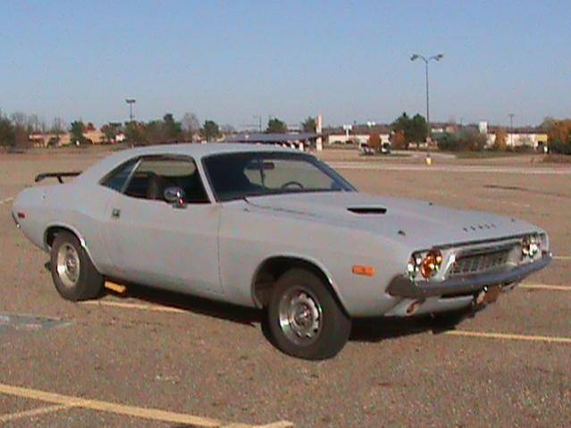

The pictures I posted above were taken today 11-12-11
The car in the pictures above is a 73 Challenger with bumper mods and 73 440 (cast crank) with 11'' flywheel and cast iron 11'' bell housing with overdrive 4 speed and 4.11 gears. Motor is bone stock (internally) fresh from a motor home.
I just did the body work on this car last summer but ran out of time before I could paint it. I took it down to bare metal, Gave it a etching primer coat or two, then did the plastic work, then gave it a 1k primer coat for now. This car features all original sheet metal and floor and trunk pans although some repairs were done to the panels.
