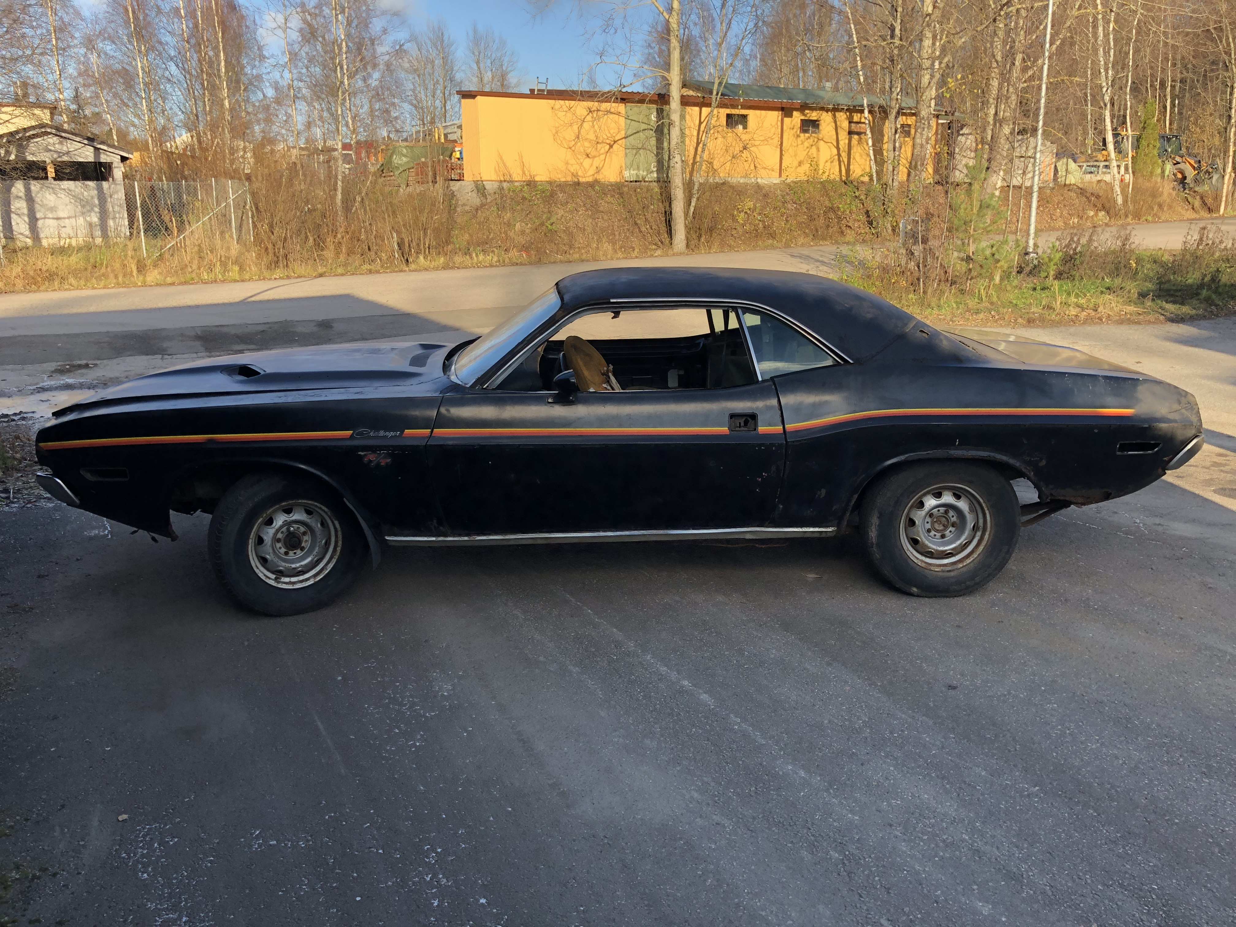

Thats the car, i think when it came to Finland. I try to get pictures on the floors later.
