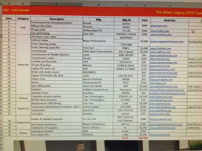

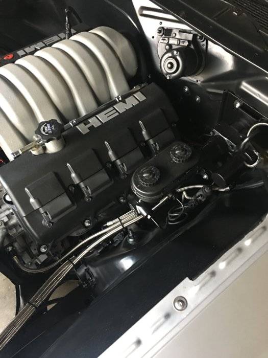

Here is what you need. My hydroboost comes next weeki believe. I'll let you knowhow she fits. I can not get power assist with the MBM booster and all.
The photo shows everything I've done with the 6.4 install. You can PM me for comments. There is a lot of fine tuning required to get the beast to plop in place. Or call me. 7345453794 and I can walk you through it. Peter
