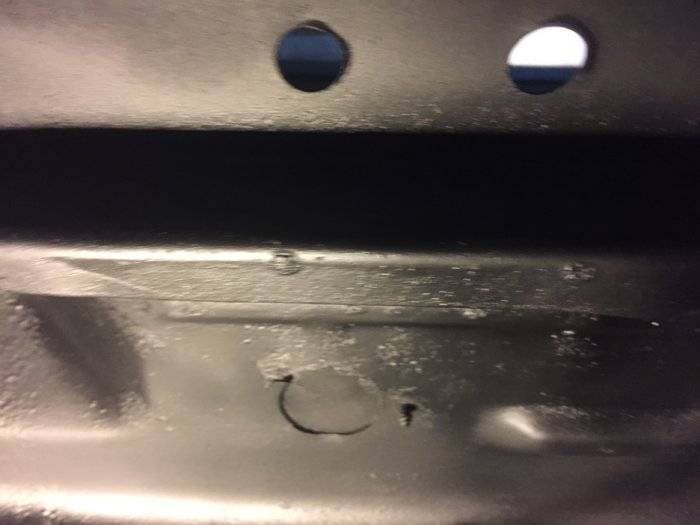

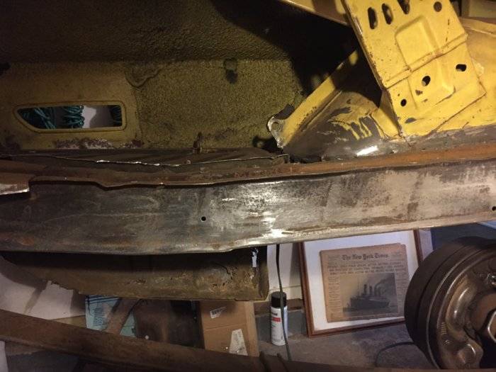

Cleaning up the underside/back section of the rear floor pan. Not too bad overall. Will need a small patch on the left side bottom, otherwise everything is pretty solid.
I remove what I can mechanically then use Eastwood's Rust Converter followed by Rust Encapsulator, then a good coat of chassis paint.
You can tell the rust in the small area started from the INSIDE!

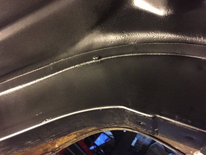

Finally finished cleaning up the under side rear floor pan and shock cross member before I start the install on the new trunk floor.
Cleaned up with wire wheels, rust converter and rust sealer. Think it came out pretty good!

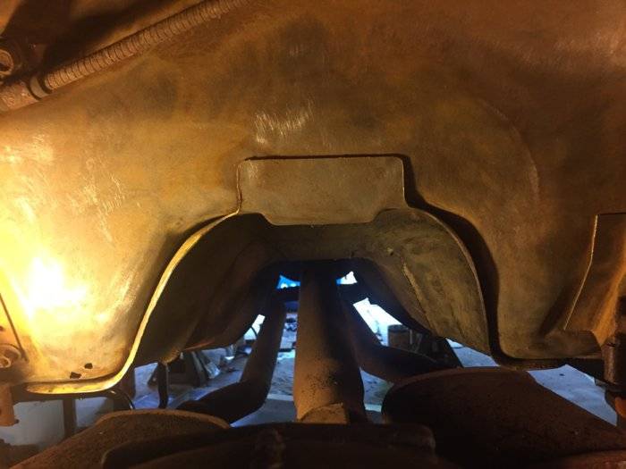

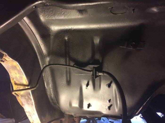

What I did so far on the underside;
Applied Rust Converter first on underbody areas (after cleaning up with wire wheels and orbital sanders)
Coated with Rust Encapsulator (both Eastwood products; have had good success with these)
Really looking to prevent any further rust from forming.
When I worked on other areas of the car (inner fenders, front frame, engine compartment) I followed up with:
Sealed and coated with epoxy primer, two-three coats, sanded between coats.
Added high build urethane primer, sanded then again resealed with the epoxy.
Final top coat could be whatever chosen (chassis paint, factory Y-1)
I usually try to keep a car as stock as possible (just my preference) with minor modifications for improvement or durability.
What I have right now are the remnants of the factory primer on the underside with no undercoating except in the wheel well areas (as per factory)
My thinking is that I can future finish the underside in any number of ways post this point?
Just my thoughts!

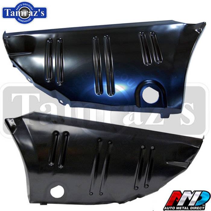

Just ordered the AMD trunk floor extensions. Figured it is best to replace them rather then trying to patch up the old ones which are marginal.
Stuff is getting expensive but wanted to use the matching AMD metal.
