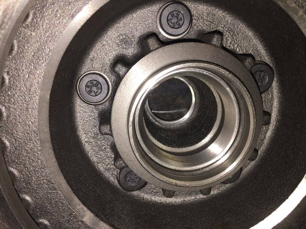

As I disassemble the car, parts go in to bags, had to find parts and check the bag
The spacer was part of the L shaped corner piece, it slips into the folded edge on the back
When I removed the rt side, the spacer stayed on the car, the hole was covered up by the chaulking.
The driver's side corner piece: the bracket stayed on the back

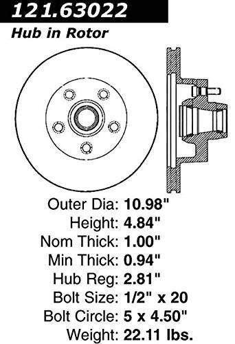

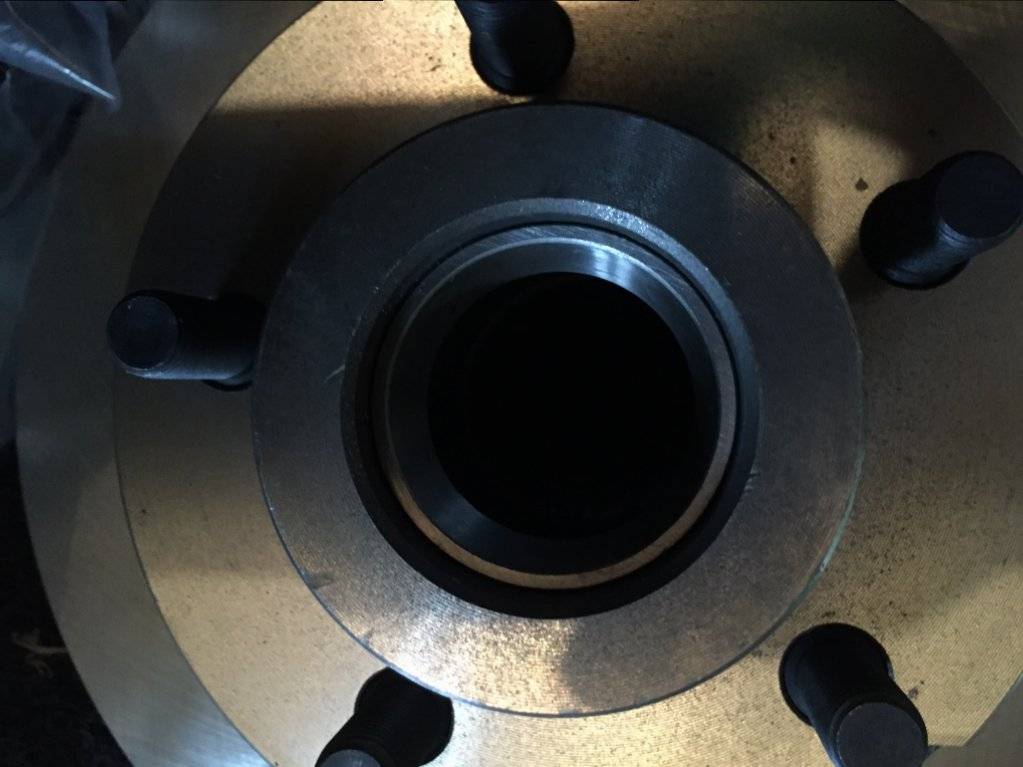

The Centric Rotors come with the bearing races, but they come with the rt hand thread only. They are also one piece rotors (original rotors were 2 piece)
Additionally, these fit with the smaller size wheel bearing and smaller size disc brake spindle that was used for my 1970 Challenger with factory disc.
I wanted to reuse my original spindles so these were fine for me. The two piece rotors are just not available new anywhere.
I attached the technical picture and specs. I will try to get an actual picture of the rotors for you. Have not installed them yet.
I bought them on a recommendation from a senior member here. I'm happy with the purchase.

Thanks for the reply. I have seen the Centric diagrams. I have never seen the actual rotor. That is why I have not ordered them yet. Whenever they are listed for sale on a website, the photo is of a hubless rotor, but the diagram shows the hub with stud. That is what gives me doubts of what you get. This will be for a 70 Cuda, so yes, I have purchased the correct bearings for a 1970. The Raybestos are still out there, but at $150 ea, is getting ridiculous. I thought about getting the later rotors and just getting the spindle sleeve so it will work with our existing spindles. But if Centric is a good option w/o getting those spindle sleeves, then I will get them.

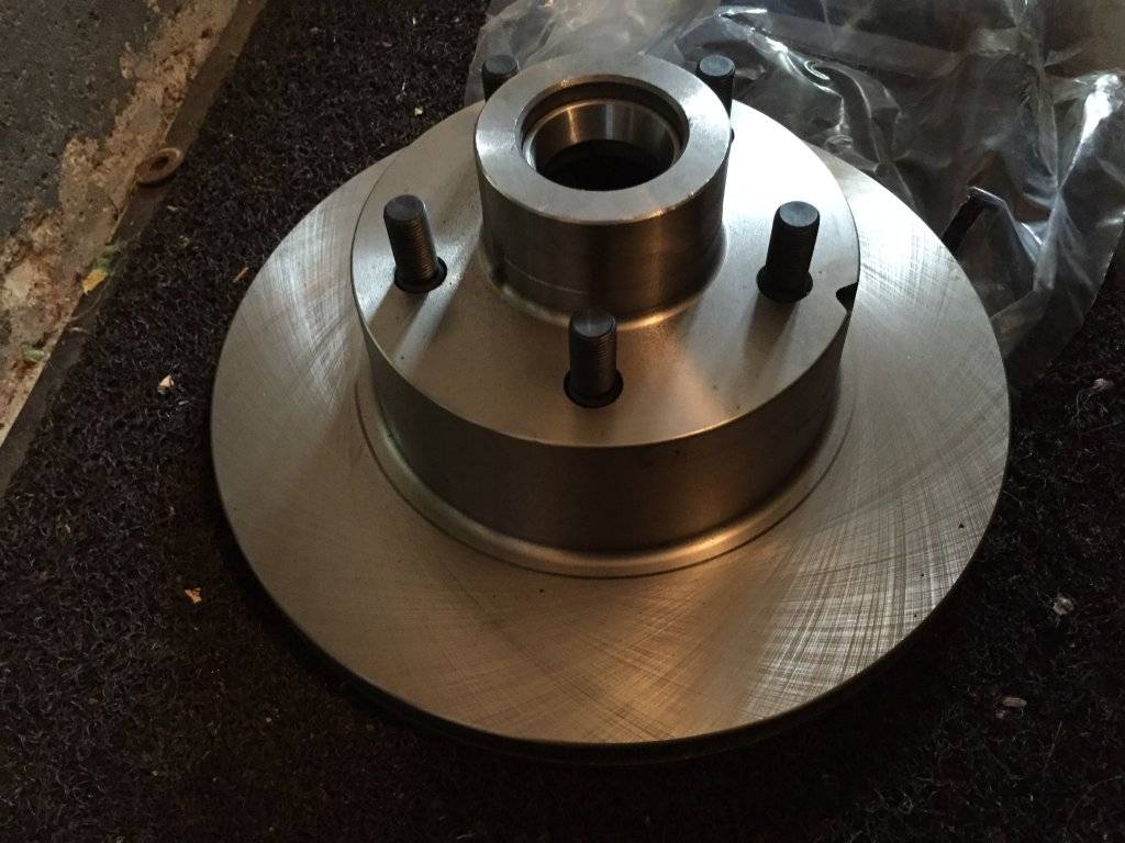

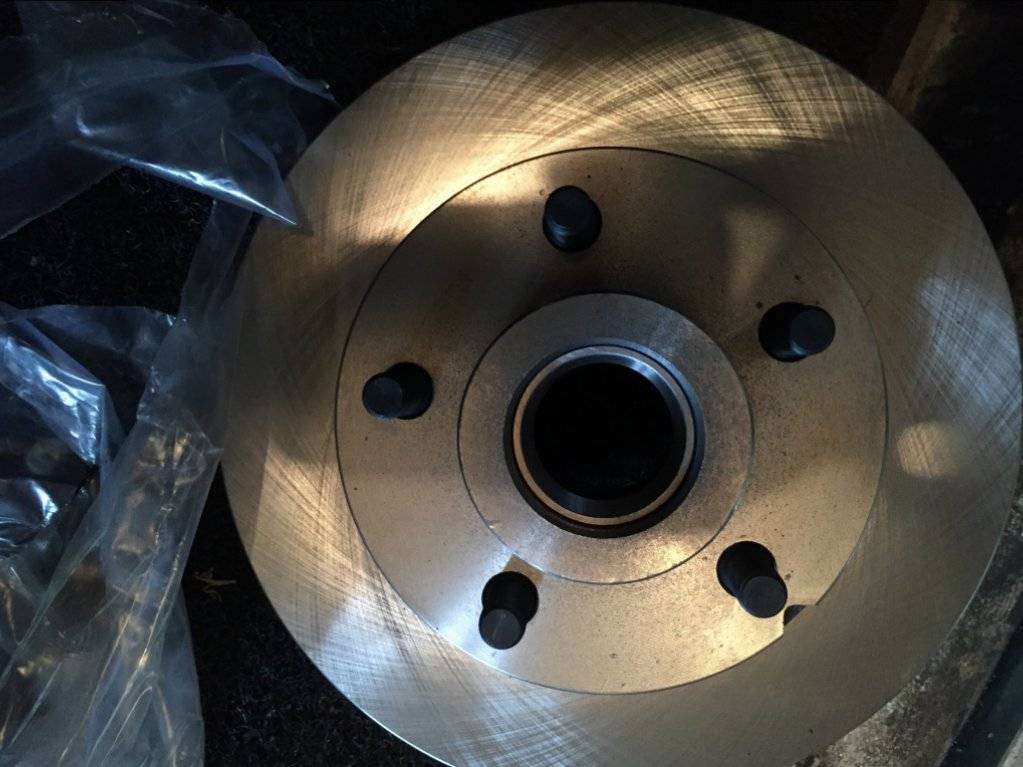

Pictures of the Centric Rotor
Well made unit, note the reinforcing ribs on the back
Paid 142 each last fall.
Good luck with your choice.

Just a thought, I looked at the sleeves in using the larger rotor/bearing size.
Some feedback I got from others recommended not using the sleeves, and that it was better to upgrade to the larger 1973 spindle
So I went with the Centric Units.

Big thanks for the pics. Now I can order them. Sorry to say, but they are now $55 ea at Rockauto. Part# 121.63022

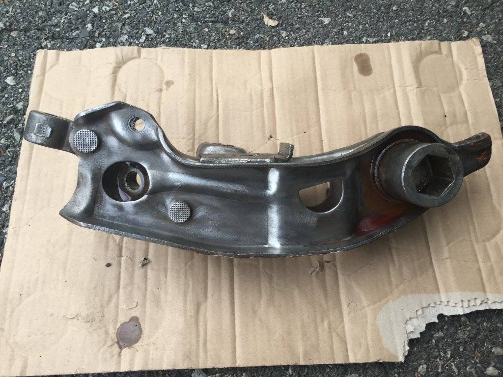

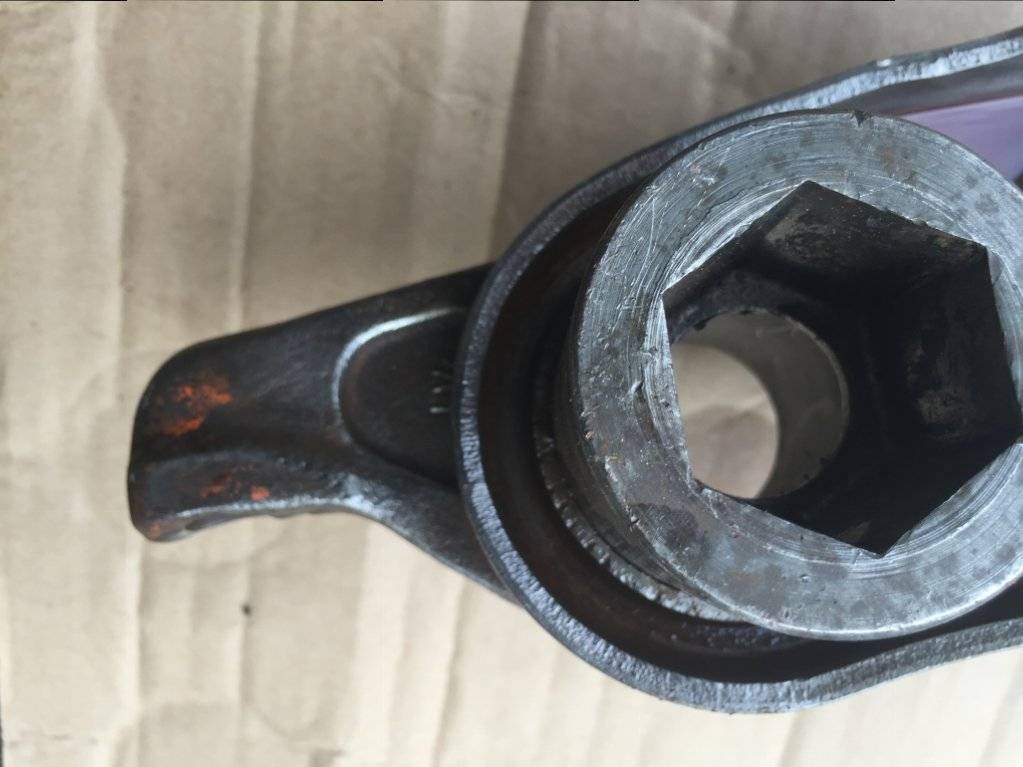

Final clean up of the lower control arm before pressing in the new bushing and pivot shaft
Still have to remove the outer shell; bought the American Muscle tools- this should help
Had to grind off the old bumper stop and use a chisel.
You can still see the orange factory paint on the extension arm and what is left of the organosol dip line
