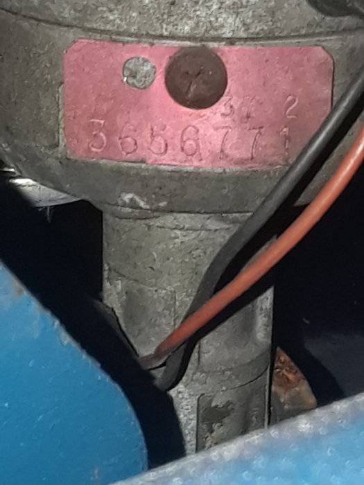

Post the tag number on the distributor, and also check that the mechanical and vac advance is working. To check the mechanical just take the cap off and make sure the rotor can turn a bit somewhat freely a bit, they seize pretty easy if they have not been oiled over the years. Makes a world of difference also the curve should be different than stock as noted before.
Sparkey
Jul 21, 2018
60
6
Massachusetts
The tag number is: 37 2
3656771
The rotor does turn pretty freely and when I plugged the vacuum advance hose back on the carb the rpm's picked up so I think that means the vacuum advance is working.
When you say the curve should be different than stock does that mean timing degrees?
halifaxhop
Dec 14, 2017
661
167
Here is what you have 73 MT/AT Mech at the crank 17-27 @ 2000 rpm, vac @ 12.5 at the crank 14-20. Set it at factory should be close to what you want.
3656771
You have a cam so it changes things. That one should be pretty close if everything is working. Did you put a timing light on it with the vacuum advance hose off and did the timing advance to the factory specs at the Rpms?
