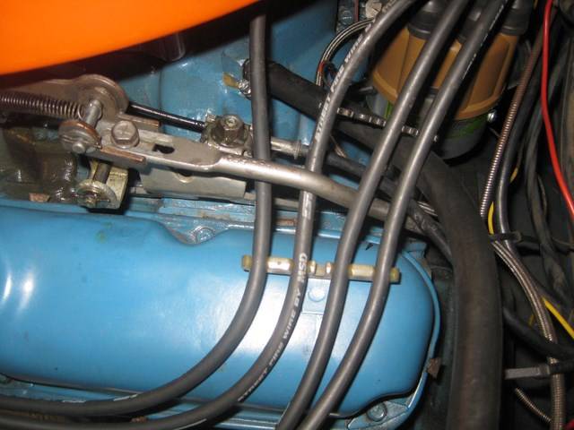

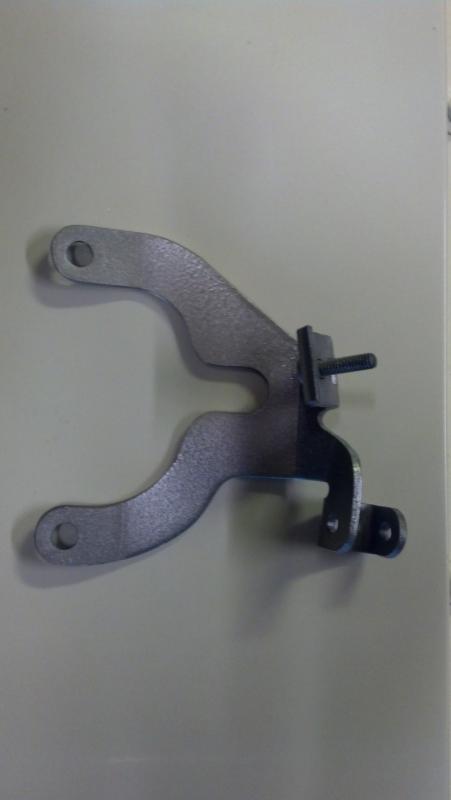

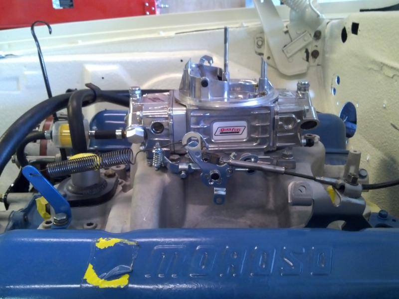

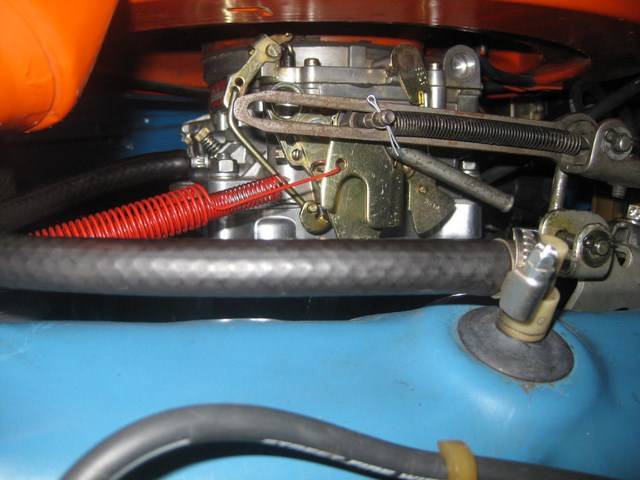

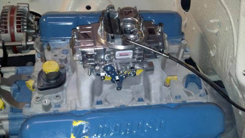

Paints done so now it's time to build. I'm going to have a lot of questions because when I purchased the car it came all apart in boxes and I was not the one that took it apart. Very little was tagged and in baggys. Could be a fun game. We can call it "Whats this part"? (lol) I purchased a Chassis service manual but it does not show everything.
I was wondering if someone had a nice picture of where my throttle cable bracket goes. I thought it went under a couple of intake manifold bolts but it did not line up. My intake manifold is an Edelbrck with a new Quick Fuel Slayer 4 barrel carburetor.

Hello Bill
Buderus is a famous company here in Germany. Well known !
About your bracket I can take a picture tomorrow... so you can seewhere the bracket goes to..

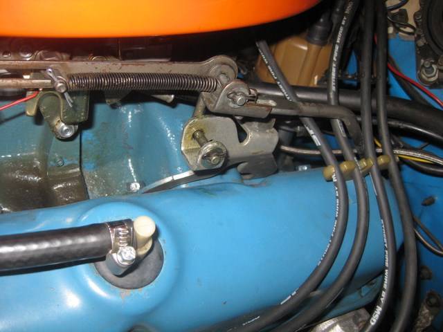

..here are some pics from my trotle bracket
the bracket goes to the 4 th and 5 th bolt ( viewed from the front of the engine ) .
Greetings Juergen

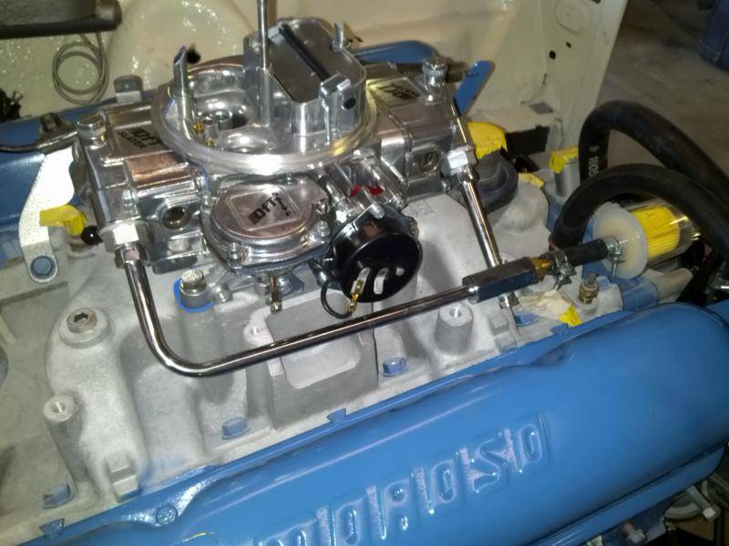

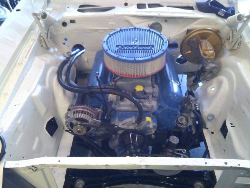

Thank you for the pictures!
I think I figured it out a few days ago.

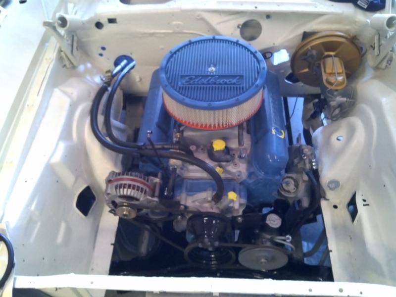

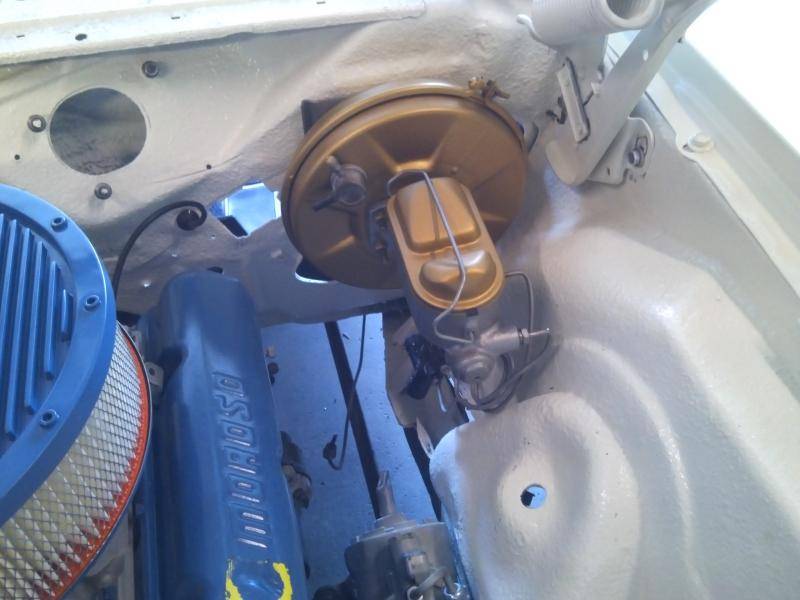

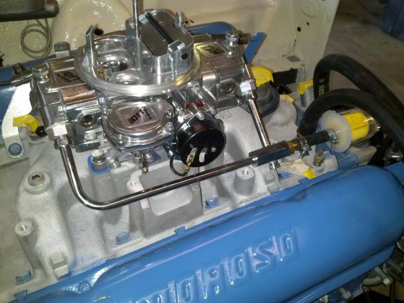

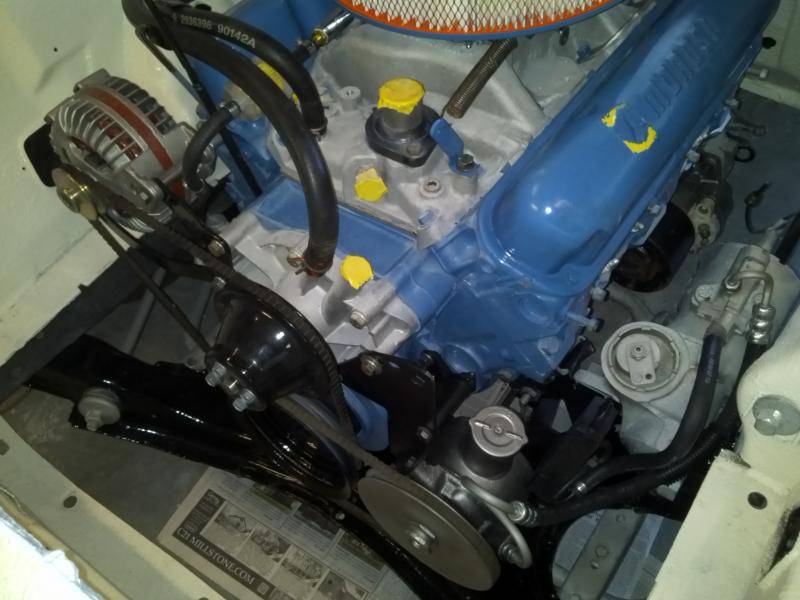

I got the power steering all hooked up and the gas line run to the carb.
With the aftermarket Edelbrack manifold I had to modify the throttle return spring bracket.
What do you think about the Mopar blue air filter cover?? I don't know if I like it or not?

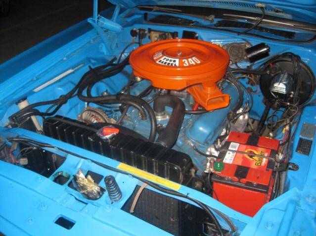

About the Airfilter.... I would go..and search for a 340 OEM Airfilter assy.... ( because your engine bay deserves it ! )

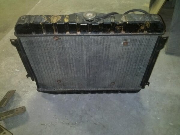

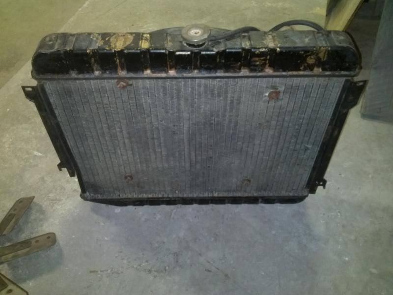

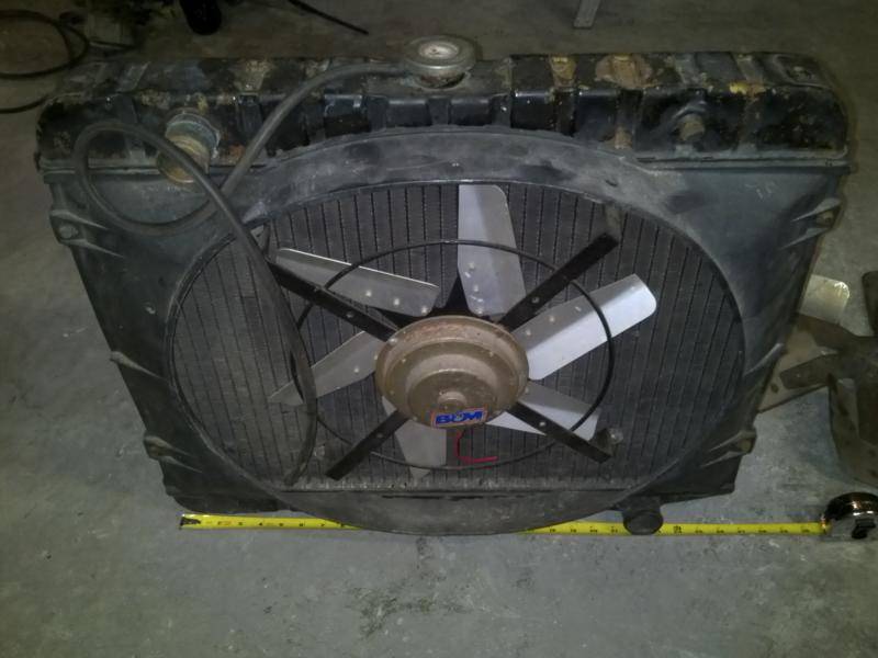

Thank you for that very helpful information! I think any cooling concerns would come from if my motor had been tinkered with to get more HP. The only thing that my motor has different from stock is a mild high performance cam so I'm hoping I will not have any issues with cooling especially since it's only a 340 and I have the larger 26" radiator. I had my old radiator pressurized and leak tested and it had leaks where the person who owned the car before me had mounted an electric fan to it. He mounted it by putting the 4 mounting bolts right through the radiator. The radiator shop fixed the leaks only to find more leaks. So I'm in the market for a new 26" radiator. The cost of a new radiator is 1/2 the price of having the old one re-cored. The leaking radiator was not original to the car anyway. The guy at the local radiator shop did not charge me to test it in exchange to let him keep the radiator for scrap metal. With a new "clean" motor, new "clean" radiator, new "clean" antifreeze and a new thermostat, I don't think I will have any problems with the original fan keeping things cool (especially in Vermont).

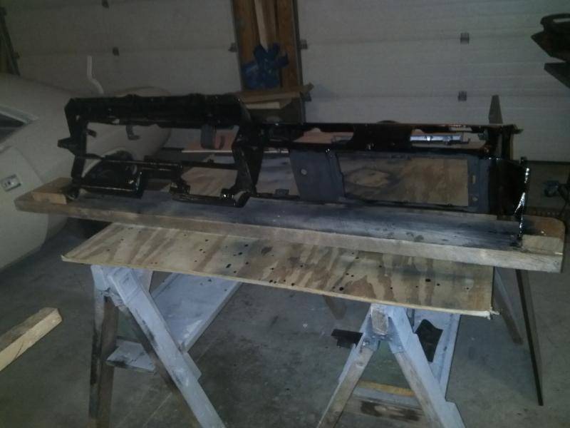

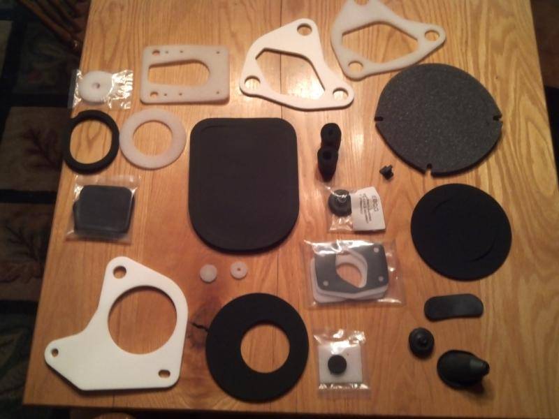

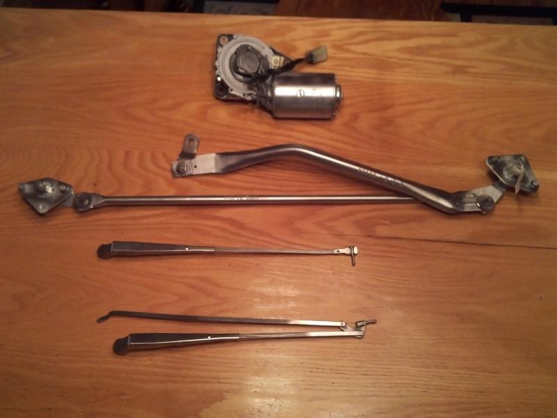

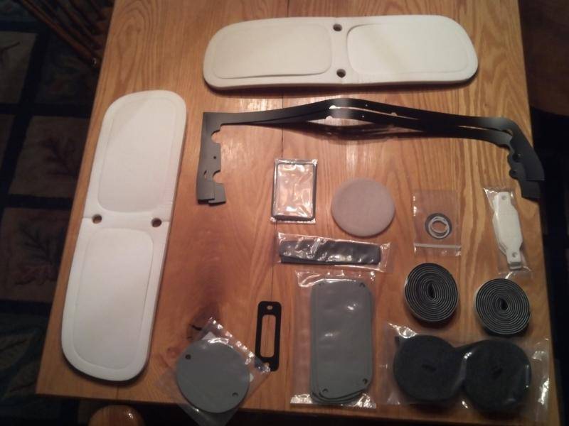

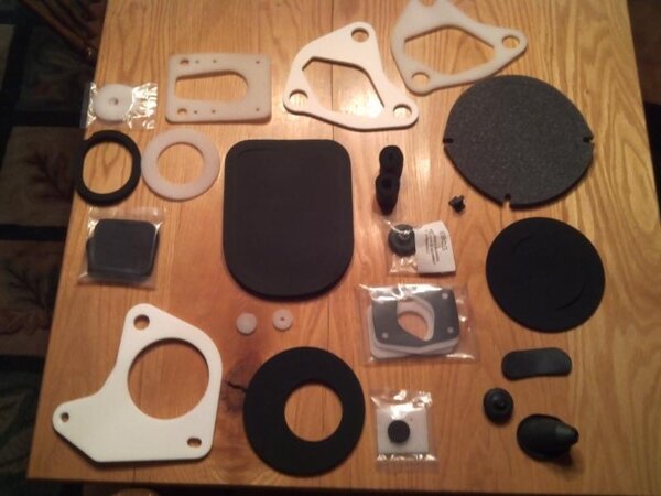

Not much to report. Got my Detroit Muscle firewall gasket kit and paint gasket kit. Cleaned up the windshield wiper transmission and motor. Have a clutch z-bar rebuild kit on order. Sandblasted and primed dash.
Any advise good or bad is greatly appreciated.
