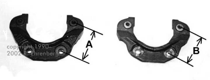

"The caliper adapters for the 11.75" rotors measures 3.5" (dim. “A”) from the center of the "pin" holes to the center of the mounting holes. The optional adapter (for 14" wheels/10.87" rotors) measures 3.125" C-C (Dim “B”)."

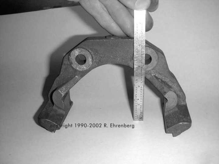

"Slider adapter are also made for each of the two rotor sizes. Measure from the center of the mounting hole to a flat surface. If it’s 3-1/4", it fits the small rotors, 3-5/8" fit the biggies."
