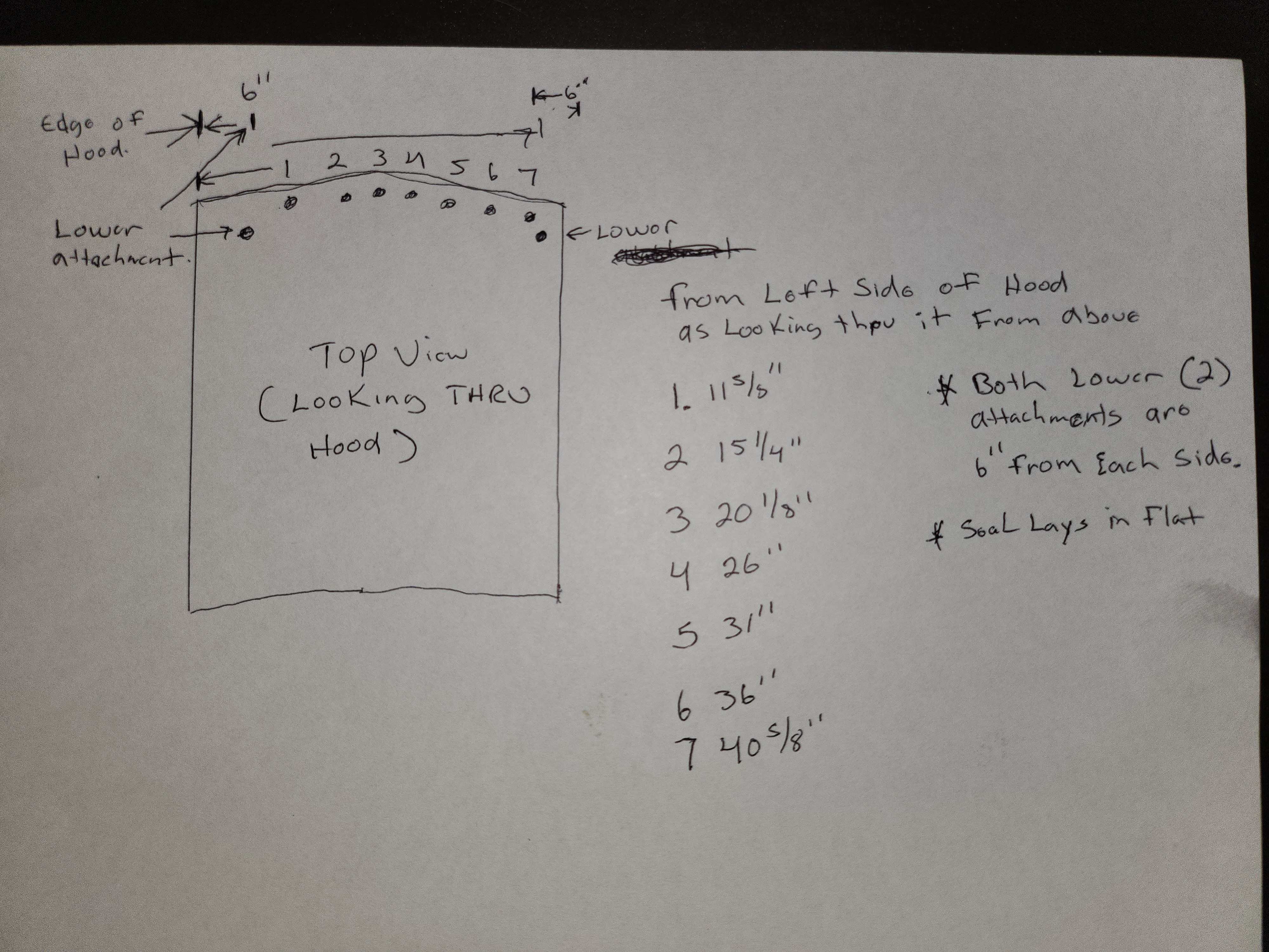

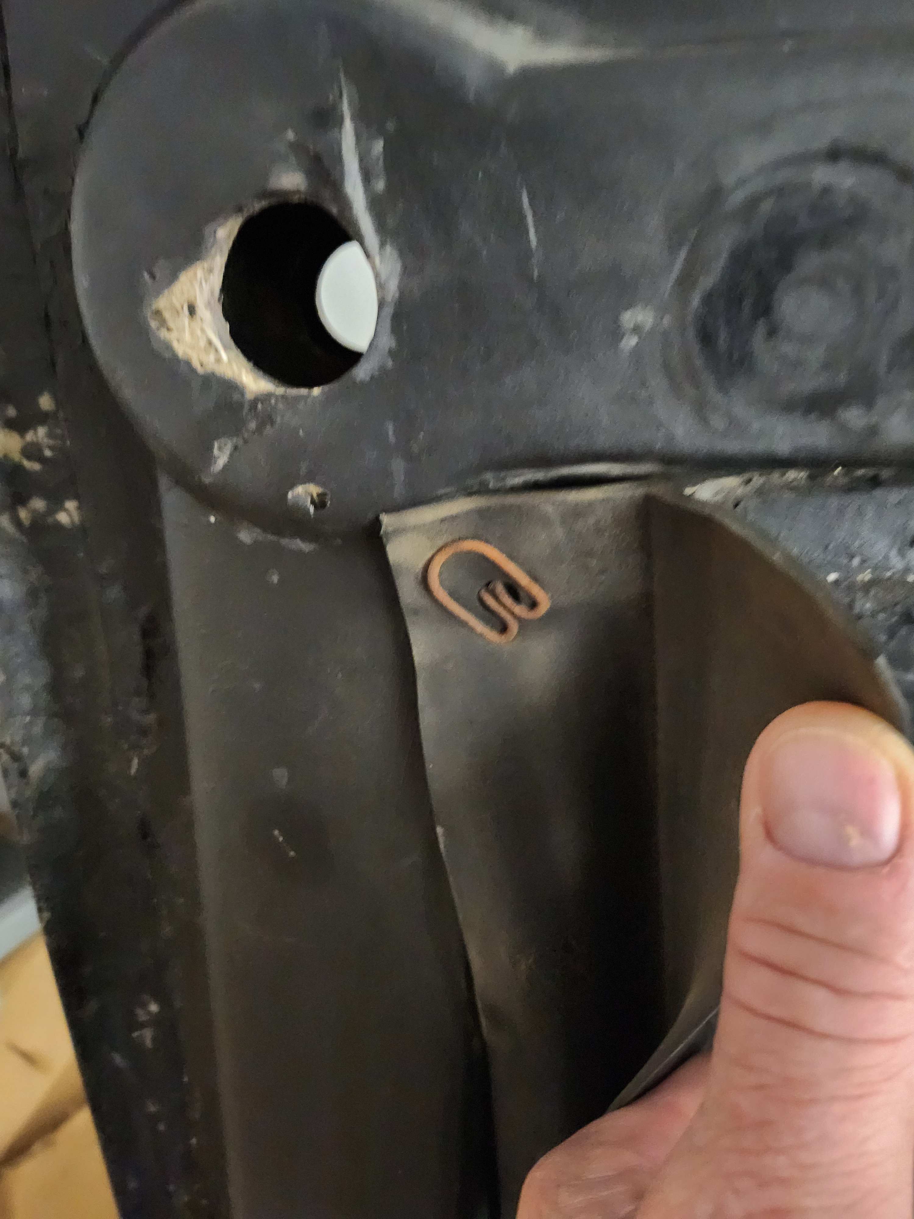

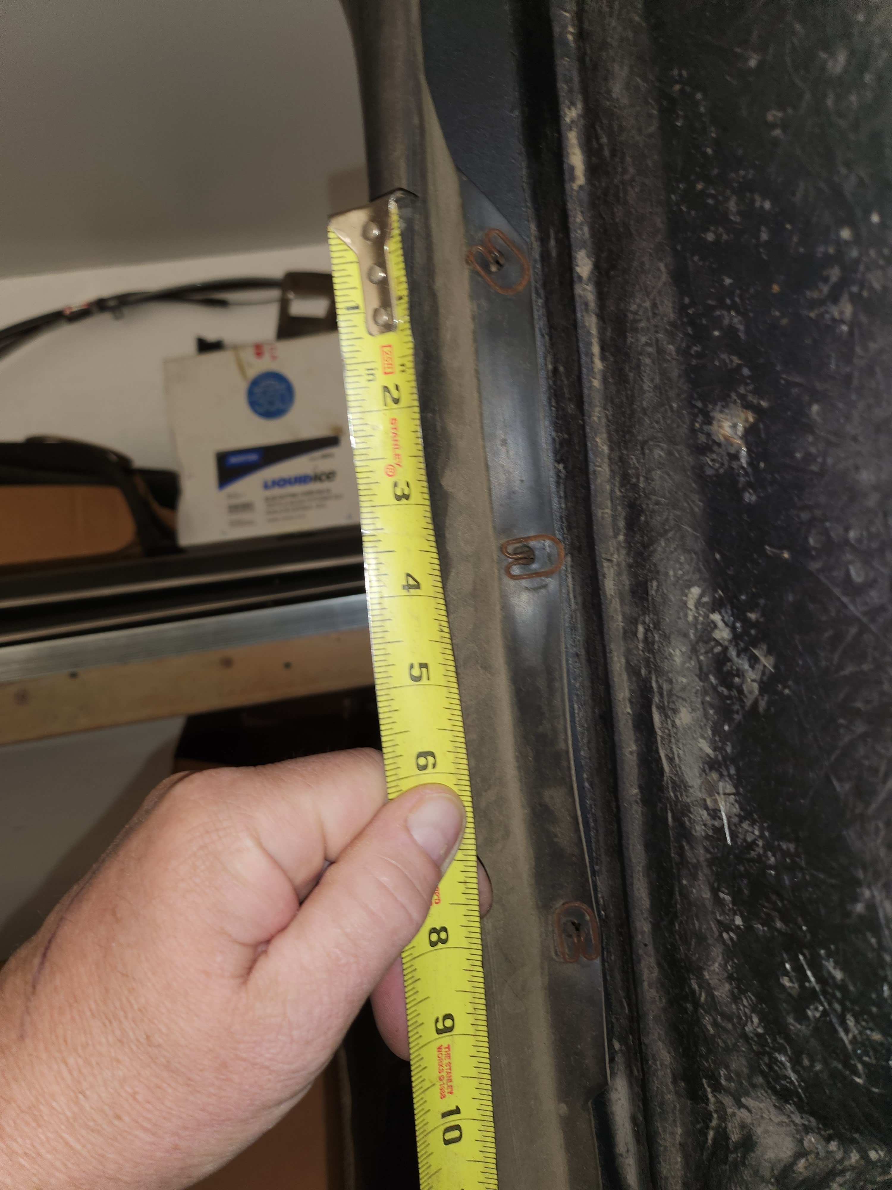

i have a pretty original FC7 it has that installed still, not 100% sure on that I'm sure someone here has one that is more documented than mine, and can verify. I can measure holes in the next couple days if necessary.

measurements are taken from left side of hood seal lays in channel except the 2 lower attachments, which are 6" from either side.

the lower attchments are actually upper on the other side of the other 7, but I think you should be good, centered and laying in the channel

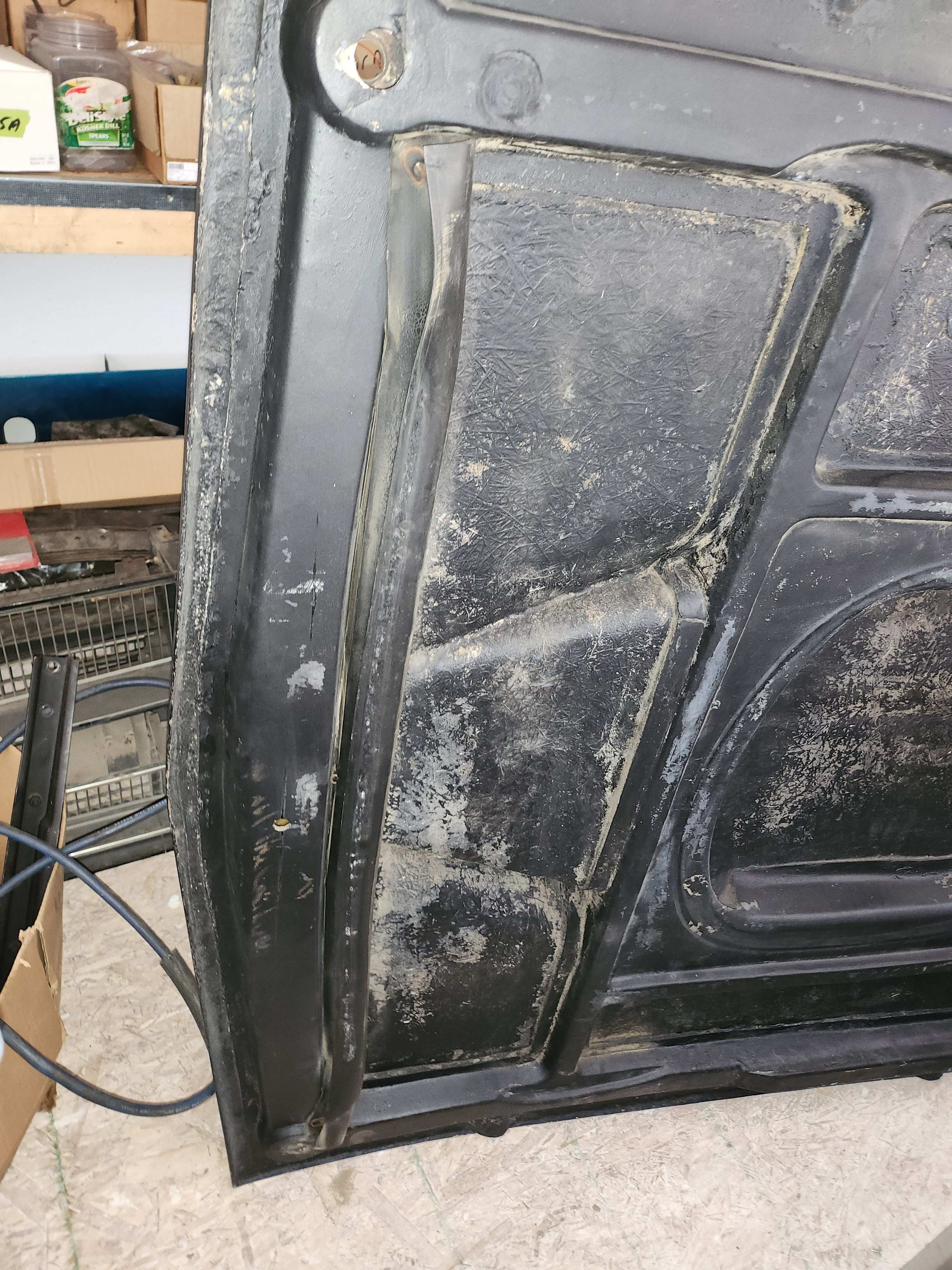

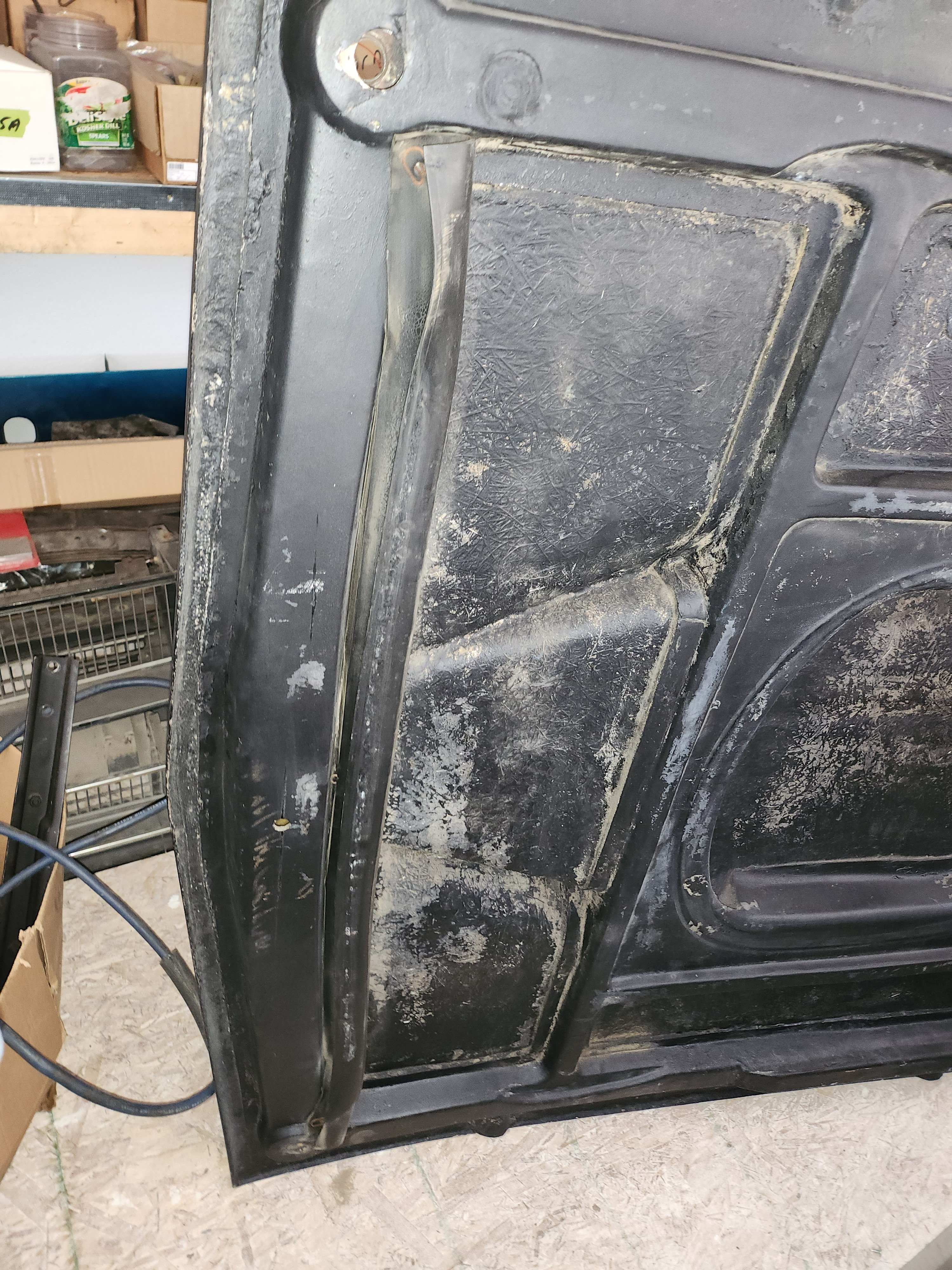

Could you give me one picture showing precisely where the seal lays/fastened to the hood?
