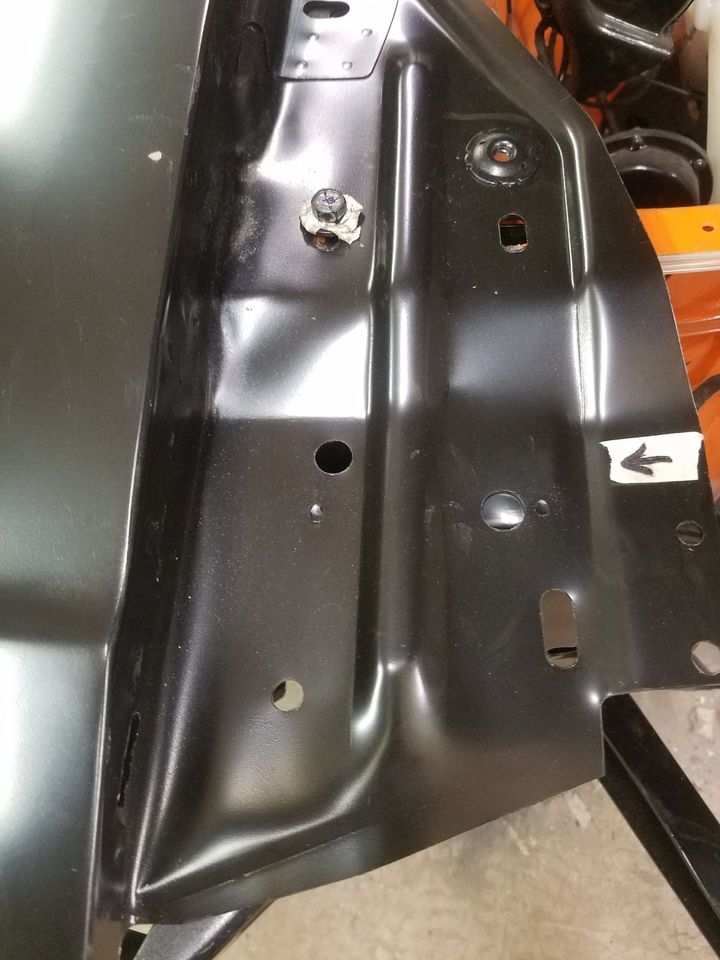

New AMD passengers fender 1970-71 Challenger, AMD told me "their all like that". Drivers side was fine

And ADM is most likely correct. Nothing better than OEM. But ADM is out best option now in most cases. Sigh!
