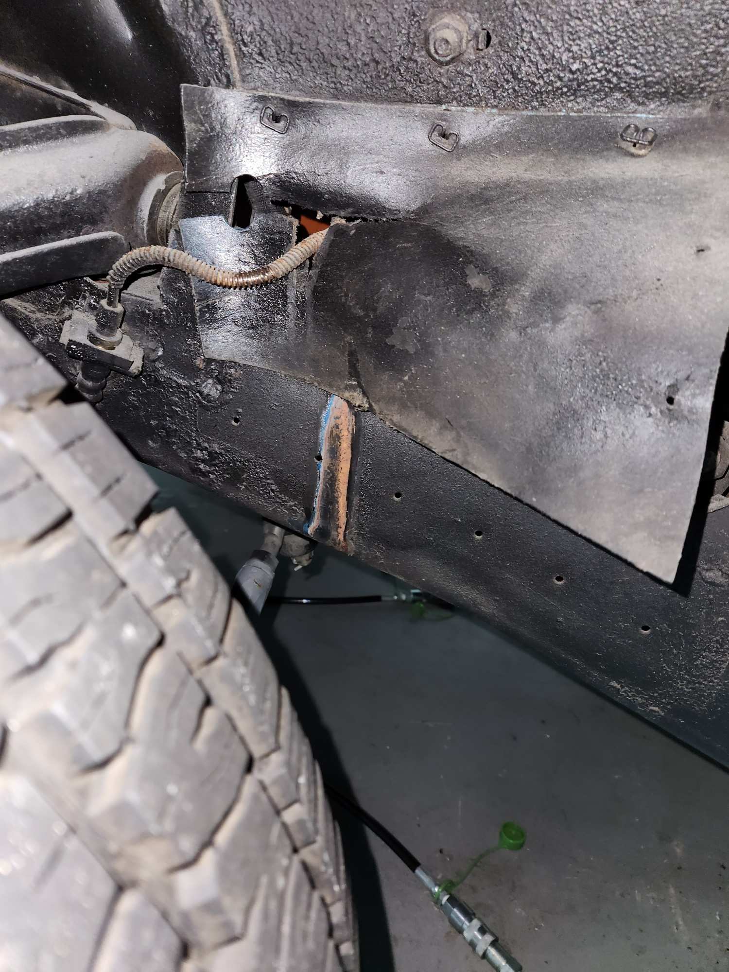

70 Cuda with p/s, firm feel steering box and fast ration pitman arm, 235/60 R15 on 7" rims. The inside of the tire hits the frame rail on full turns--both sides. Car was aligned and tracks straight. Is there any sort of stop that is supposed to be there to stop this or is something else going on?

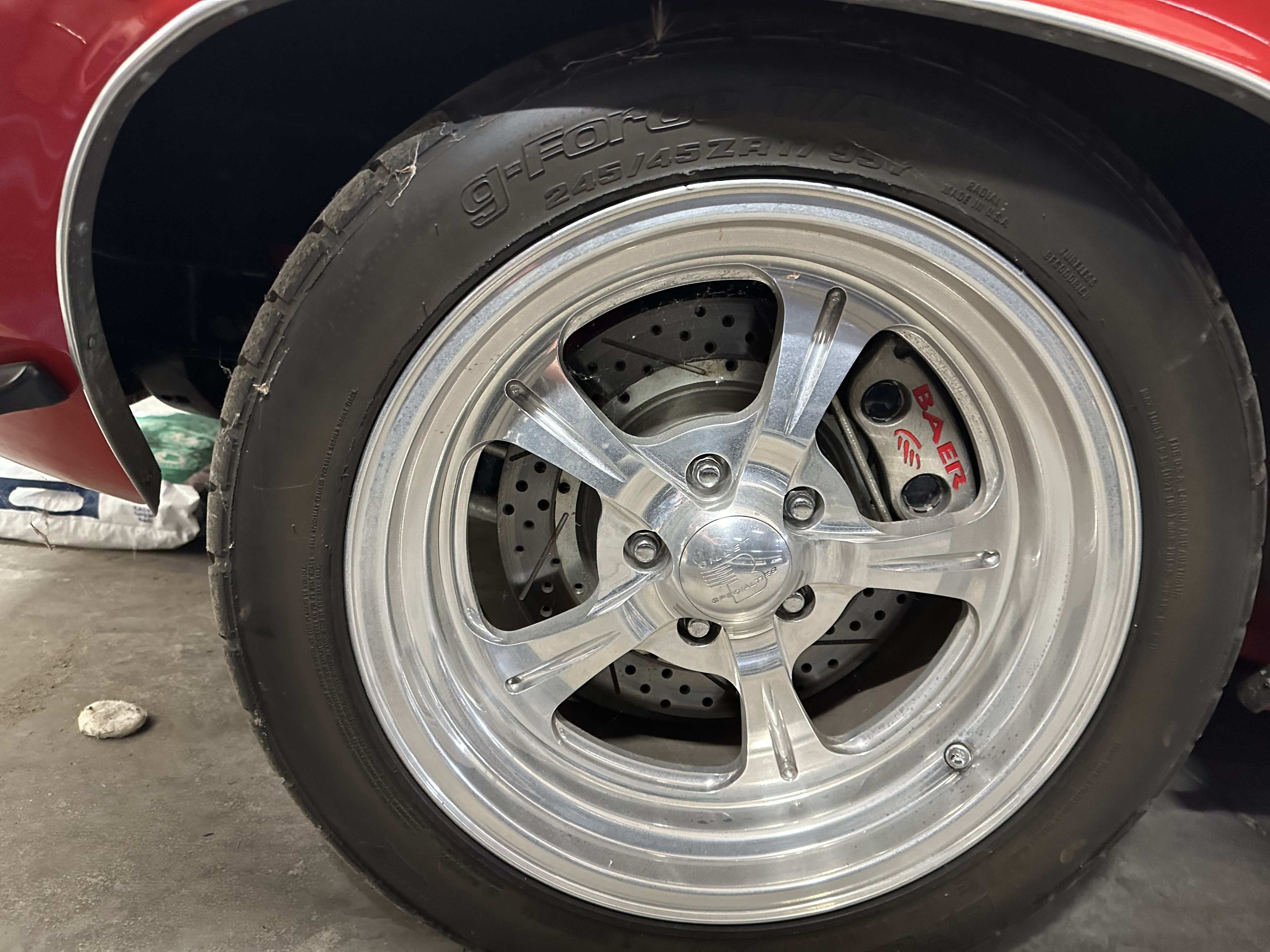

At first thought I would say you have too much tire, but I checked my 72 Barracuda and it has 245/45ZR17's and they don't rub.
It's possible the fast ratio pitman arm is your issue - I believe the fast ratio pitman arm is longer than stock so the same steering wheel movement will move the steering geometry further for the same amount of input - which will then move the tire further, which might be enough to make contact when using your slightly taller tire...
FYI- I have found tires sizes to be slightly different from one manufacturer to another, which may add to your rubbing issue.
My 17" rims are custom offset to try to maximize the tire size for that rim while also fitting around the brakes and in the fender wheel opening - If I remember right they are 17 x 9 with 1 in negative offset. (Neg offset pushes the rim and tire outboard)
You might try a 1/2 -3/4 wheel spacer to see if that solves the rubbing issue. Not saying to keep it, but it would tell you if a different offset (different wheel) would fit and not rub. I am pretty sure the 1/2 to 3/4 in change wouldnt rub on the fender, but you should verify that if you give that a try... wheel spacers are fairly inexpensive. Also Keep in mind wheel lug thread engagement if you try a spacer.

I have 245/45/17 (same as above) on 8" rim with 4-1/2" backspacing. Fast ratio steering. And a firm feel steering box. No issues or rubbing.

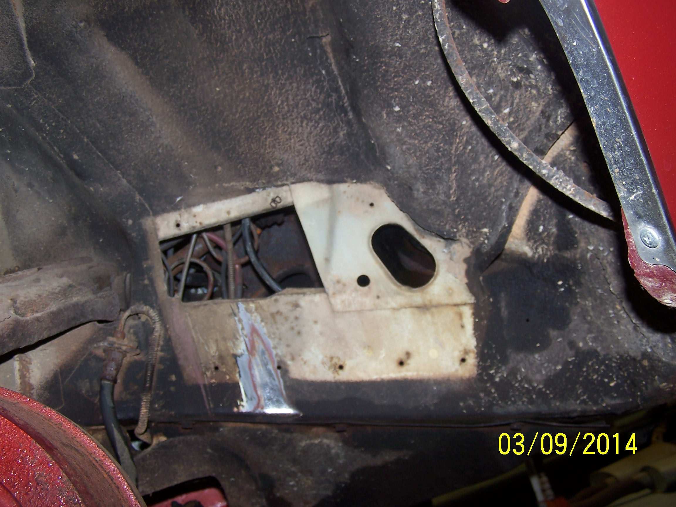

I know what you mean but I don't know how to fix it. When I bought my 68 Charger back in 2014 I noticed it had the same issue on both front wheels. It had the original components and 14" magnum wheels. I have no idea how I fixed it but I rebuilt the front end parts, swapped the 14" wheels to 15" wheels. Upgraded to front disc brakes and swapped in a Borgeson steering box. I never really thought about it again but I have no rubbing now so I have no fix for you.
Here is a pic of mine back then. Looks like yours only worse. Good luck figuring it out. Hopefully it won't cost as much as my resto did.

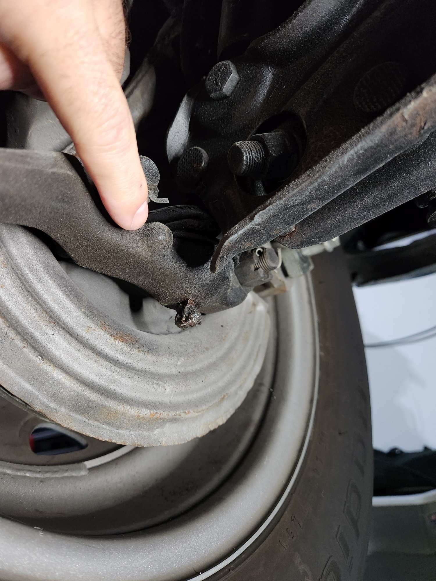

I checked out the lower ball joints and found that do have the bump stop....kind of disappointed since that could have been the issue.....

There could be a difference between the regular lower ball joints and the ball joints used on the fast ratio e-bodies. Perhaps someone else knows for sure.

Are you talking about the stops built into the lower ball joints?? I checked and my ball joints have them....see the picture a few posts up.
