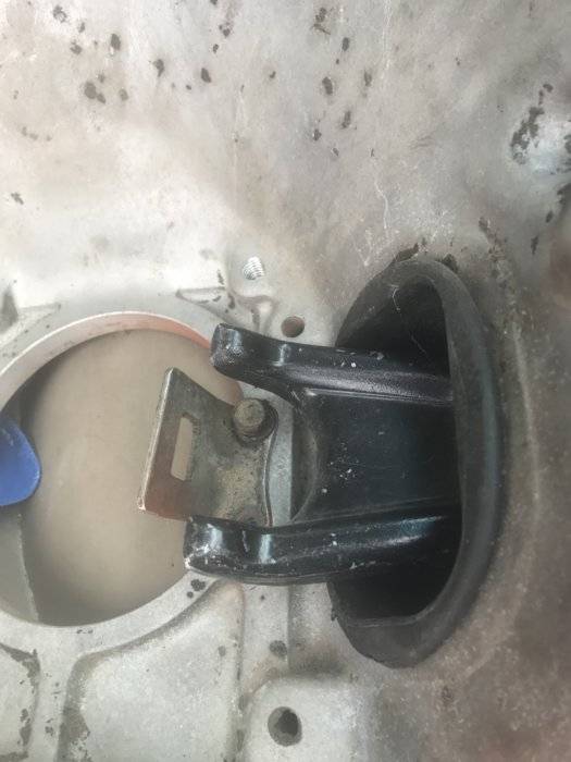

Does anyone have a picture they can post of the clutch fork pivot? I think mine is missing???

There is one pivot ball on the bell housing and one on the frame rail and it should be Perpendicular to the frame and the bell housing.

There's a tongue on the fork and a receptor in the bell housing that holds the fork. The tongue on the fork is about 1/2 wide and about 2" long and sits in the metal receptor that's bolted in the bell housing. So it's not really a pivot ball, just a pivot point. I hope this clears that up.

Here's a pic from the service manual.

Gracias Tony, thats what I'm missing..... thank god for this forum, I am so grateful for everyone's help. Brian

Thanks Lee,,,,,,I do have it but failed to find that pivot metal piece....better get my eye glasses changed
