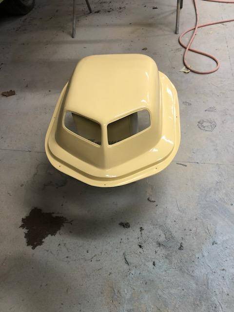

Finally getting some progress done on the super shaker. I have to do some final mounting steps. Quick release Dzus fasteners for scoop removal. Then it's off to paint, satin black for the scoop and blue for the hood

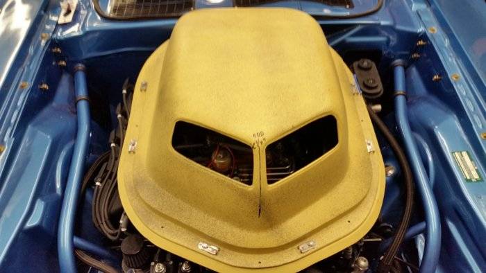

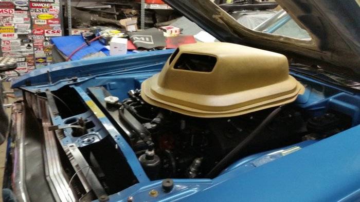

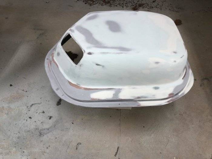

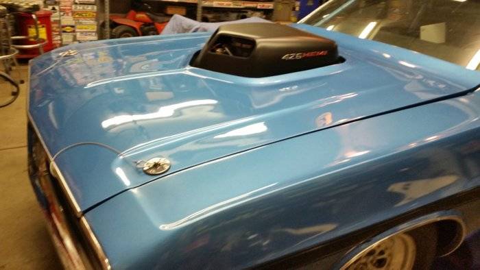

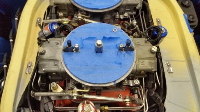

Mocked it up on the car this weekend for final mounting before final paint. I like it.

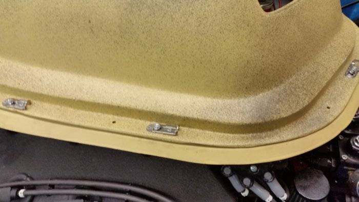

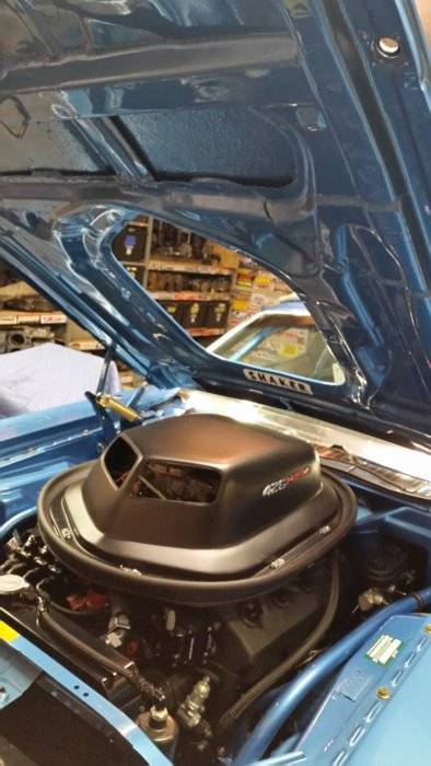

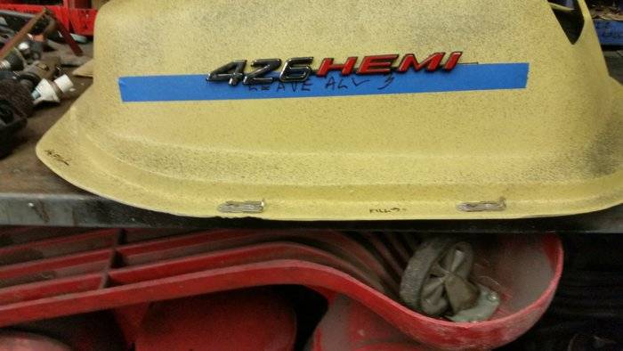

I fabbed up some tubular valve cover rails with support plates to be able to use Dzus slide lock fasteners. The base clips and locks to the mounts the scoop clips and locks to the base. All goes on and can be removed in 10 seconds for servicing or at the cruise nights.

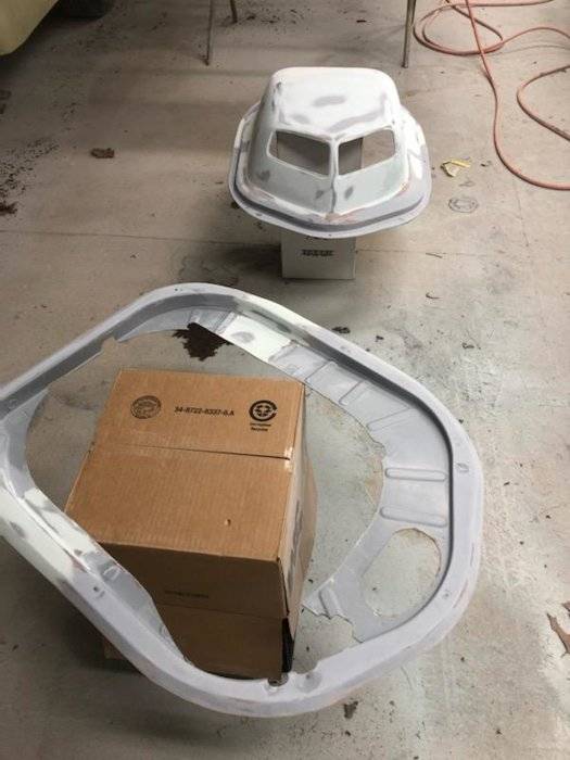

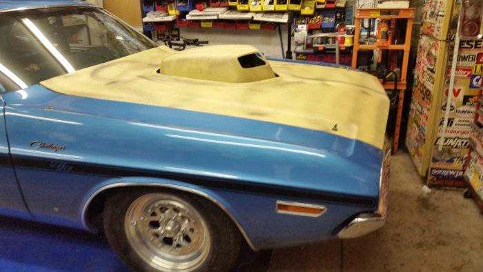

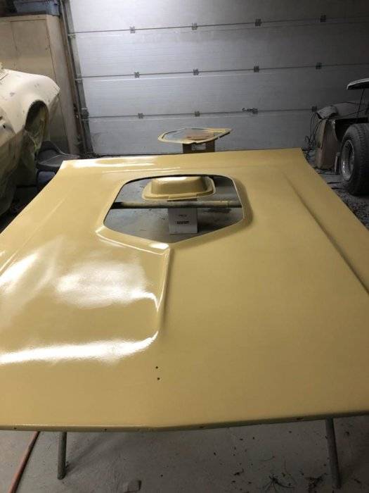

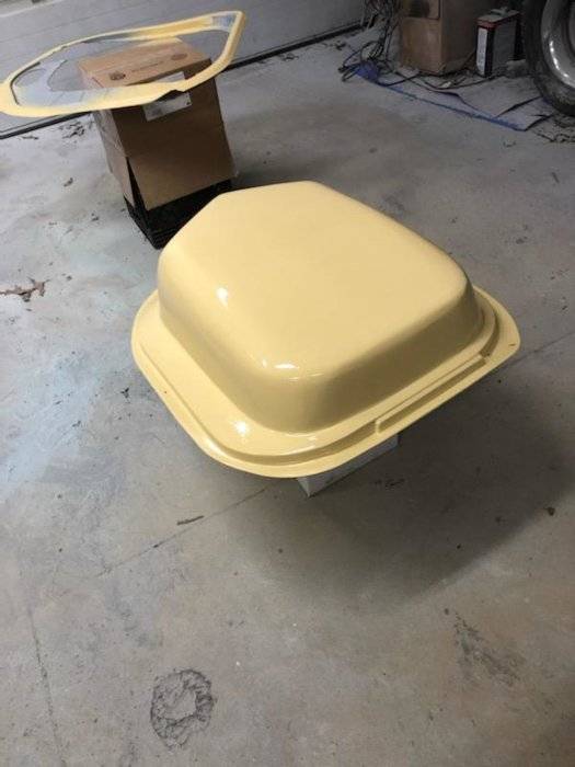

We were able to get the bottom side of the hood, bubble and base painted today. Top side of the hood will be next weekend.

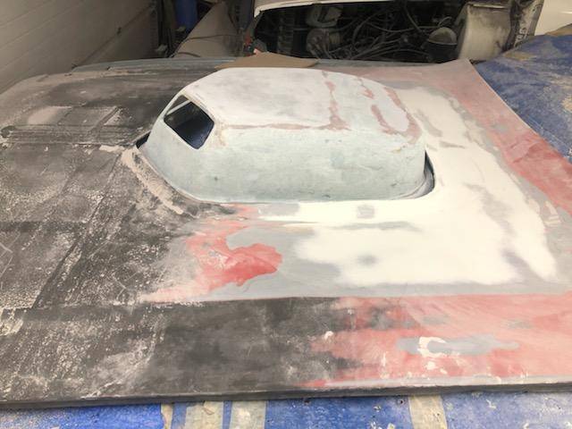

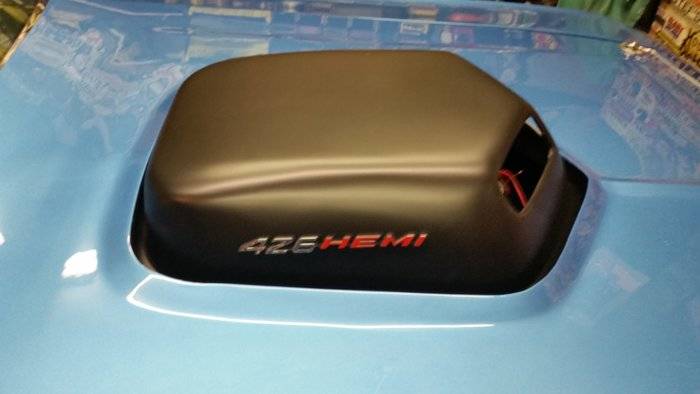

I got the scoop all mounted up. Can't wait to get the hood back home and on the car on Sunday.

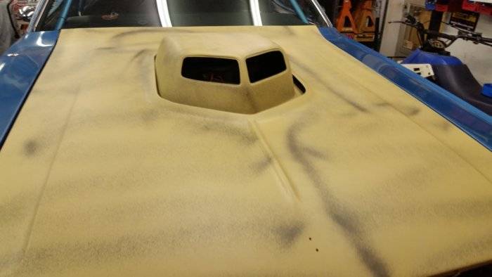

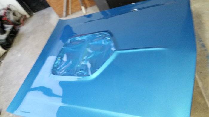

Top side of hood painted today. Need to color sand and rub it out tomorrow.
