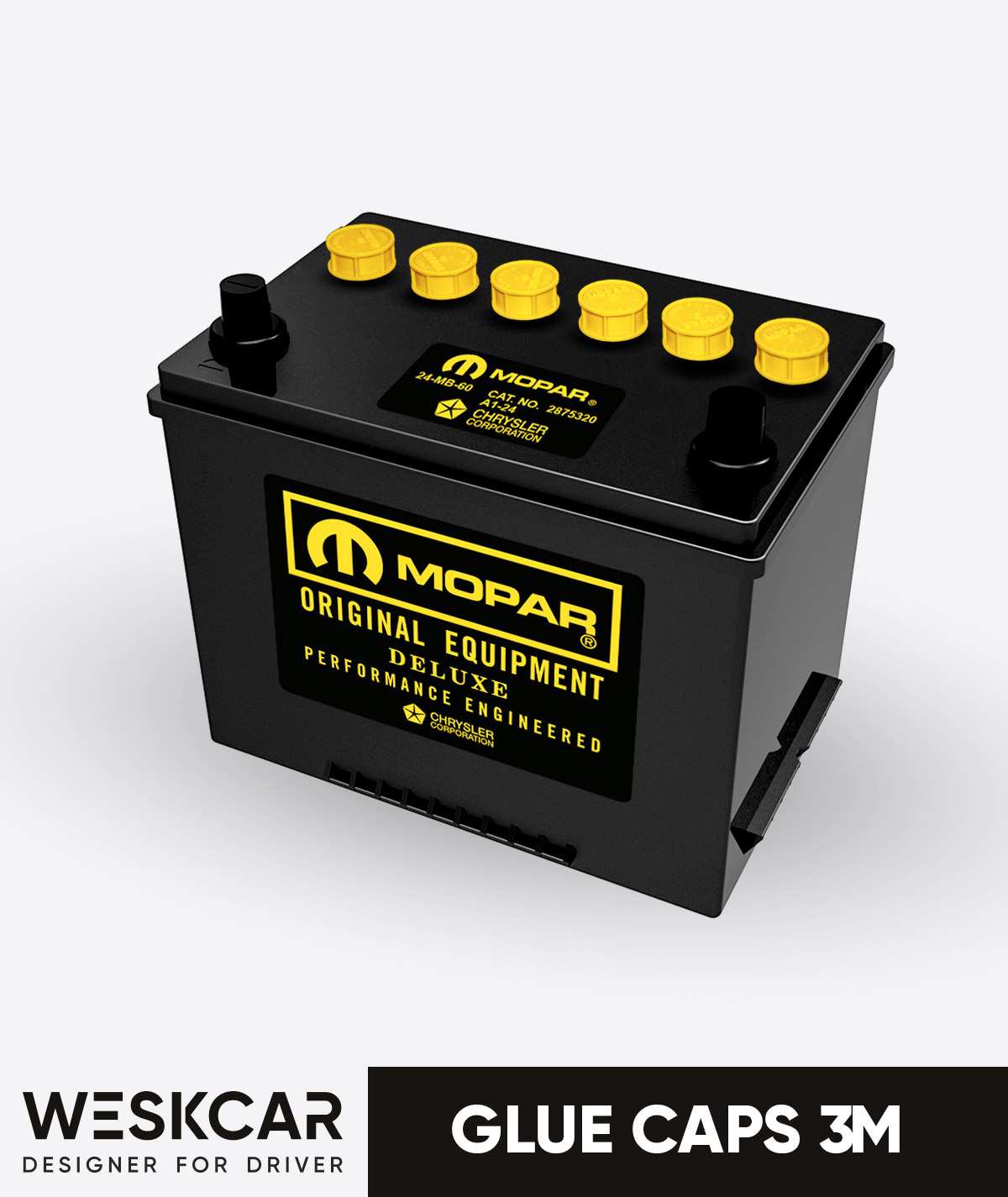

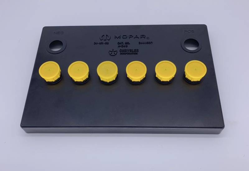

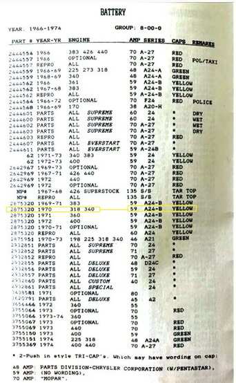

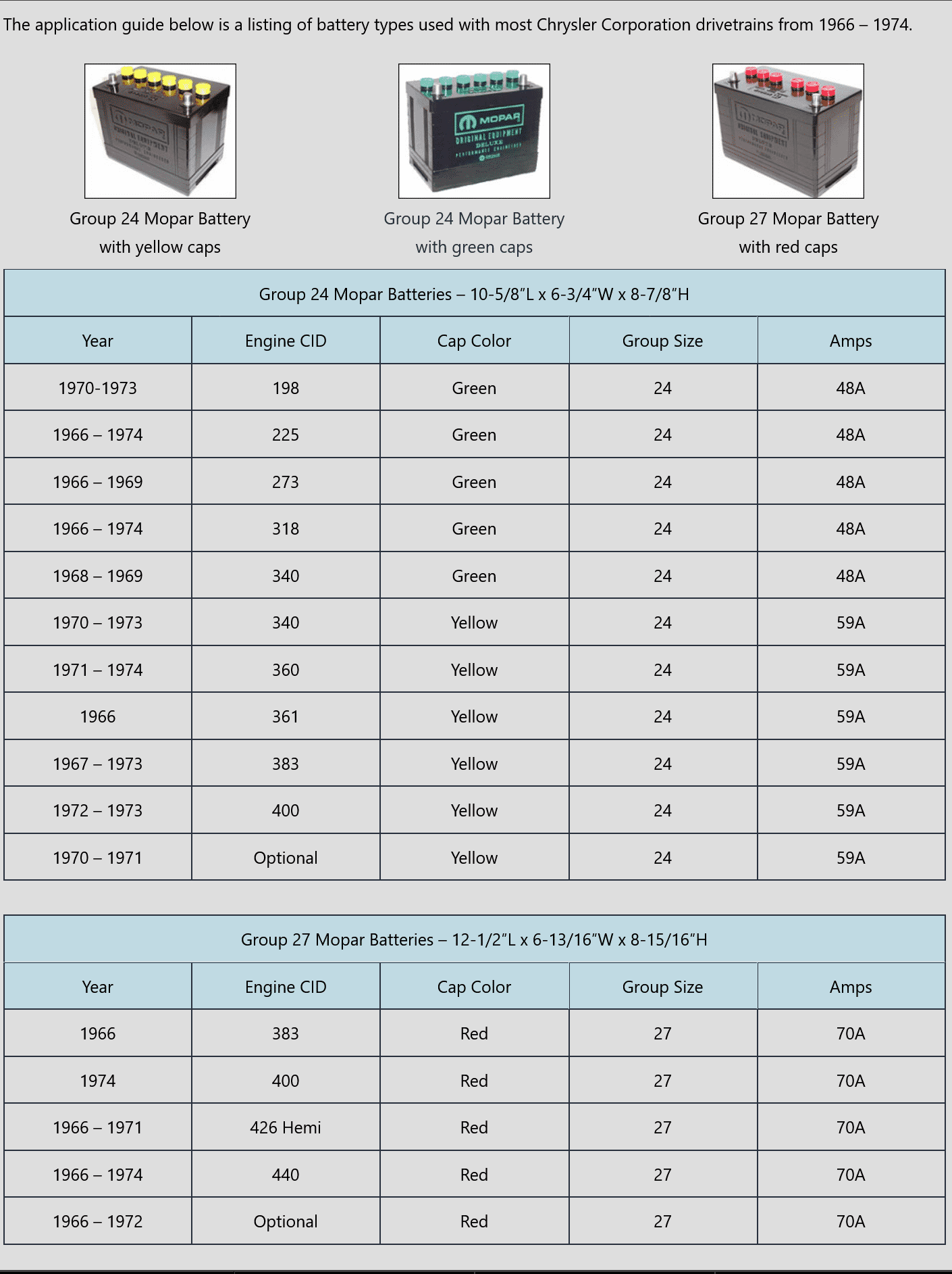

Is your question for your 1970 Challenger 340 engine's battery?
If so, the Group 24 with Yellow caps was the standard battery. The Broadcast Sheet shows the battery on Line 3. Example below is 20 = 59 amp.
You can purchase a repro battery, a battery topper, or a battery cap kit.
