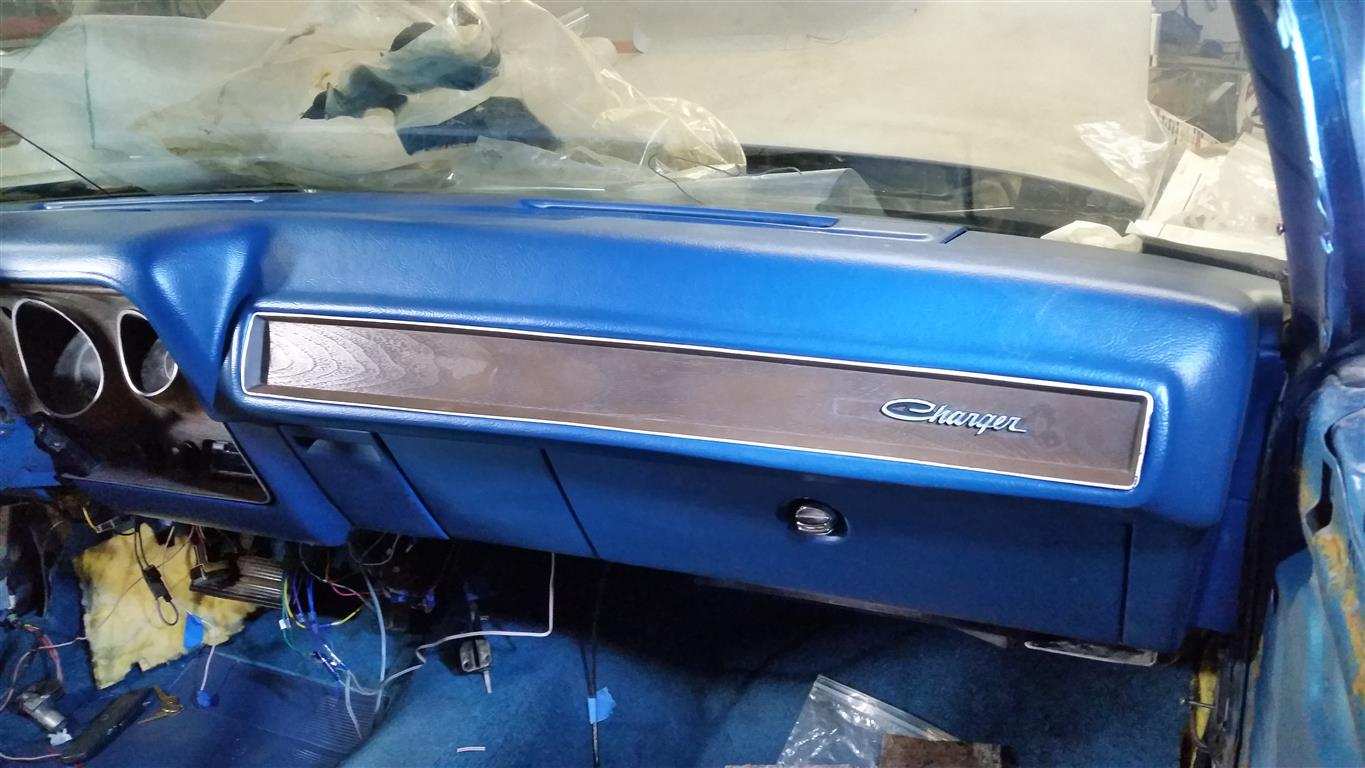

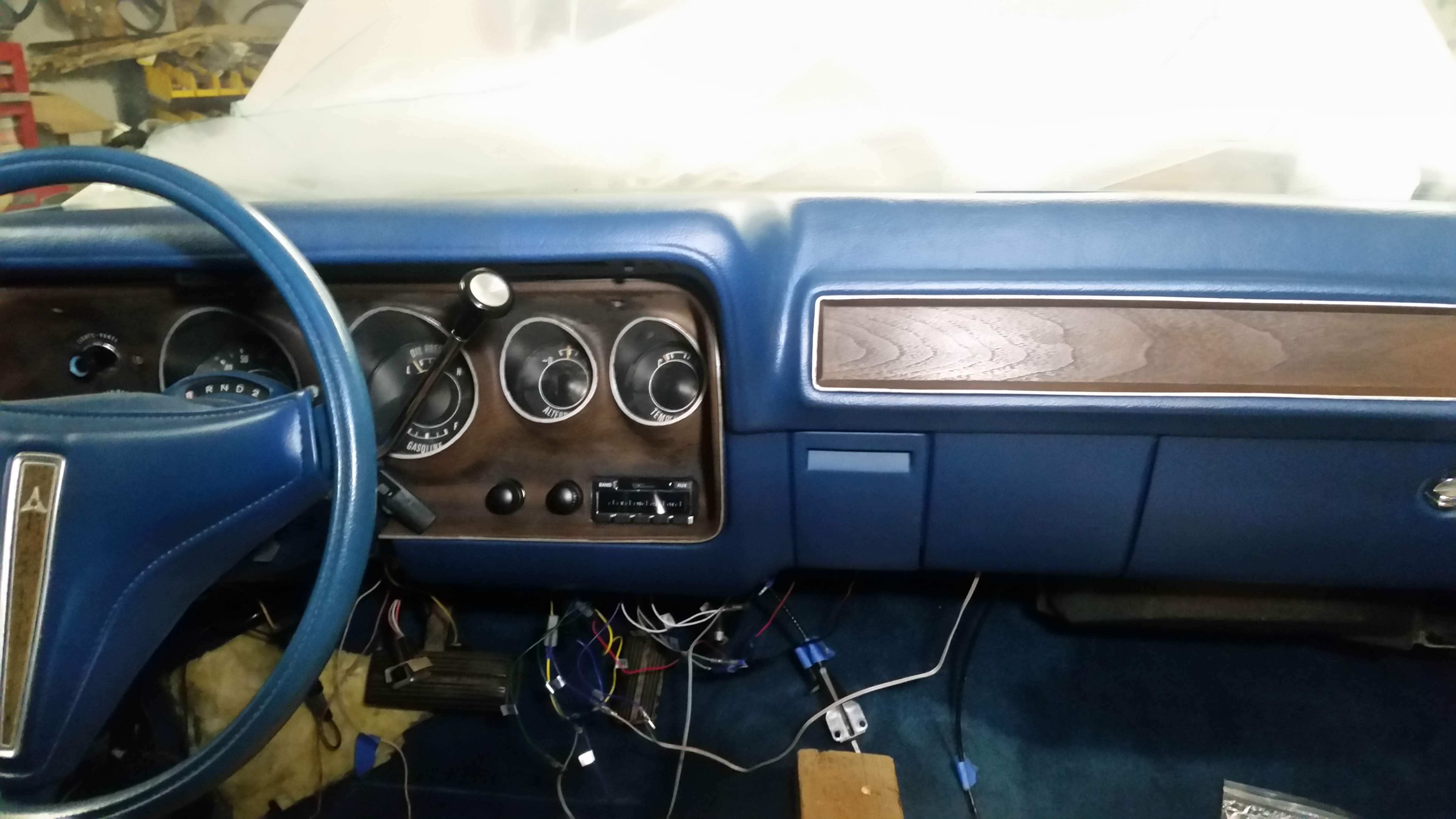

A dash pad with a steel core is over $1000. Dash cover is about $200. Dash cover as mentioned above is glued over existing cracked dash pad and is usually a poor fit unless carefully trimmed, really glued well, etc. Can easily tell a cover vs pad. Use a cover only if you can't afford the pad or just save up for the pad while living with a cracked pad. The photos I added are a dash cover that I spent many hours carefully trimming before installing on a b-body I have. The grain detail is not as good as the original pad.
