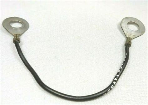

There is a 6" ground wire under the column the carries the ground.

Have you verified key-switched power at the fuse for the radio/turn signals? If the four ways and the brake lights work, it’s not a ground issue at all. The pictured column ground wire is for the horn switch and gear shift indicator, if equipped, only,
