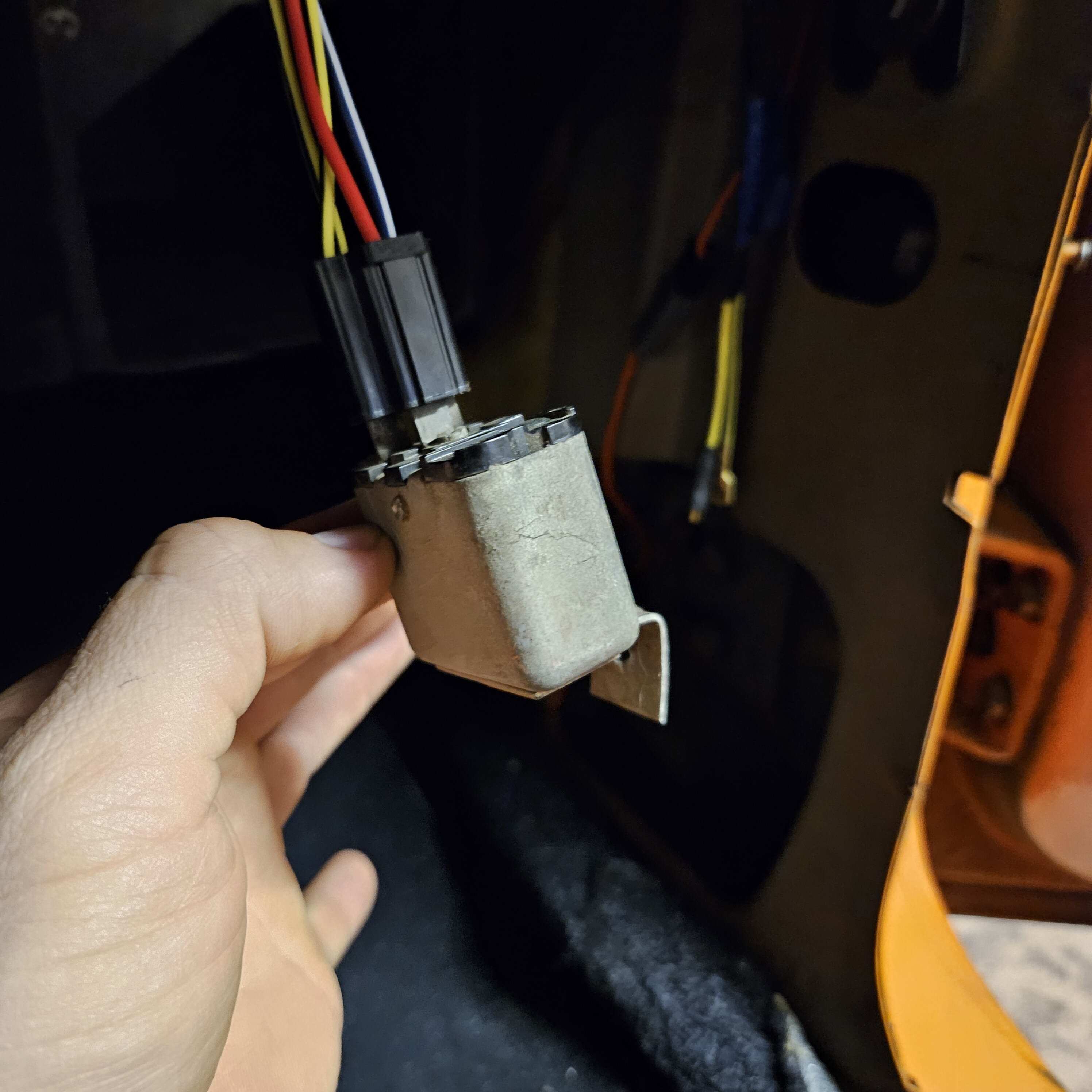

Hello I have a 1970 challenger rt and i need help identifying this switch on passenger side behind glove box. It has a bracket on it and 4 wires going to it.
2 yellow/black, 1 red, 1 blue white. This is a dash harness from year one. See pic
Where can I get a brand new one at?

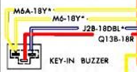

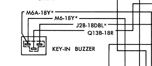

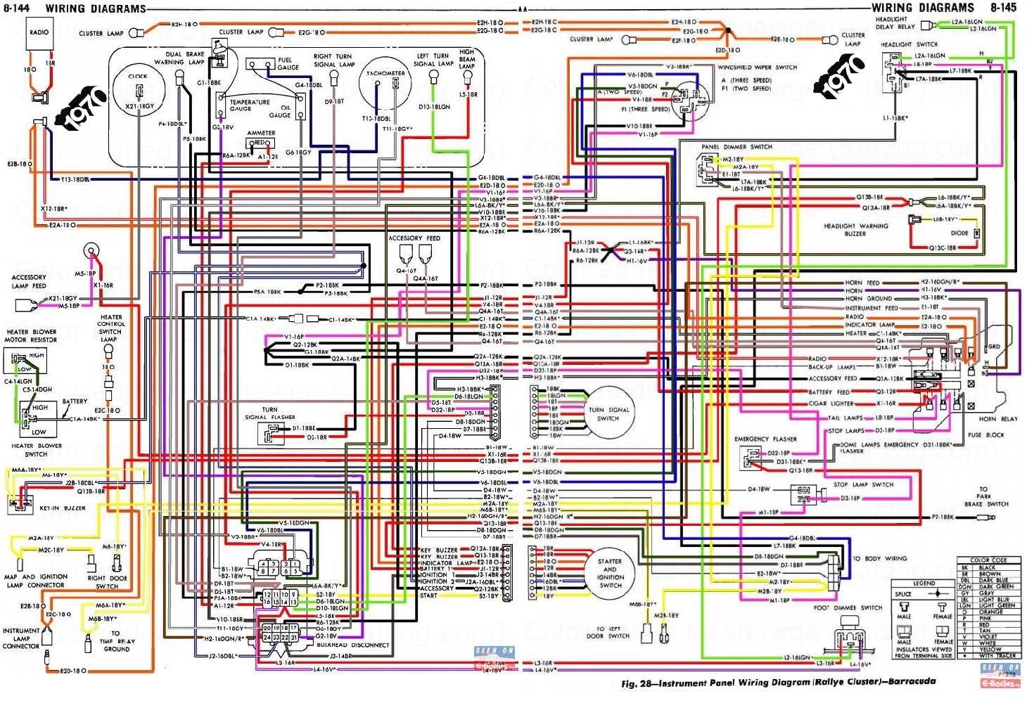

1970 diagram shows the two Yellow/Black tracer, one Red, and one Dark Blue/White tracer for the Key-In Buzzer. See lower left-side near bottom of the wiring diagram. Barracuda and Challenger diagrams are almost the same for 1970.
