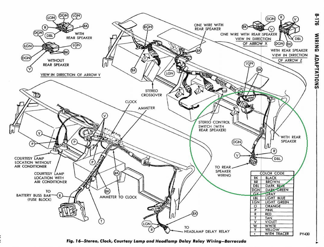

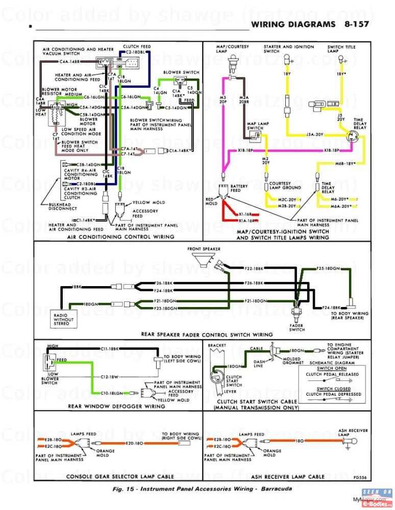

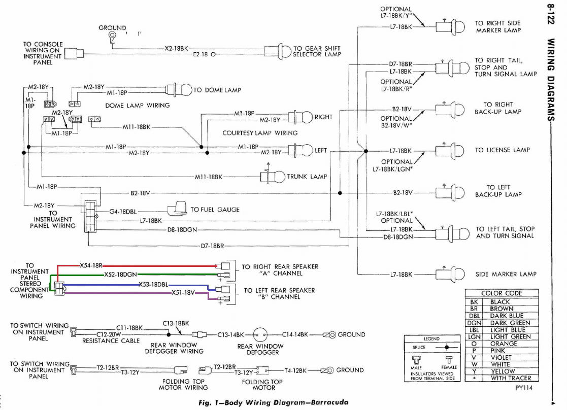

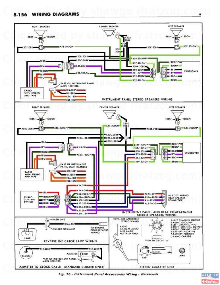

I was wondering if anybody had a wiring diagram for a five speaker AM FM radio system. Unfortunately my rear speaker harness was cut sometime ago and I'm trying to identify the correct wires for the right rear and left rear speakers. Thank you in advance

Rear speakers

Thanks for the diagram but what I need is the color codes for the four wires that are going to the rear speakers on a five speaker stereo system.

Right rear speaker wiring is DARK GREEN (+) & RED (-).
Left rear speaker wiring is VIOLET (+) & DARK BLUE (-).

I just spent $300 on a harness and I just needed to get the right connections for the rear speakers. You can see my other adventure on another string where I'm trying to refurbish the dash. LOL
