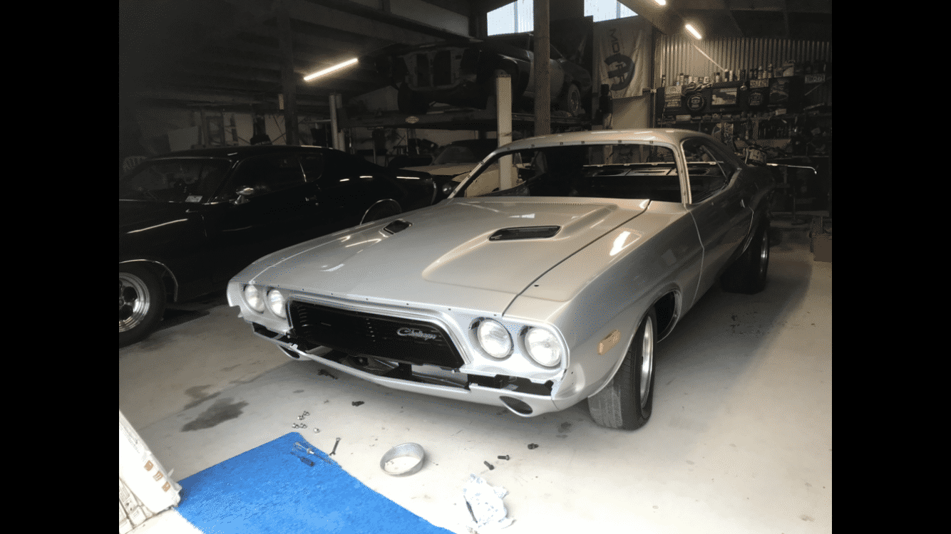

Hey guys looking at big block motor options I got 383 that will need bore out and one sleeve on a budget so
Crate motor options? New heads after short block build price/ quality and other issue is down in New Zealand so shipping costs jump in as well any advice would be appreciated photo of the car
