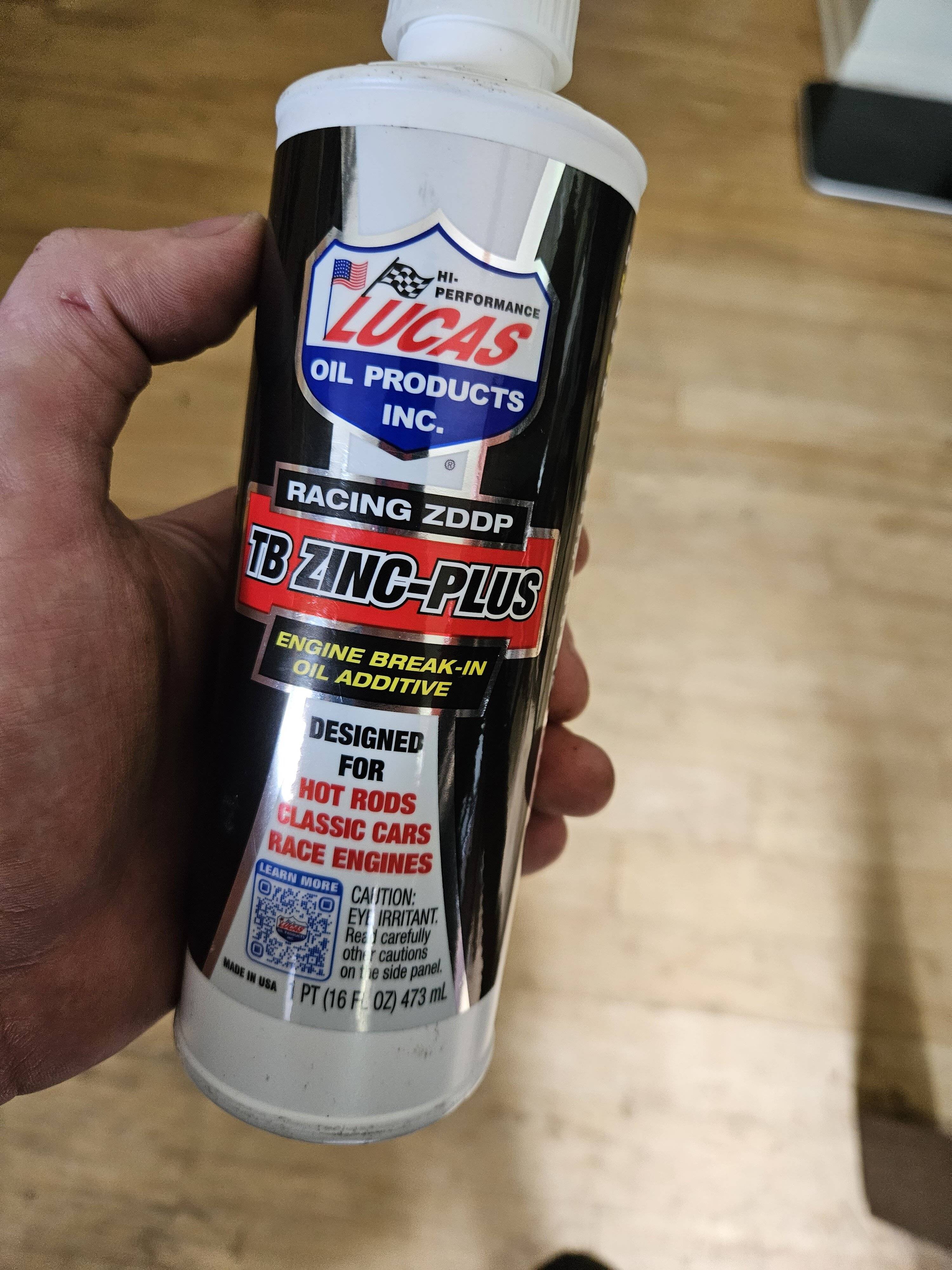

If you're not running a roller cam I would definitely put some of this in whatever break in oil you use.
Amazon product ASIN B006LB70SW
How about this stuff?
I seem to recall hearing Nick of Nick's Garage YouTube fame suggest in a recent video flat tappet cam shaft break-ins benefit most from the zinc additives, while roller lifter setups benefit less.
