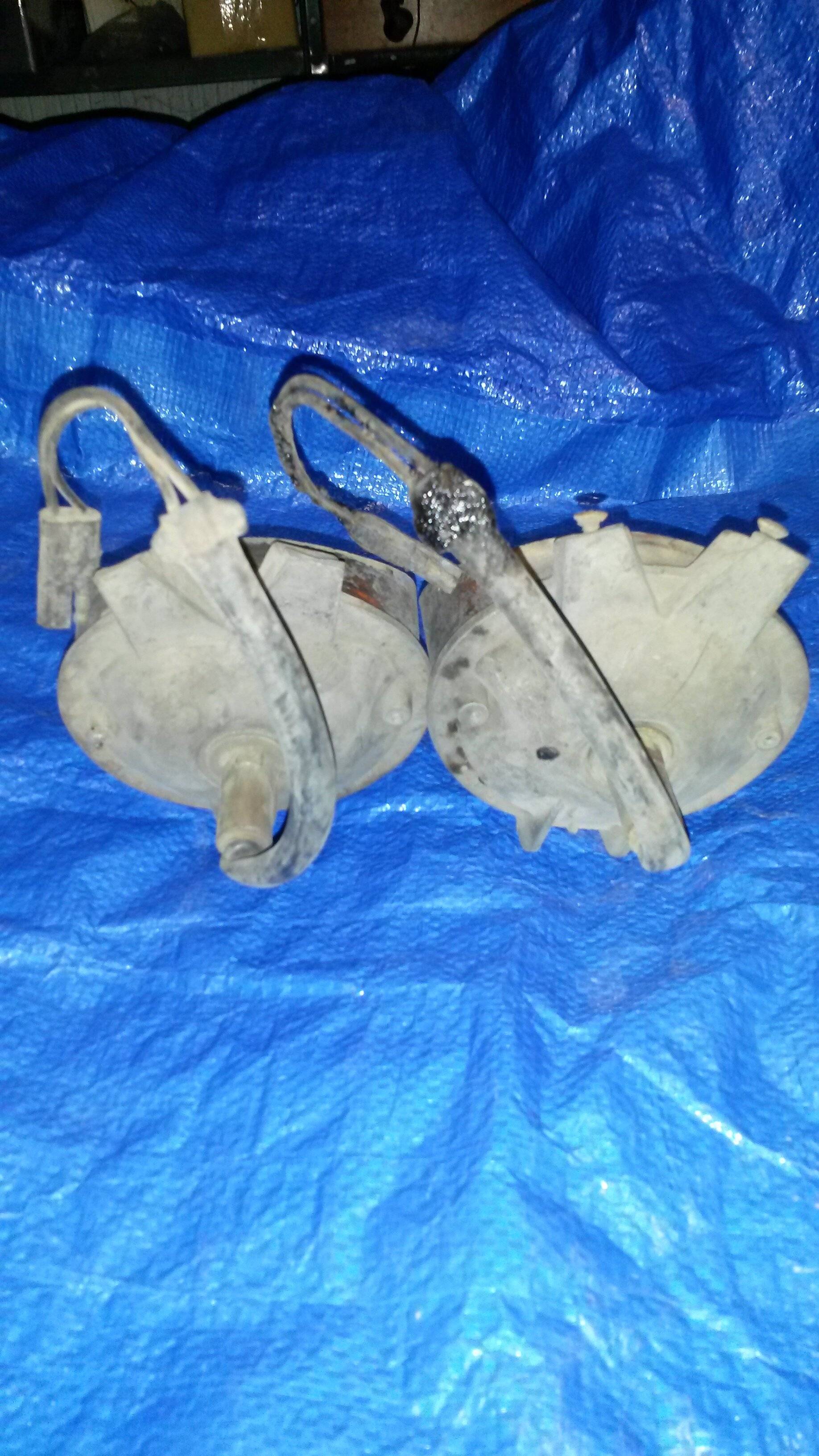

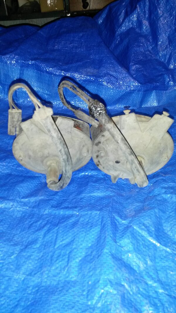

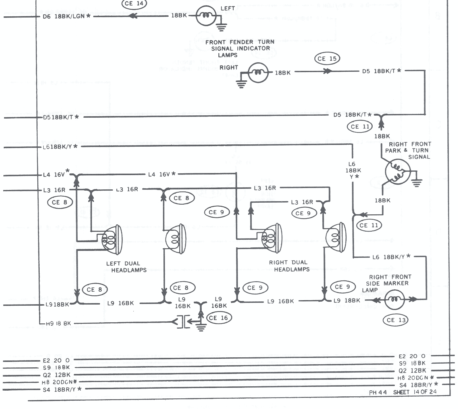

The original plug has two wires. one for parking light and one for turn signal.1157 bulb.grounded by the screws.

When I put on the park lights I get:
Tail lights
Front park lights
All 4 side lights.
From memory also get instrument lights.
The indicator circuit is separate from the park lights. It uses a different wire and a different filament in the bulb.
