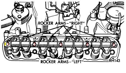

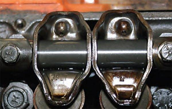

Here is a good picture of the factory 340 stamped steel rocker arms showing the left and right pushrod "dimples" or "cups".
Where are your pushrods rubbing in the pushrod tunnel through the head? On the sides of the pushrod tunnel?
yes on the sides, Thank you for this pic, I have gone down to my Dyno guy and mentioned this left/right rocker set up. Thanks man for your help...much appreciated all you guys have helped out, thanks all!

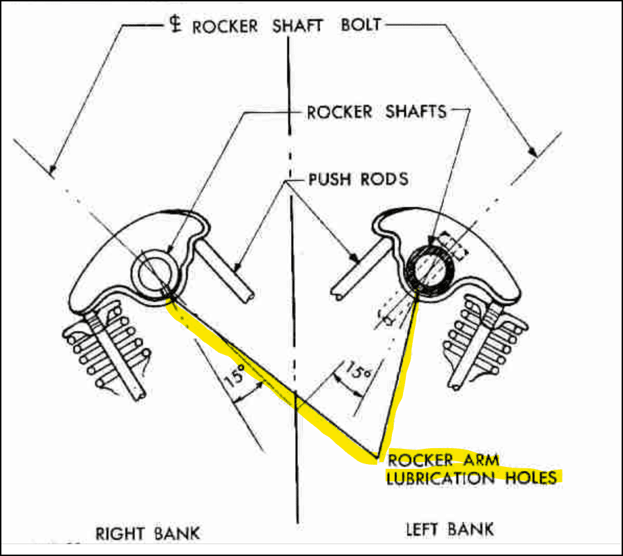

I believe the notch is to the bottom. Also the oiling holes are to the bottom. Kim

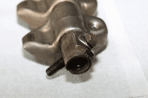

For reference, the rocker arm shafts have a notch on one end and it does go to the bottom as gf7cuda said. When facing the engine from the side, the notch goes down and to the left. In other words, the driver side has the notch at the front of the engine and the passenger side has the notch at the rear of the engine. This also orients the oiling hole in the shaft to lubricate the rocker arm properly.

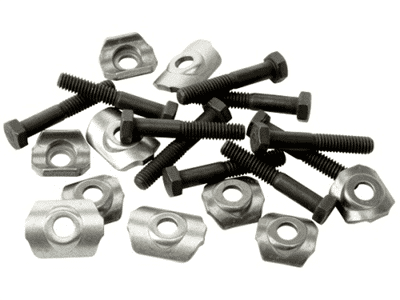

NOTE: You also want to check the narrow and wide holddown retainers for the rocker arm attachment bolts are in the correct locations. If not, your rocker arms will not be centered on the valve stems and the pushrods may be "angled". It is hard to get this wrong but who knows? Might as well check it.
Here are the diagrams.
This diagram shows the rocker arm shaft holddown bolts. Each bolt has a retainer under it. The ends and center bolt get the narrow holddown retainers (location 1, 3, & 5). The wider retainers are at locations 2 & 4.

Narrow end retainer with notch at bottom of shaft and the retainers with bolts.
