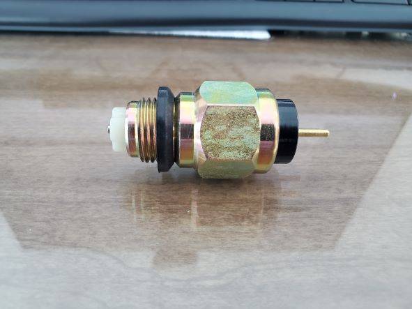

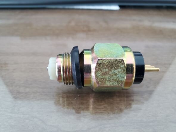

This new switch doesn't work. I tested it before I installed it. The center pin doesn't ground when the plunger is pressed. The reverse terminals work. The switch in the car, the center pin is grounded in park and neutral but the reverse pin have no continuity in reverse. So I think I will need to drop the trans pan.

Before you condemn the new switch, all tests described above, are to be performed with the switch installed in the transmission.

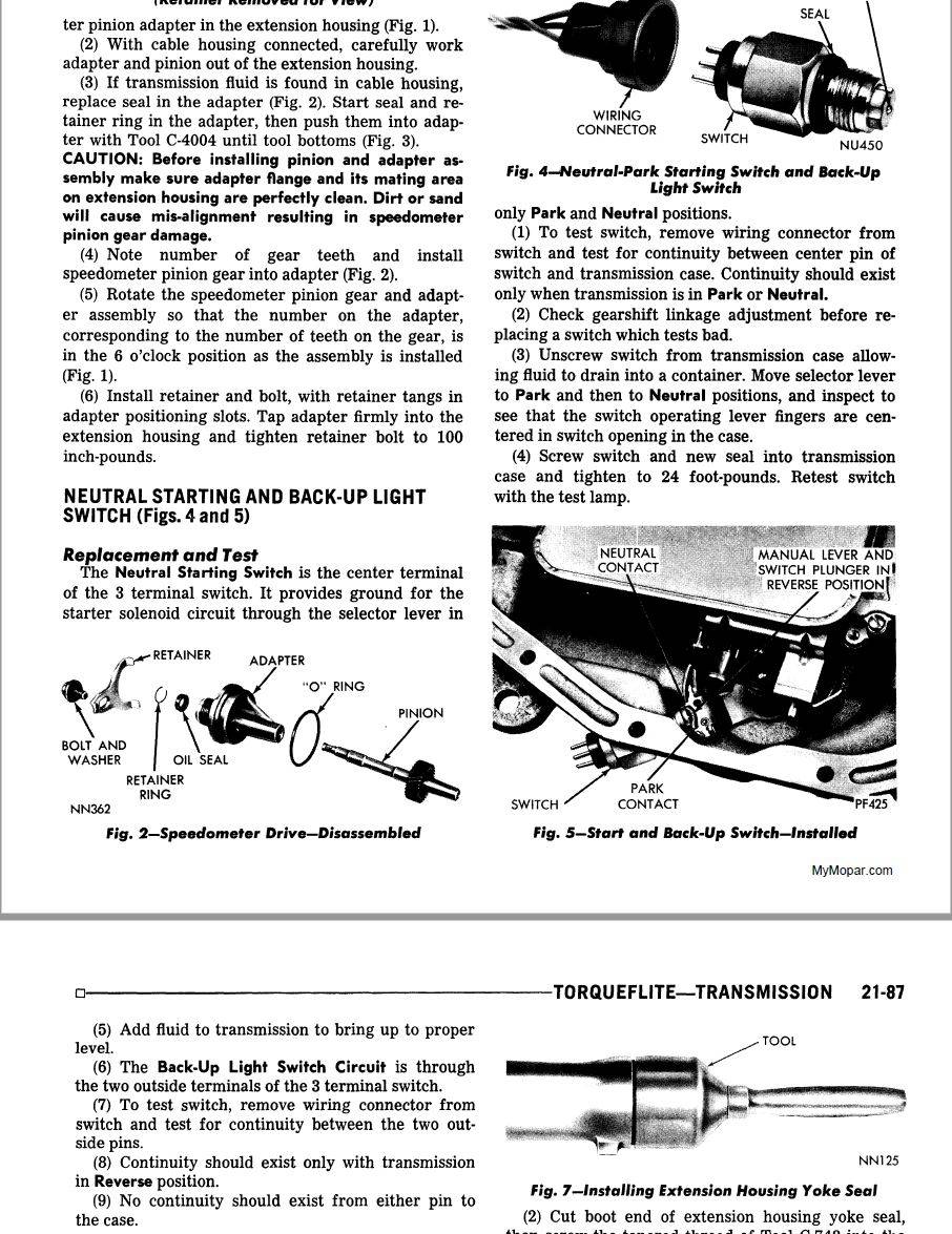

I was reading another thread for testing the switch. I was testing the switch incorrectly. I should have tested the continuity between the center terminal and the small silver nub on the insulated piece.
