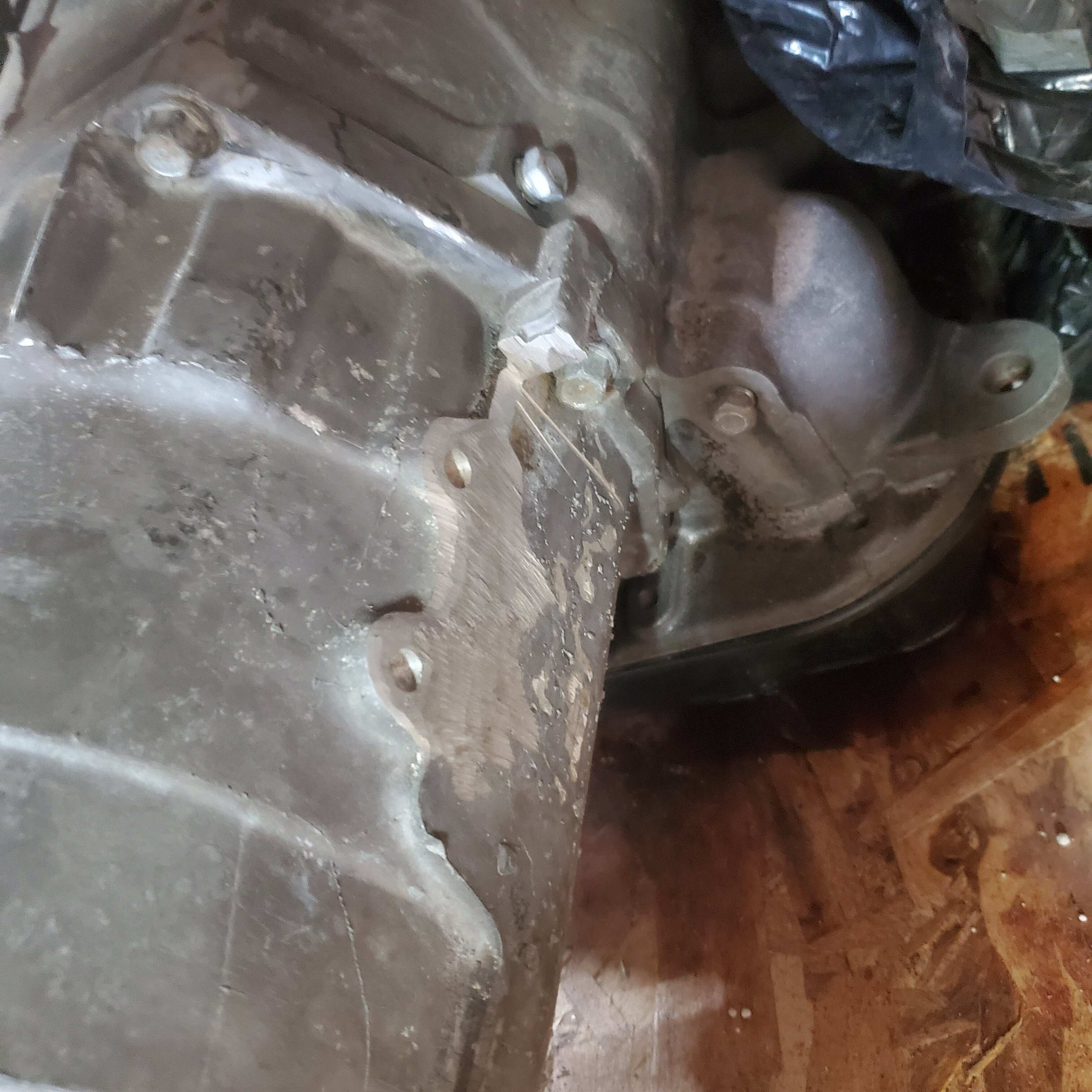

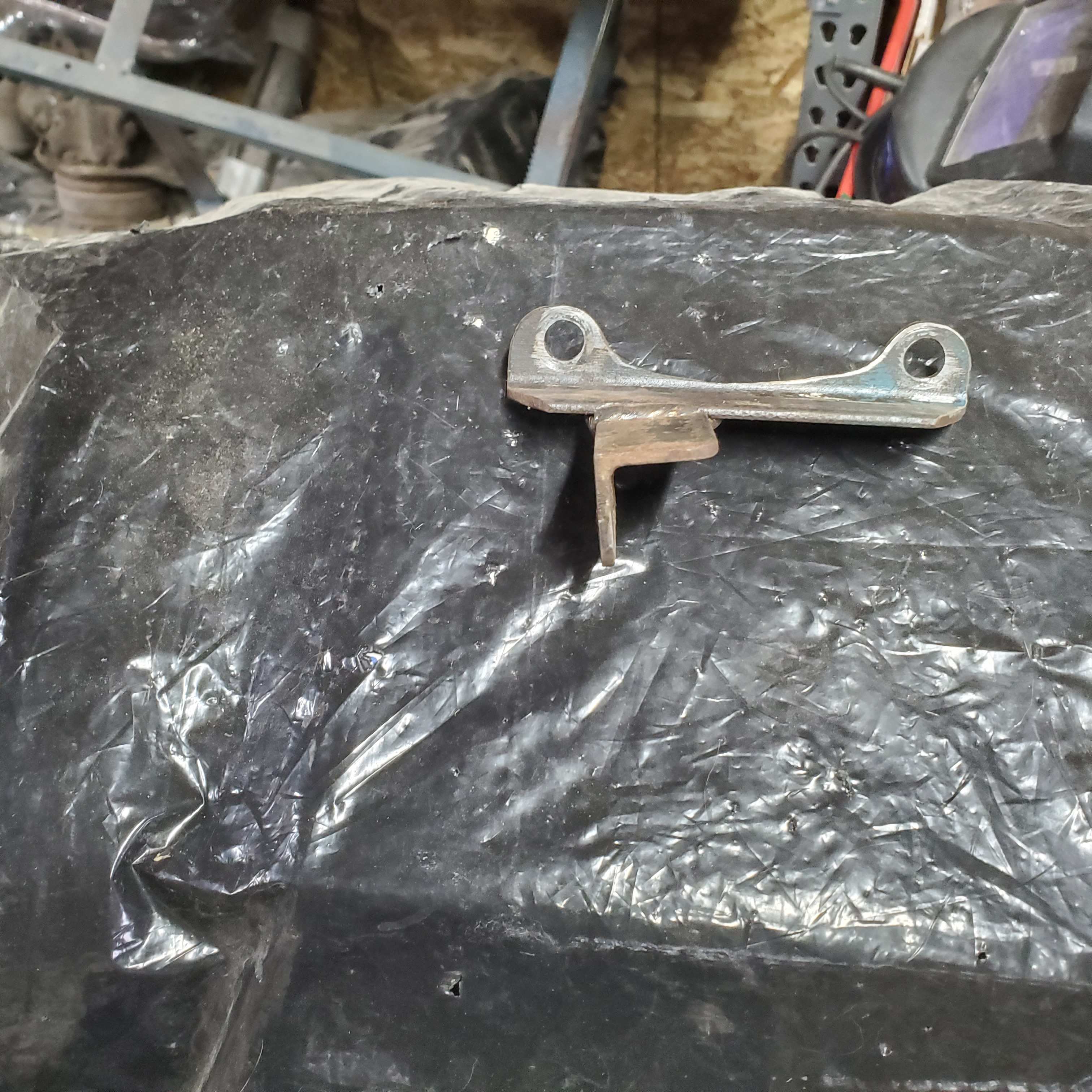

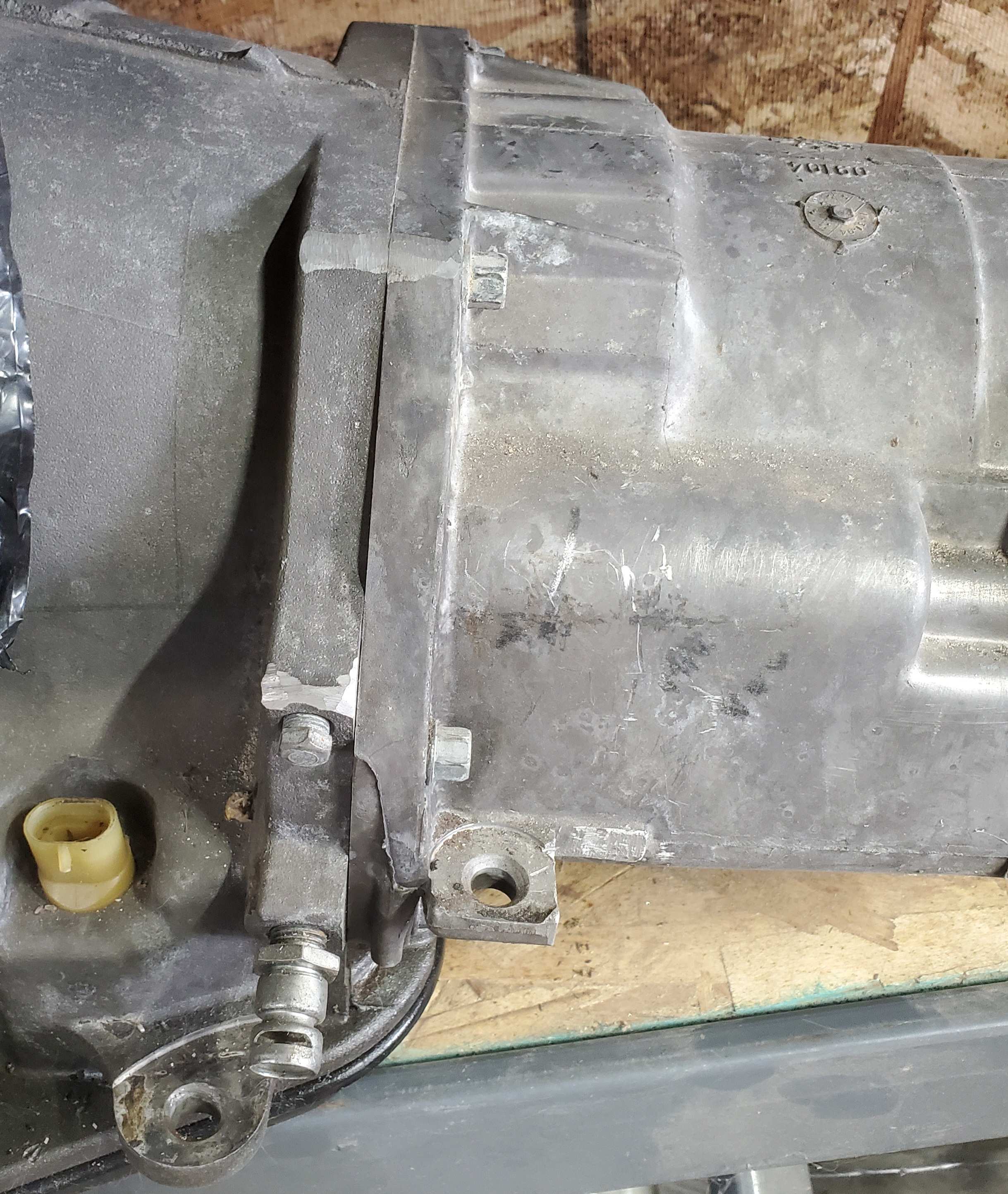

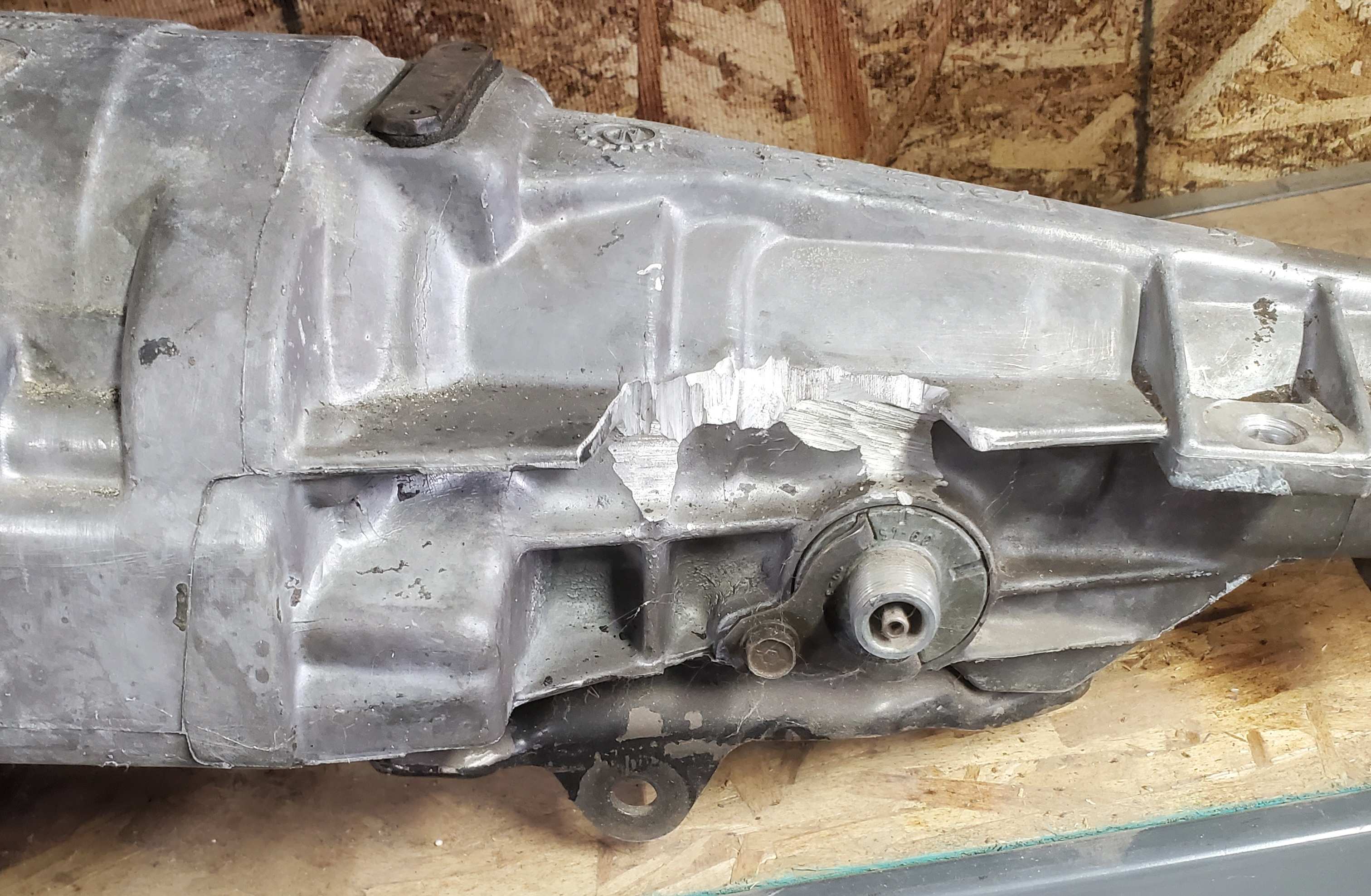

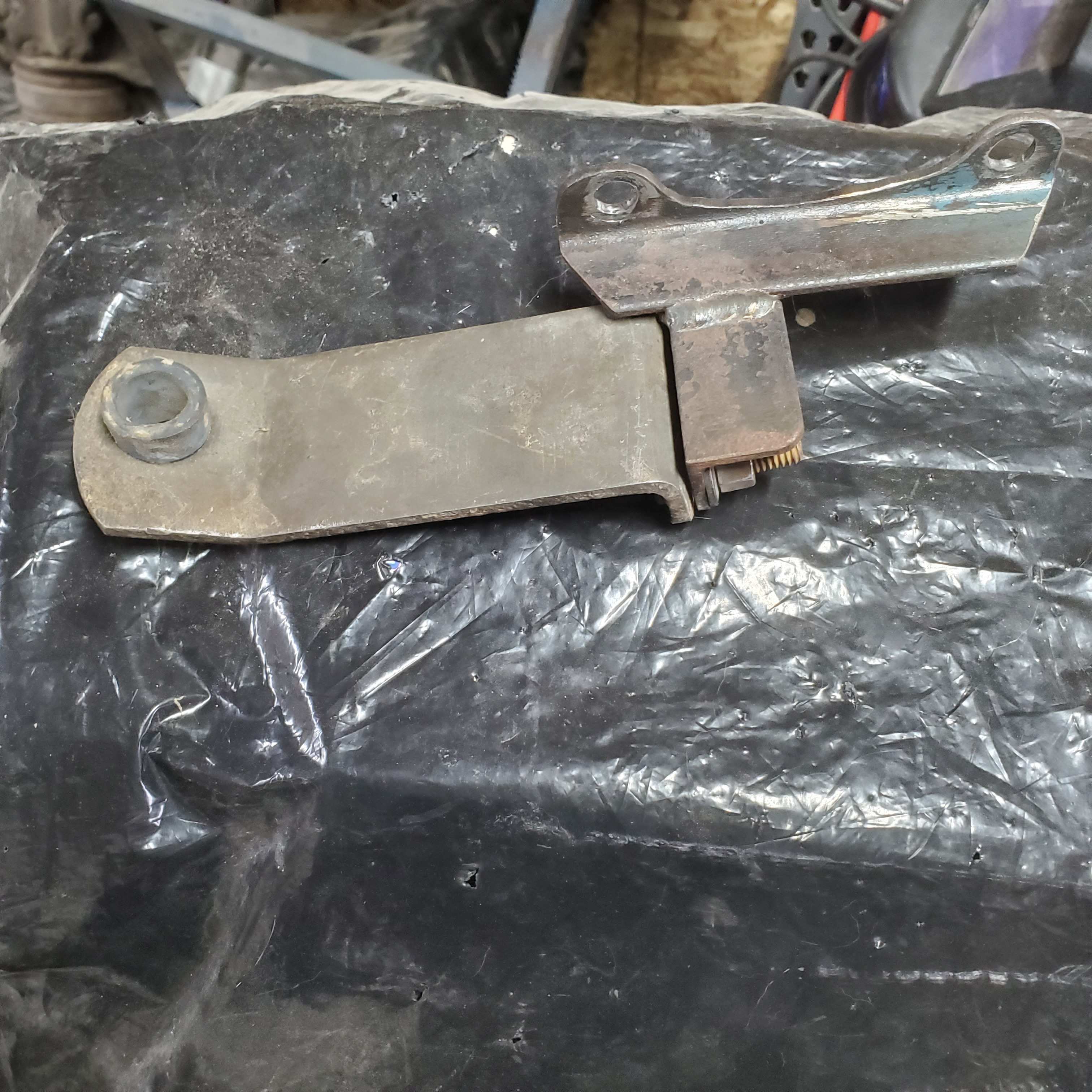

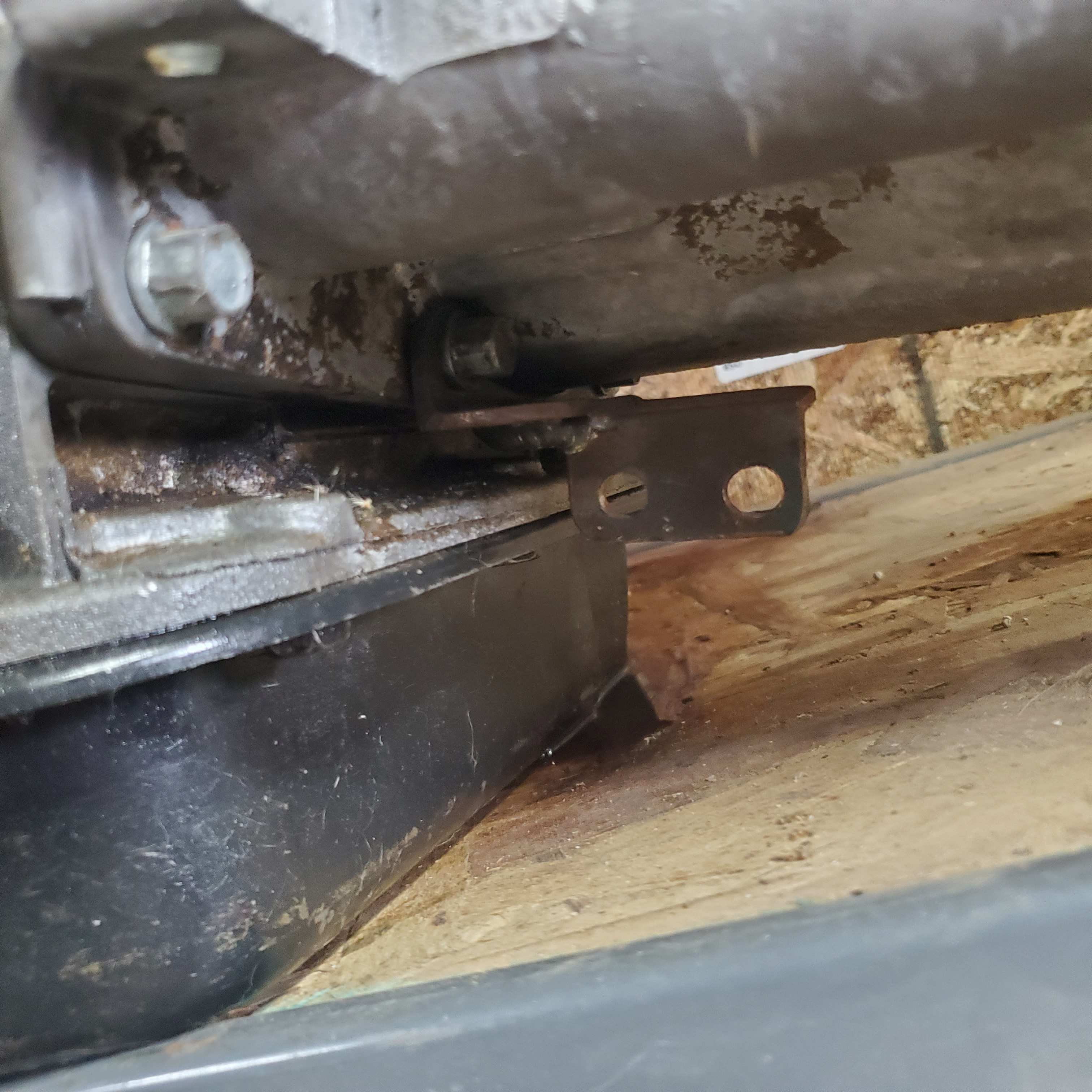

OK. So below are some pictures of my 46rh (1994) that I had installed in my 71 barracuda. You can see all the places I cut webbing and ground corners for plenty of clearance in the e-body tunnel. Also included are a couple photos of my homemade bracket that allows me to use the stock floor shifter. So everyone following this thread gets to see a 46rh that totally fits in an e-body with no modes to the actual car! I don't have photos, but the stock e-body 3 piece kickdown linkage was hooked up as well.
