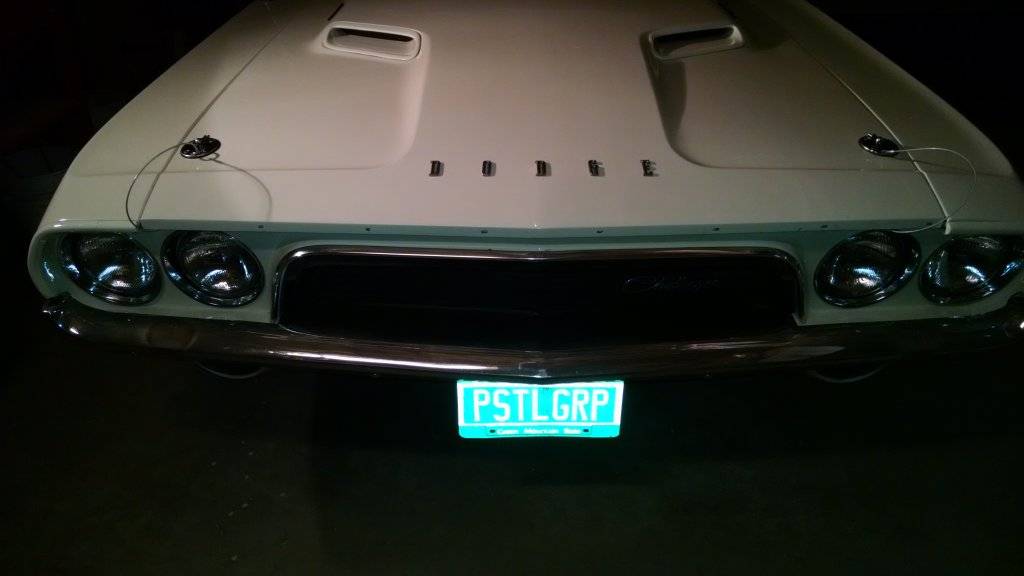

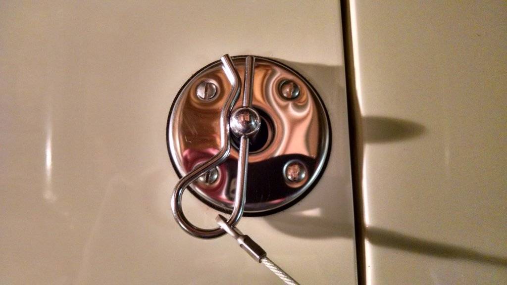

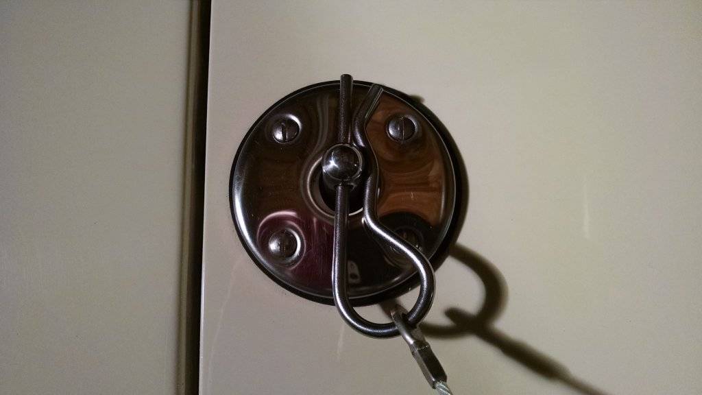

Purchased hood pin kit. Was wondering what position the holes should to be drilled for the bezels. Inline with the body line (guess best way to describe it a "t" pattern) or a "X" pattern if standing in front of the car. Also, what position should the pin holes be facing. Thanks for your help!
I just noticed some of the holes in the "X" pattern under the hood. Think I will use stainless screws with lock nuts instead of the self tappers provided with the kit. Will post pics soon.

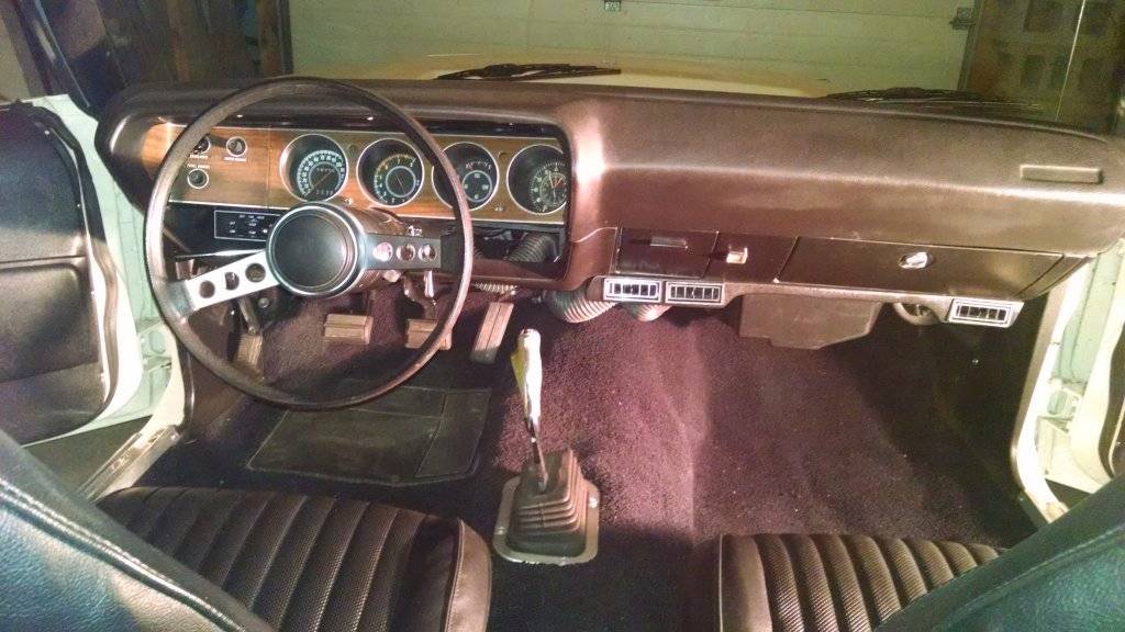

It's hard for me to give an opinion because I purchased the kit used form a restoration shop. They were going to put the kit on a numbers matching big block Cuda convertible. The restoration shop kept telling the owner of the car that he should not put the after market kit in the car because it was a numbers matching car and the Classic Auto Air kit would ruin the restoration. The owner was determined that he wanted A/C in his car but changed his mind during the build. The kit sat around for quite a while collecting dust. Unfortunately I had to purchase a $275 kit from Classic Auto Air to get the compressor mounted onto my small block. I had to fab up one of the brackets because of my after market aluminum intake manifold. Other than that the compressor seems to line up nice with the pulleys. The air handler mounted in okay. I really like the look of the vent system under the dash. I think the fit looks very nice as shown in my picture above. The other cool thing about the Classic Auto Air system is the way they use the existing heat/defrost control. The FAN and TEMP levers work normal but the HEAT/DEF lever has three stages for off, defrost and A/C. I guess if I was going to do it over I would go with the Vintage Air especially since I have the InfinityBox (company name was ISIS power but they changed their name for obvious reasons) electrical system. Vintage Air and InfinityBox have teamed up to make a nice integrated system. If it was important to try to keep everything looking original I would go with Classic Auto Air because you can use the original control lever assembly. It was a mistake for me to purchase this used kit. I paid $500 for the kit, an unexpected $100 for shipping, $275 for the small block bracket kit, $20 for a new switch that was broken, the housing was cracked and parts had to be fixed because of a lousy packing job. I think both Vintage Air and Classic Air go for around $1,300 and I have about $900 into this one with a compressor and all other parts that have been exposed to the atmosphere for quite a few years. I still need to have hoses made up because the hoses I have are for a big block and the compressor is in a little different place than a small block that's going to cost about another $100 bringing the total to around $1,000. Lesson learned.
