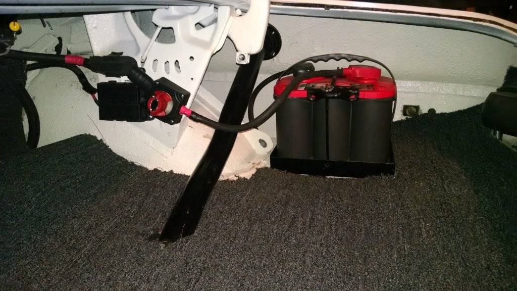

Power switch with fuse installed.

The red wire spade connector on the molex plug at the firewall plug was pushed through to the inside not allowing electrical contact to be made on the red wire. I ran a separate wire to ground from the back of the switch base plate, fixed the firewall terminal and now it works as it did when it came off the line in 1973 (very cool stuff!). On to the next project of running a separate wire from the radio all the way back to the battery positive terminal before my shut off switch. When I turn the switch off in the trunk the radio looses all of it's settings and I need to reset all the stations, treble, bass, etc... every time I go to turn the car on with the battery switch. There is a separate wire they want you to run direct to power all the time and another through the ignition circuit. Don't worry, I will put a fuse at the battery lol :)

Run radio wire direct to battery. "Check".
