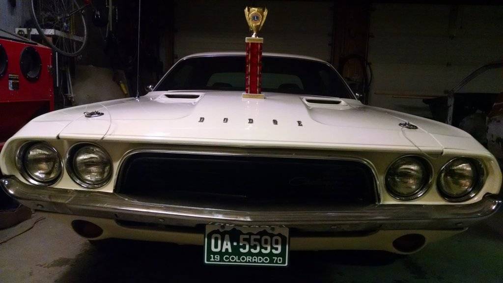

Kowalski plate does not match my year Challenger but the Alpine white and pistol grip are the same. A guy with a nice Corvette at this show of about 300 cars said that my car was "best in show". Having a lot of fun this summer!!! It's not even July in Vermont and I have put over 5,000 miles on the car so far this year. About time for another oil change. Can't seem to stay out of it (lol).

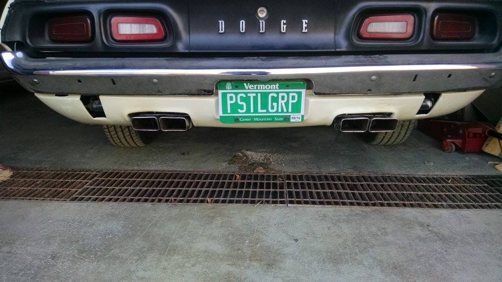

I'm currently trying to figure out why I am getting carbon monoxide in the car. The exhaust has been all welded together and I am getting no CO readings near any of the joints in the exhaust system. It is coming into the trunk. When driving down the highway with the windows up I am getting about 30 to 40 steady PPM's of CO. OSHA says that 50 PPM in an 8 your work day is good but I would like for it to be ZERO. The CO reading is worse in the trunk so that's where it is coming in from into the car. I have looked in every little nook and cranny using a flashlight in the dark and spraying water in that area from the outside with a garden hose to find and leaks in the trunk. I even closed my daughter in the trunk and shined a light around the rear of the car and the trunk lid gasket to see if there was any light coming in. It all seems to be sealed up. Very frustrating!!. I borrowed someone else's CO meter to make sure mine was working okay and they both reading pretty close to each other. I do not smell exhaust in the car. There is a slight exhaust smell on something that has been in the trunk for a while. If the PPM in the cab is around 30 the PPM reading in the trunk is in the 60's venturing me to believe it is coming in through the trunk. With the windows all the way down the PPM reading is still in the teens. I have all new gaskets, seam sealer, gas tank fill tube (that I silicone sealed), and I lizard skinned all of that area on both sides of the metal. I guess the answer is simple.... "It's coming in from somewhere". Has anyone else ever put a CO meter in their car to check for carbon monoxide? I'm a little hesitant to take a long trip in the car. Again, CO reading is worse in the trunk.

were dose the exhaust exit? how are the seal's around your tail lights!
Seals around the tail lights are new and look good. All body plugs are in. Get a little water drip that comes through the key lock when I blast water on it but that's the only area. Exhaust comes out the back valance.
