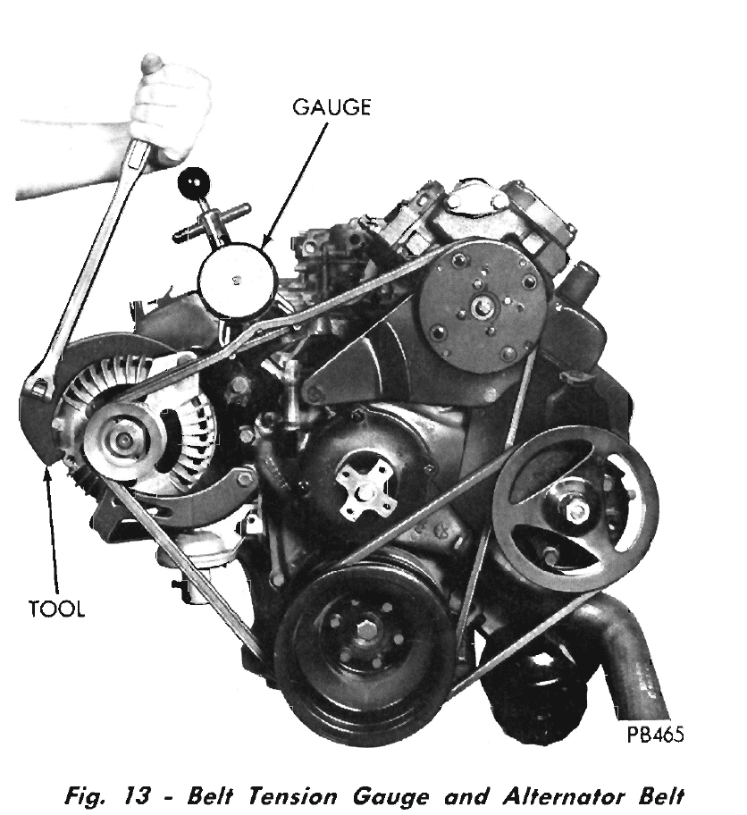

There's this in the '71 FSM........................
FSM & Parts Manuals here........
