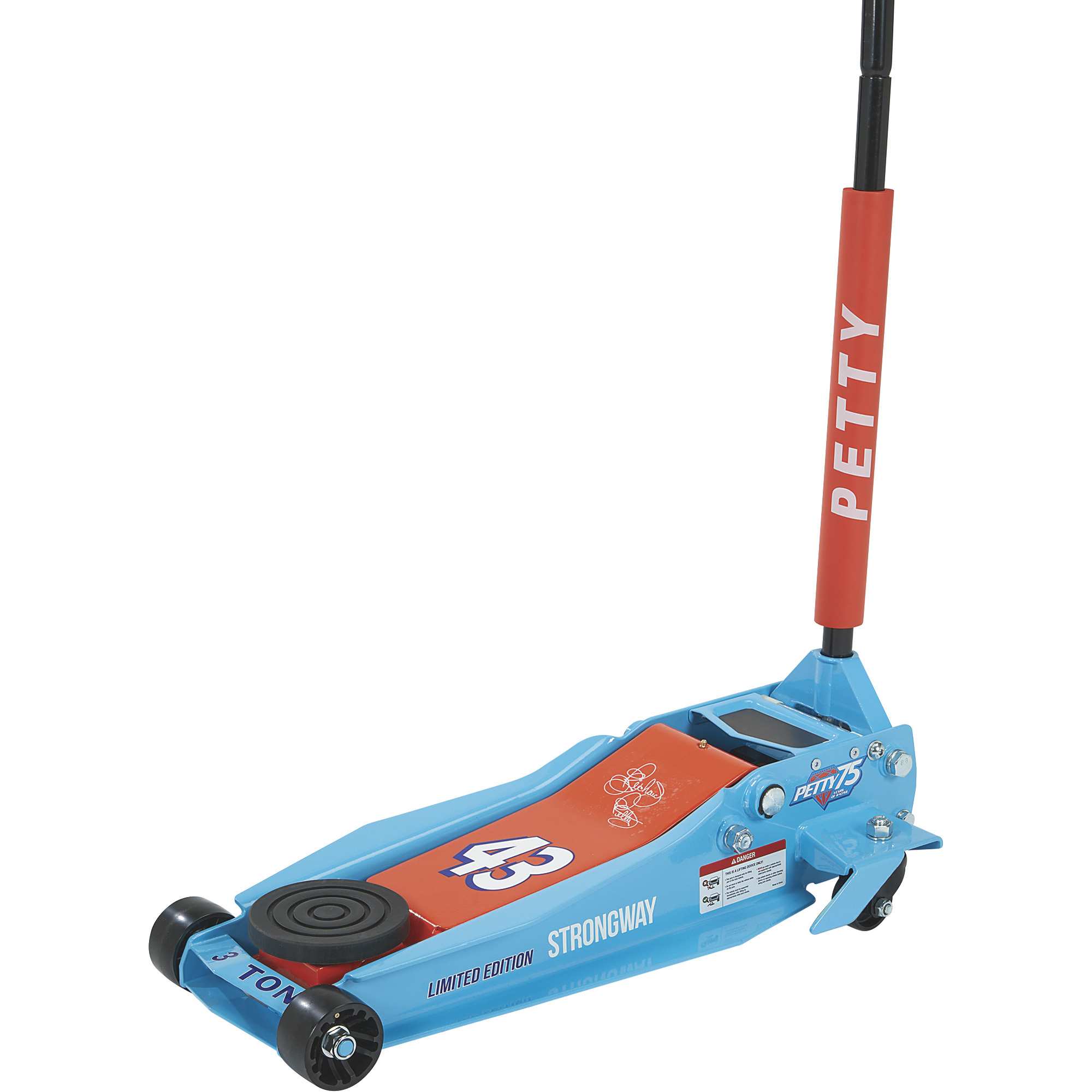

Now the weather is good and my back is good probably starting this week , also just had to get a cool new floor jack
, will let ya'll know soon .
