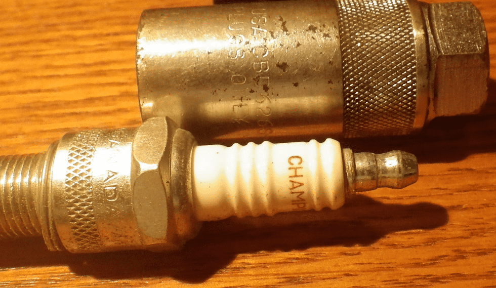

Mike, the spark plug socket I have has six (6) flats on it like a nut. I've used a 3/4" wrench and just the socket before! If needed, I can provide pictures tomorrow of the socket and wrench. On big block E-Bodies and HP stock exhaust manifolds, I've had best luck changing spark plugs underneath the car! Here in the desert that's a plus on cold concrete!

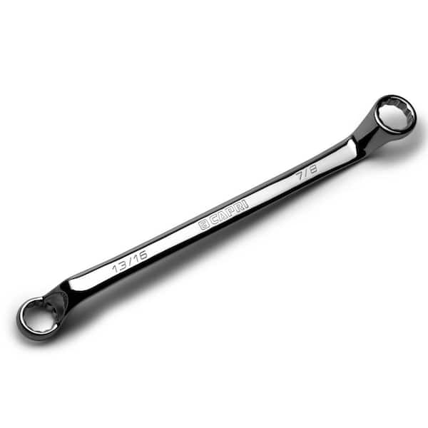

I just searched and found this wrench for $20 at Home Depot. It would get the plug out no problem. Probably what DetMatt1 is talking about!

This looks like a great option. I'll track one down and try it out.

The spanner in post #7 is an offset double ring spanner. I have one that I sawed the 7/8 end off.
It works fine to loosen or do the final tighten were there is not much room.
Buy a set of them they do come in really handy at times. They are good for intake manifold bolts.

Hey, thanks to everyone who posted ideas and stories. I was able to buy an offset double ring spanner like Steve340 identified and Xcudame suggested. It worked like a charm! In fact, I used it for #2 as well as #4 & #6 just like DetMatt1 posted.
I doubt I’ll need the tool often but it’s the ideal tool for this job.
