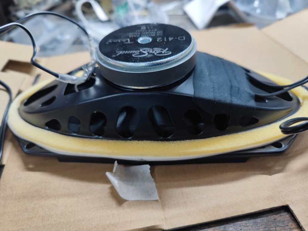

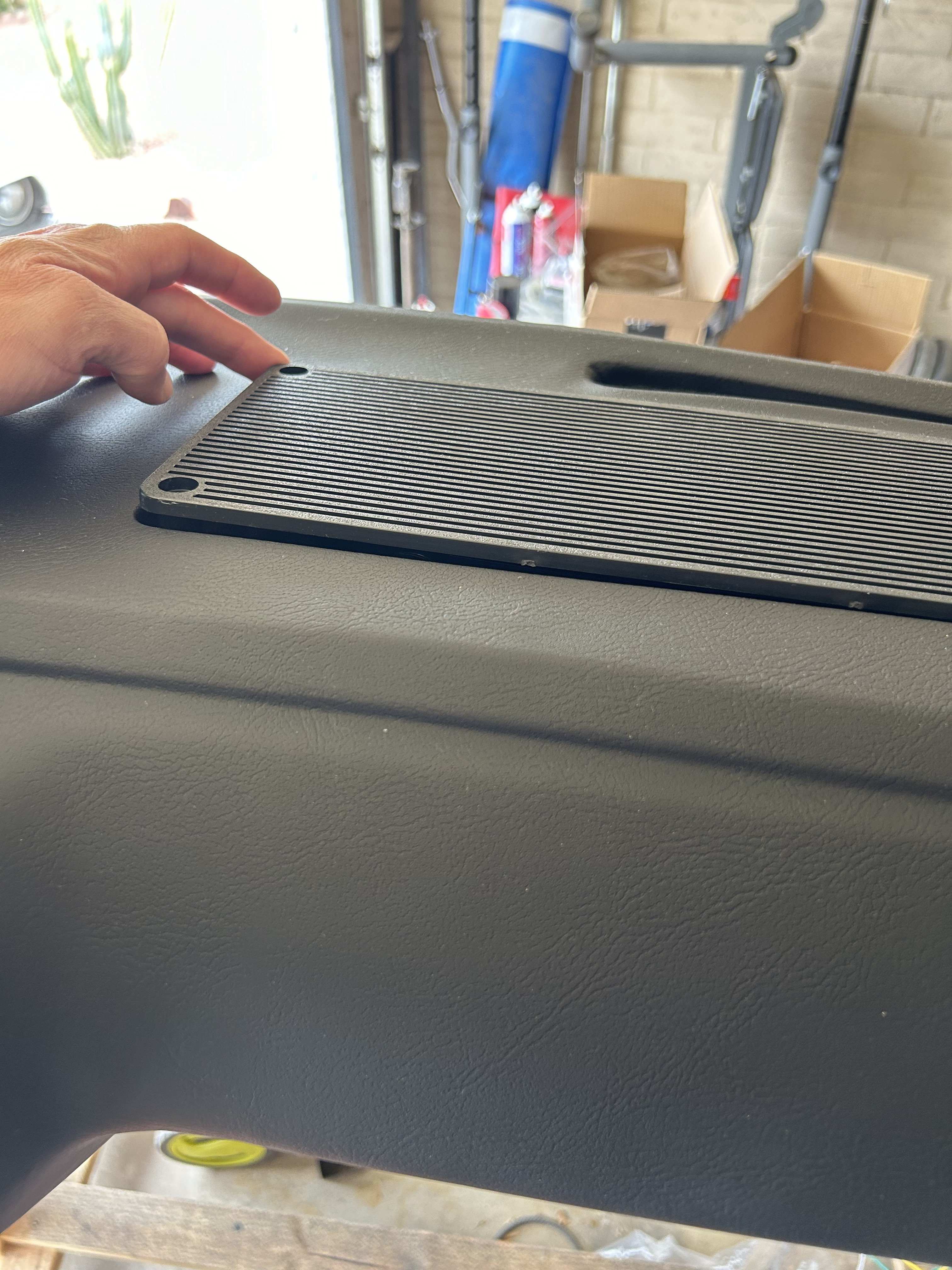

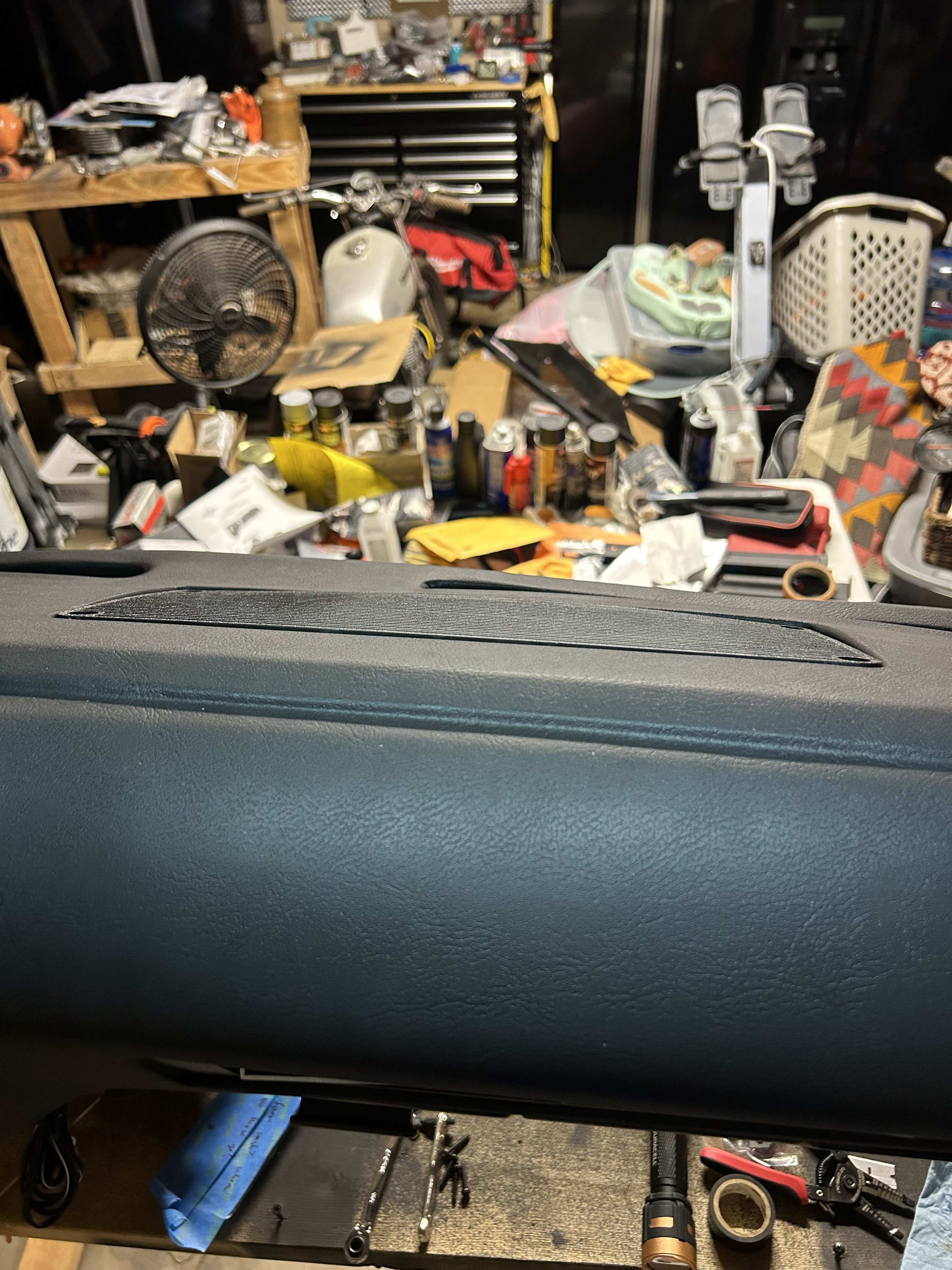

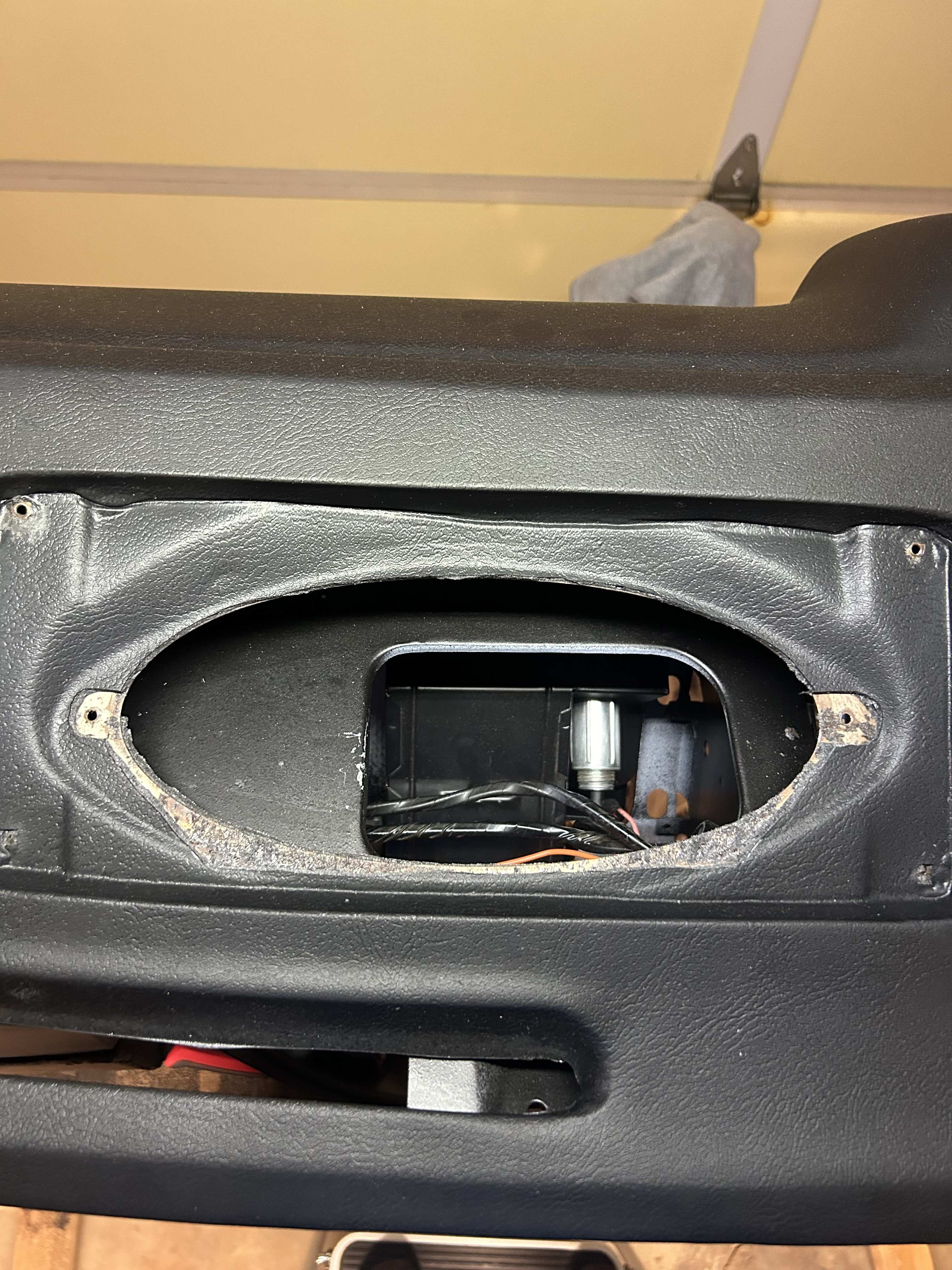

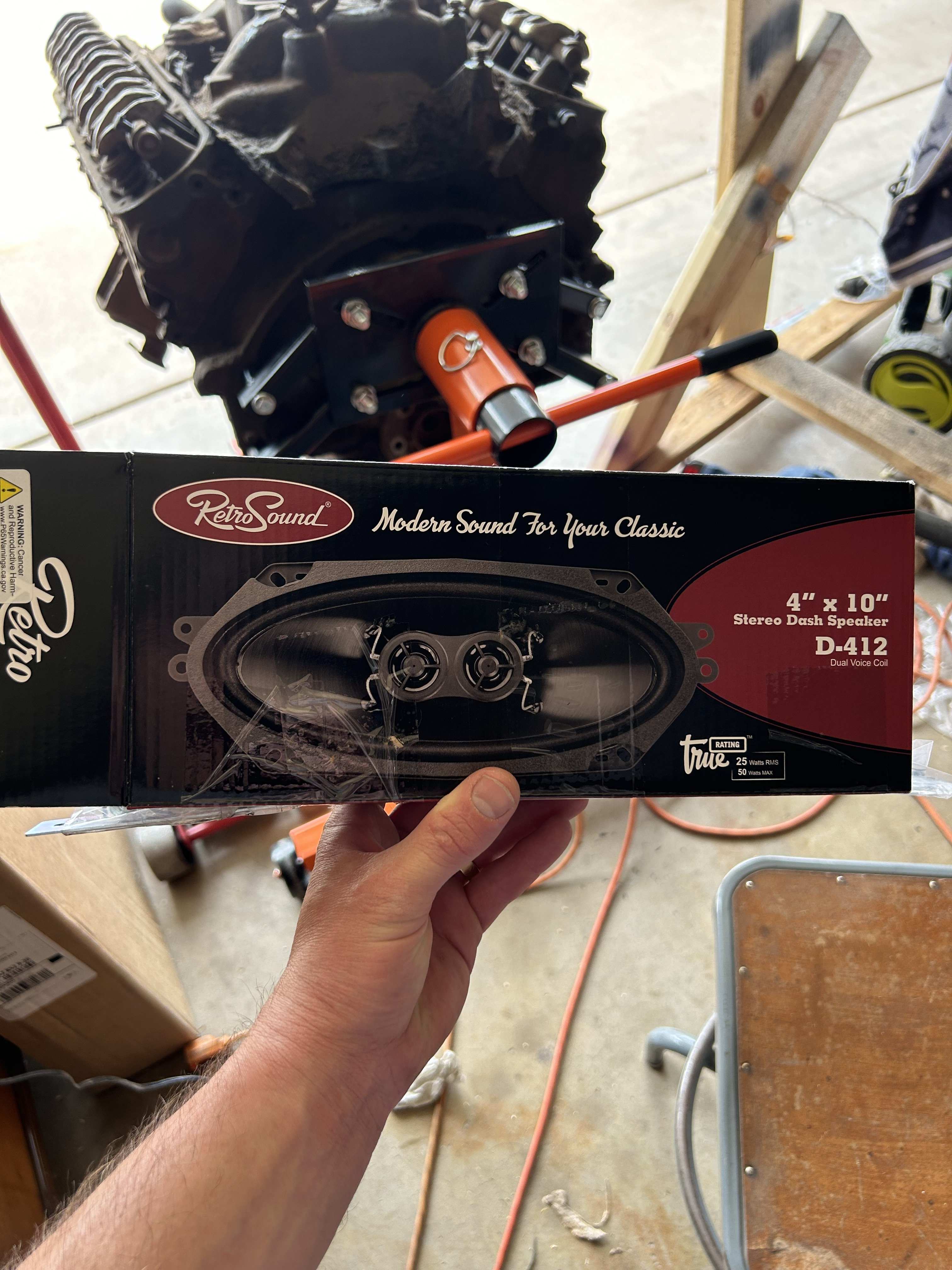

Has anyone had any success installing this 4x10” Retrosound speaker in the dash? I just had my dash pad redone, and the speaker sits too high, making the speaker grill pop out of the dash by about 1/4”. I can cut some of the tabs of this speaker to help it sit lower, but it seems I will need to trim away some of the new dash pad foam so the speaker sits on the metal dash frame. So I have some questions before I modify the speaker and can’t return it:
Has anyone installed this speaker? There are two (2) speaker connections for this speaker. The speaker wire connections on one side of the magnet have very little clearance to the steel dash frame. If I get it to sit lower in the frame clearance will likely get worse. Will I need to grind the frame to make clearance for the speaker connections?
If I trim the dash pad back around the boarder of the speaker, so the speaker can sit directly on the frame, will it cause the dash pad to prematurely crack or peel/pull back off the frame? Seeing as the hole for the speaker is already cut in it, I don’t think this will be an issue, but didn’t want to cut it and cause any adverse effects to the pad before asking you guys who have more experience.
Thanks in advance! Pictures attached for reference.

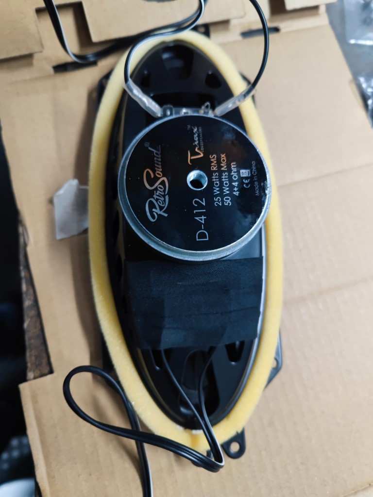

Hi

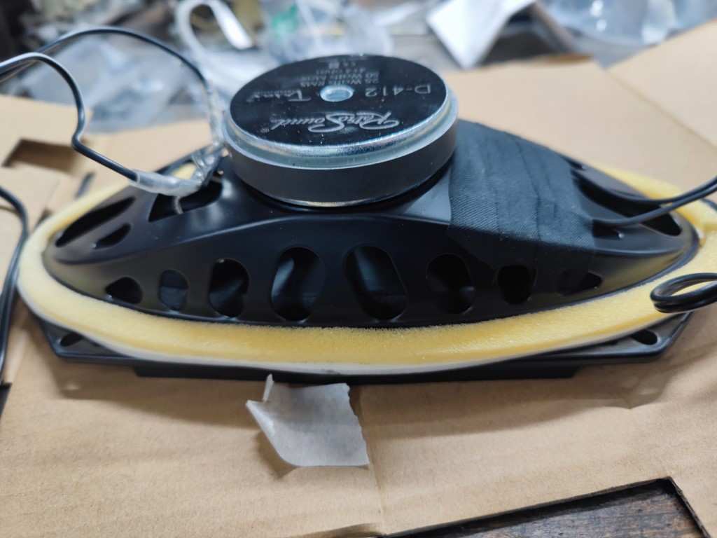

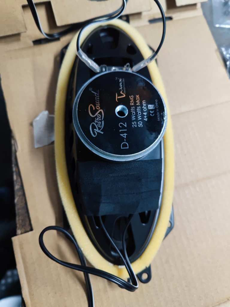

I had the same problem but managed to fix it. I first cut off one of the contacts projecting upwards from plus and minus. Then I carefully bent a terminal downwards. When everything is bent down nicely, connect the cable and insulate it well. Then put some insulation around the loudspeaker so that it closes off nicely. It only goes in one way. You have to pay attention to that.
This worked very well with my 71 'Cuda. Of course, you won't get the low tones, that's not physically possible. I hid a subwoofer under the passenger seat for this purpose. Then it sounds quite decent.

So, I called the company that redid the dash pad, and they said there would be no issue trimming back the foam and vinyl under the speaker grill so the speaker sits lower. I’ll do the same thing that you did with your speaker wires to insulate the connections from the dash. Thanks for the good idea, I’ll keep you posted on how it turns out.

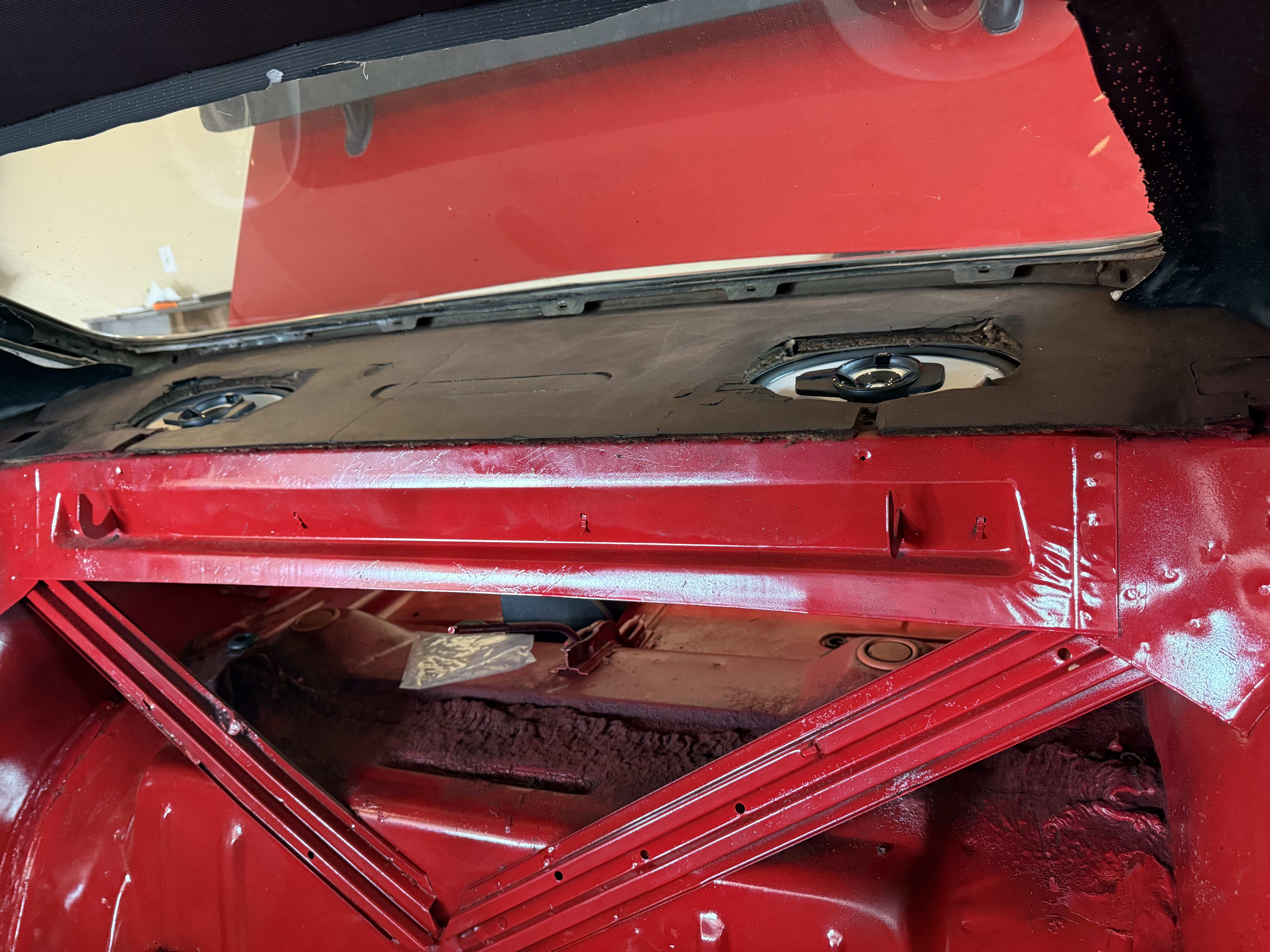

I used the R410Uk from Retrosound. It was a tight fit but worked. My speaker grill had to be persuaded (shoehorned) into place, but I think that may have been from being remanufactured.
https://www.amazon.com/dp/B00M9BC484?ref=ppx_yo2ov_dt_b_fed_asin_title&th=1

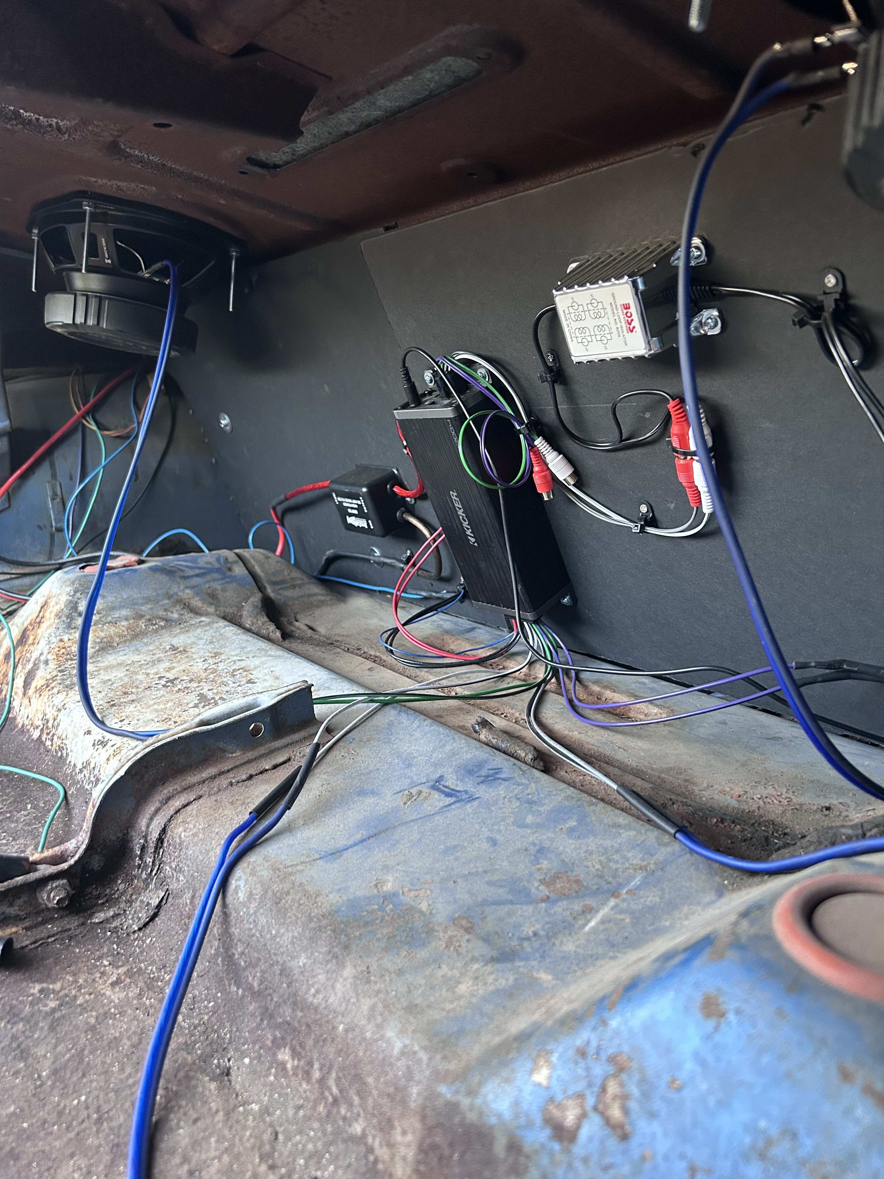

For the rear speakers, I went with the JVC speakers.
https://www.amazon.com/dp/B07P6RV67L?ref=ppx_yo2ov_dt_b_fed_asin_title
I am using the Classic Car Stereo I got from Classic Industries.
https://www.classiccarstereos.com/1...SlqKshDWpwhD_WONjCcvzyxXkJWhYXE4aAhnPEALw_wcB

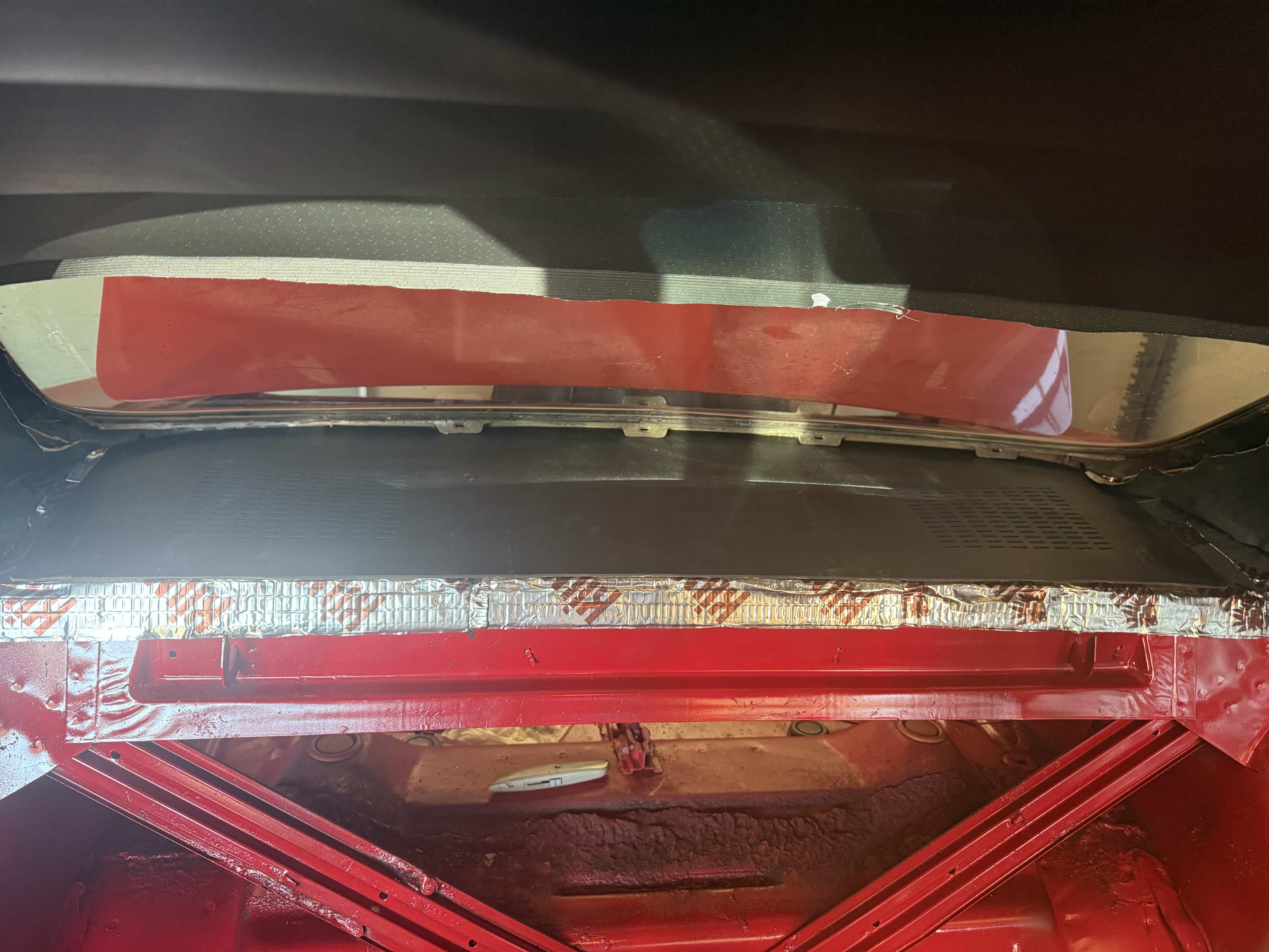

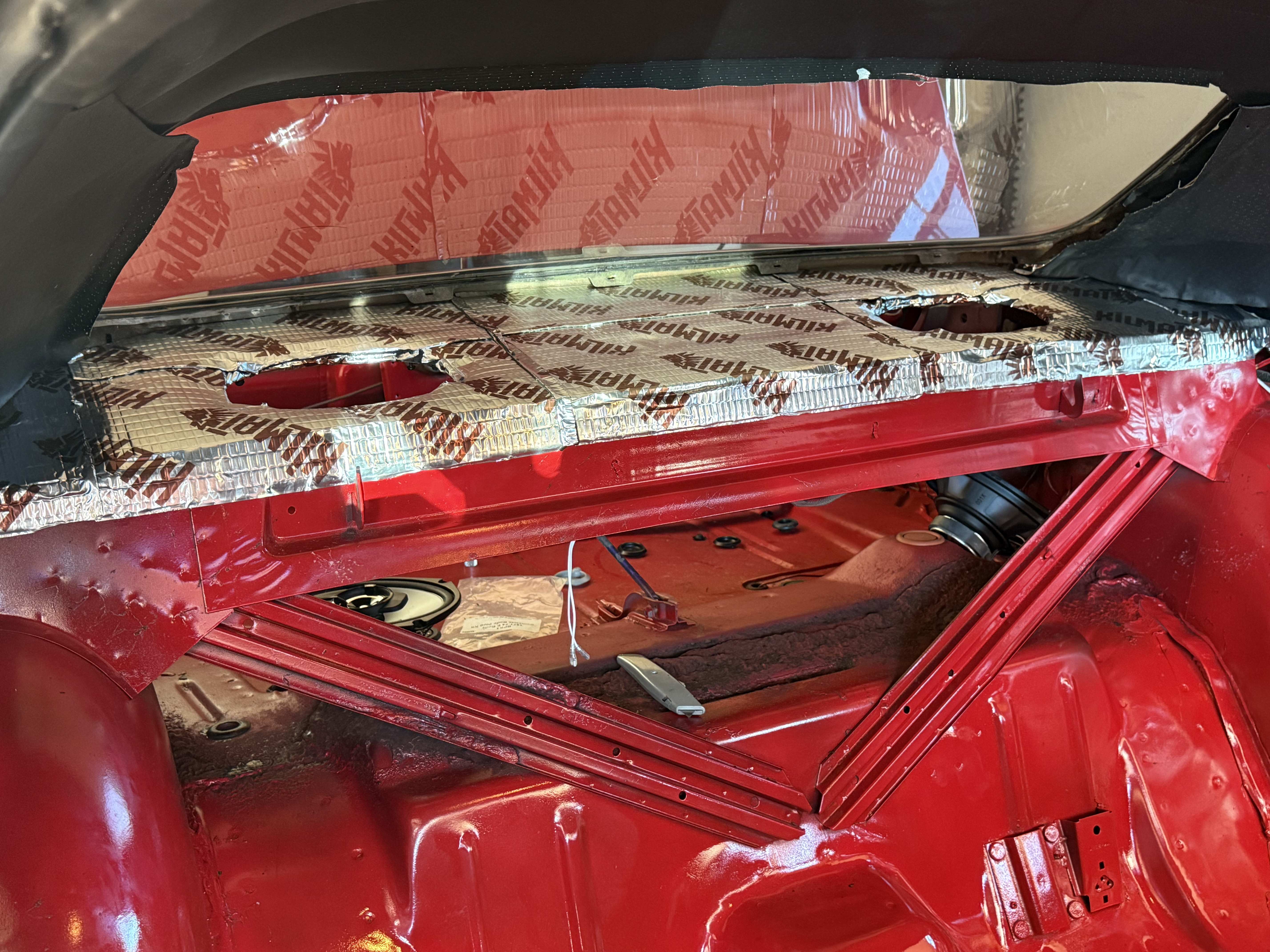

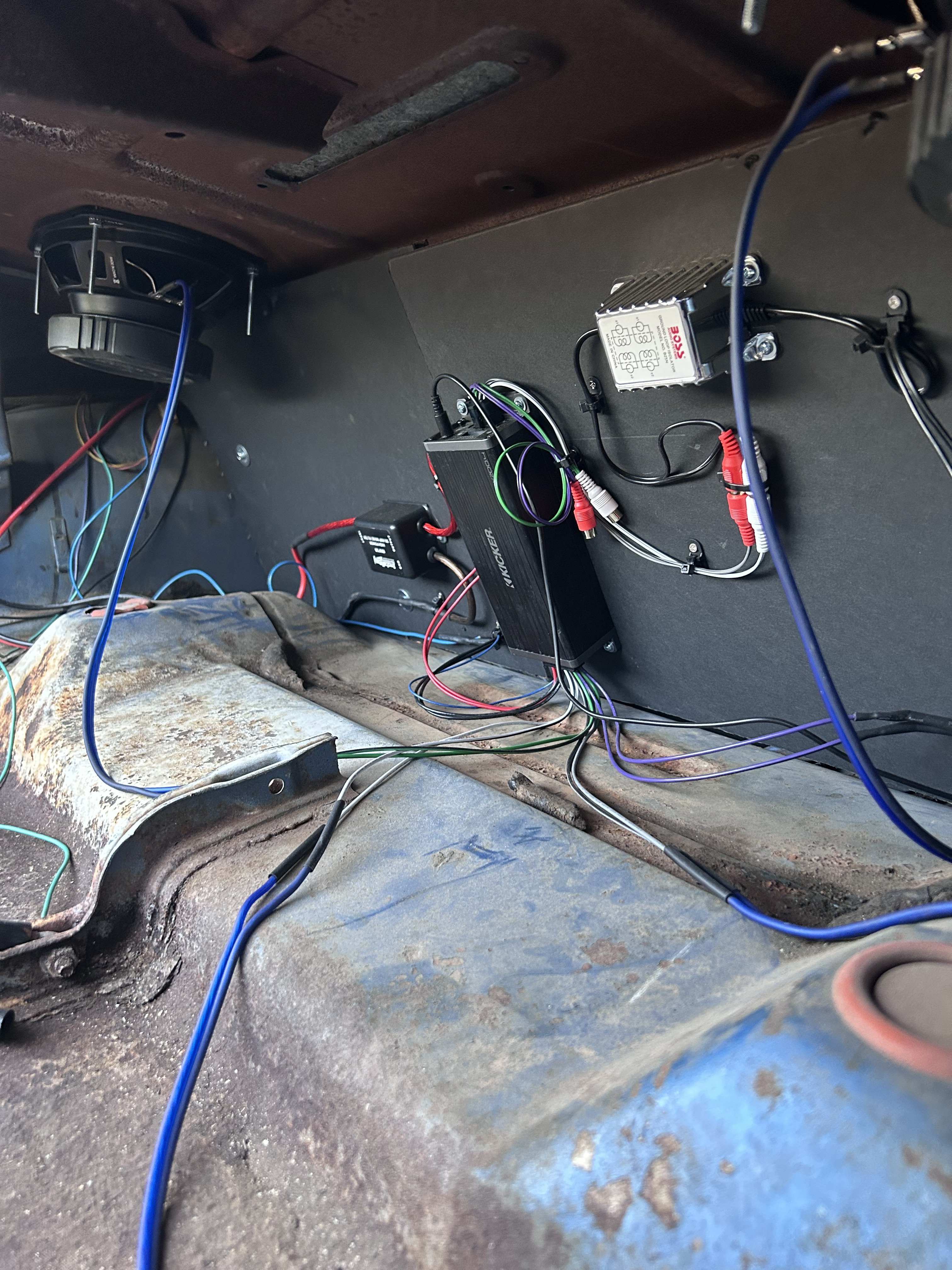

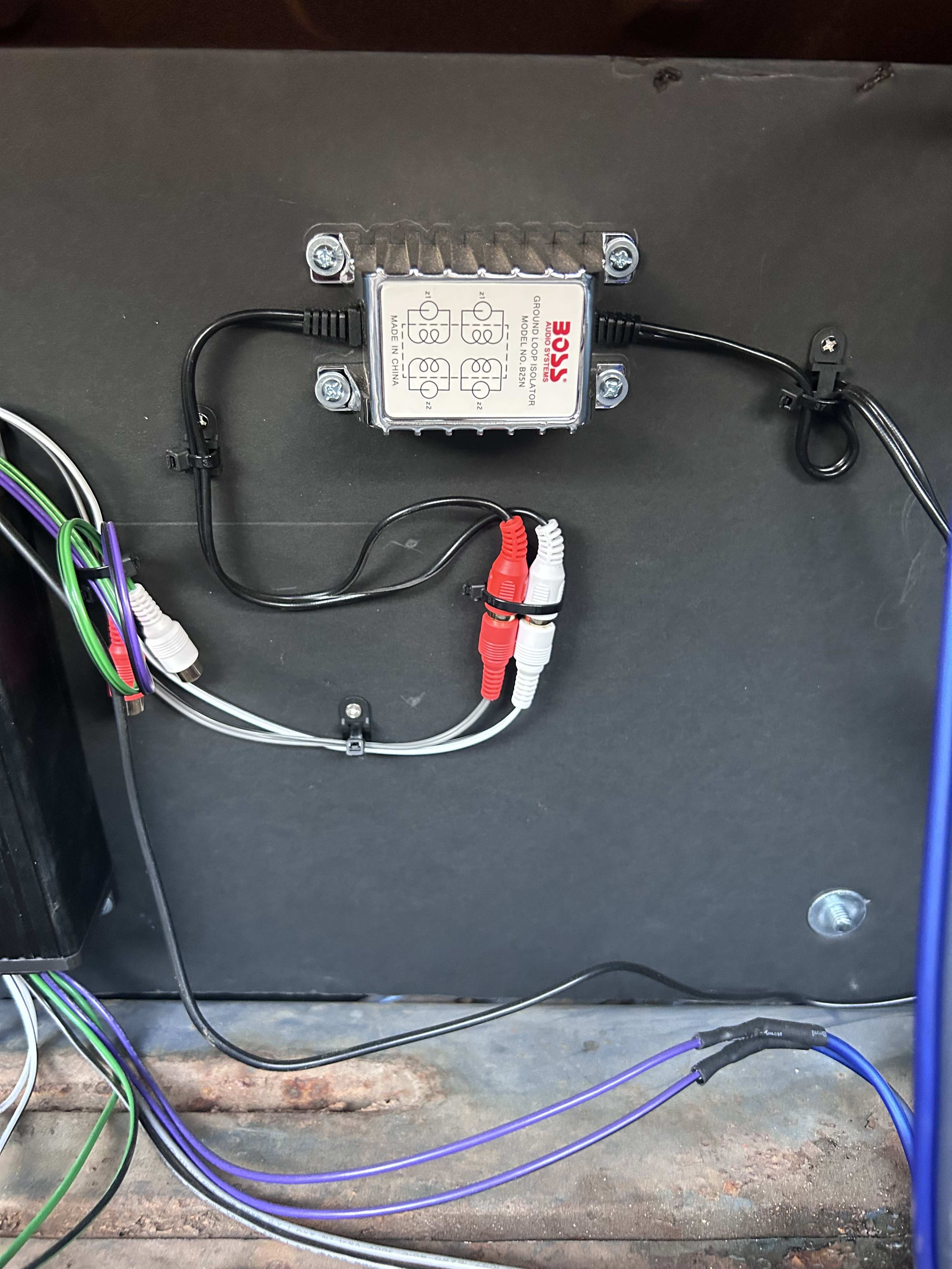

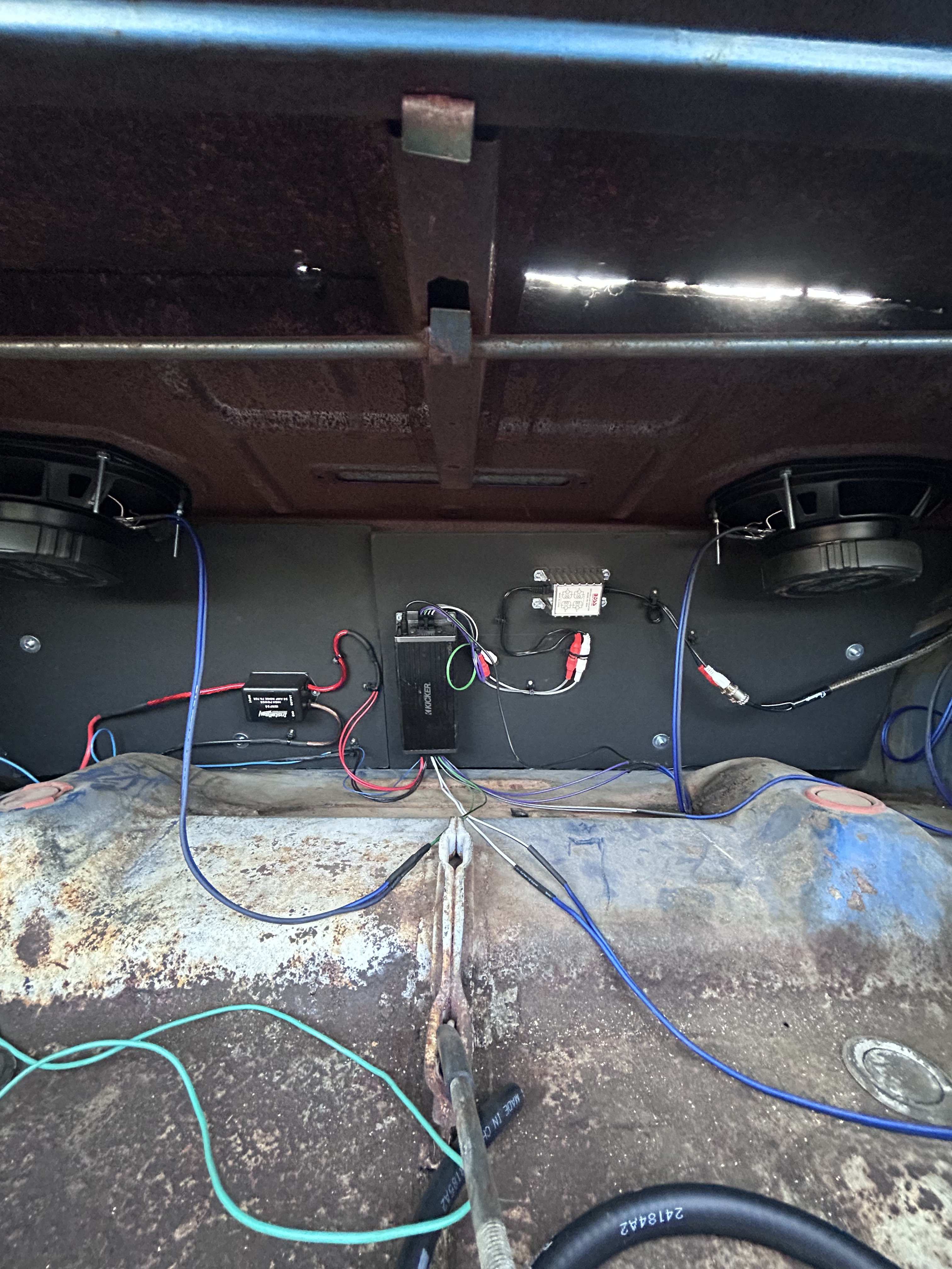

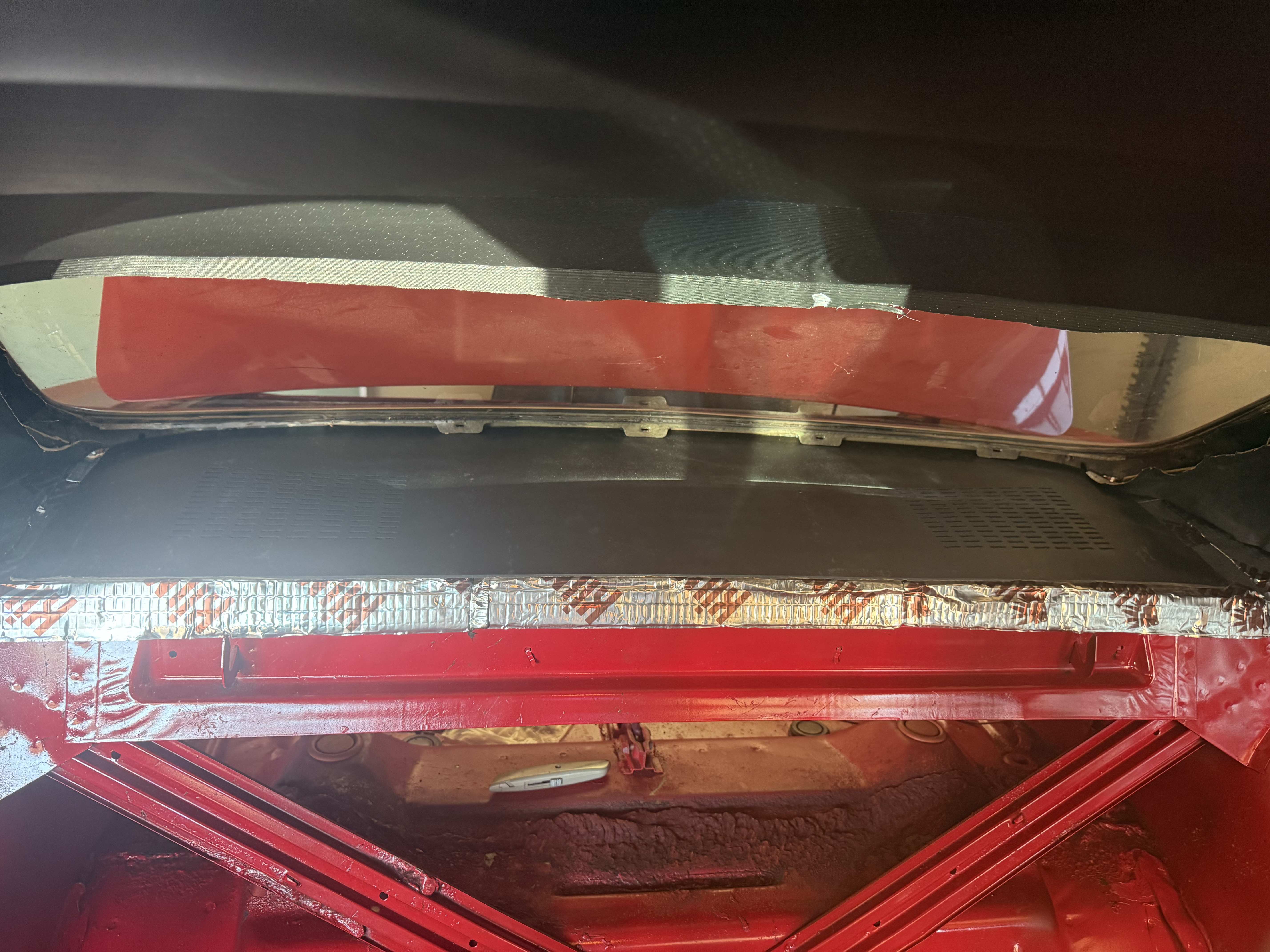

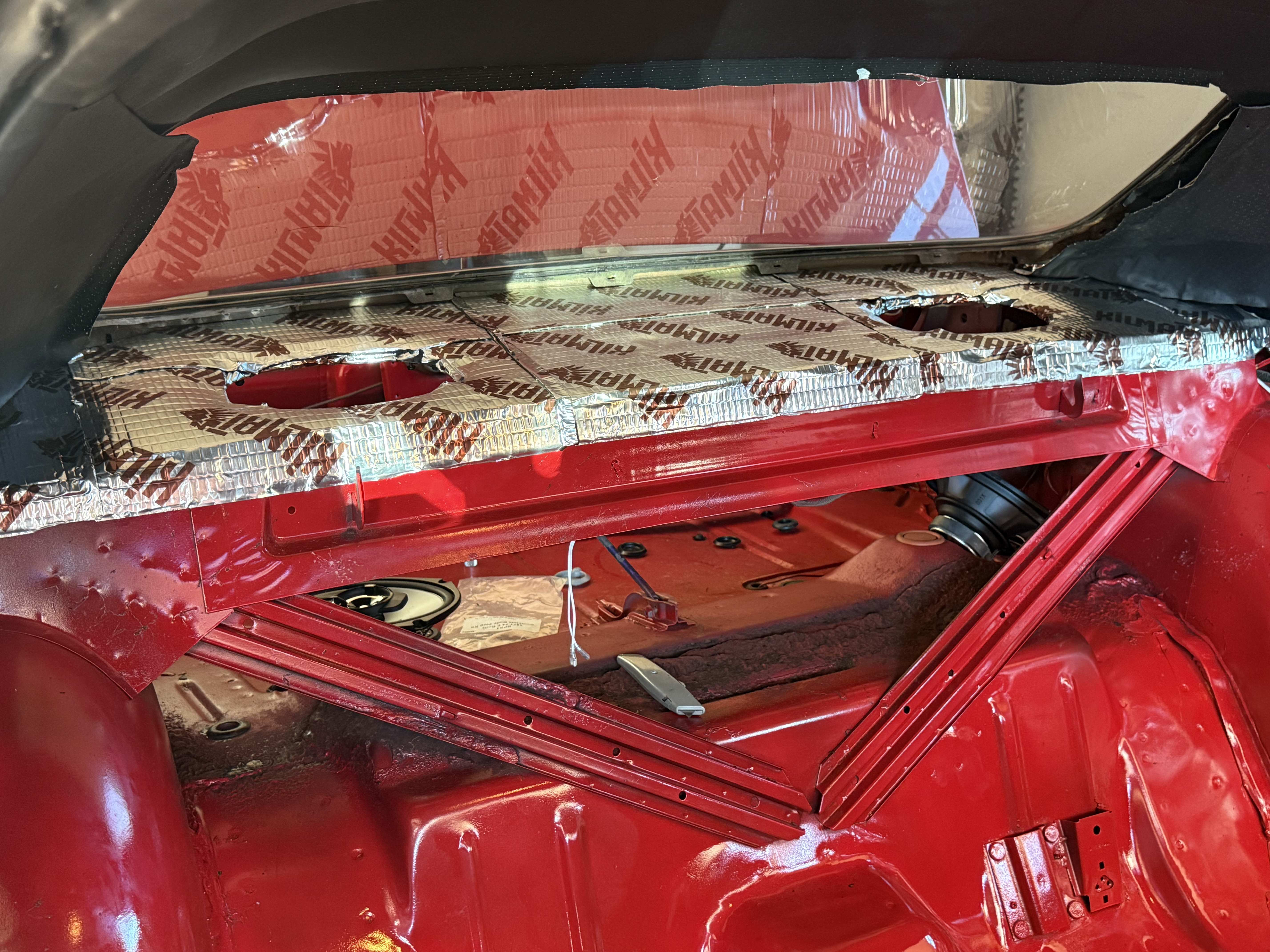

When I went over my package tray board and insulation with Kilmat, it made a HUGE difference. Of course, it is still a 1971 vehicle, but there's no reverberation with the speakers bouncing off the metal package tray. It made all the difference in the world and the speakers actually sound good.

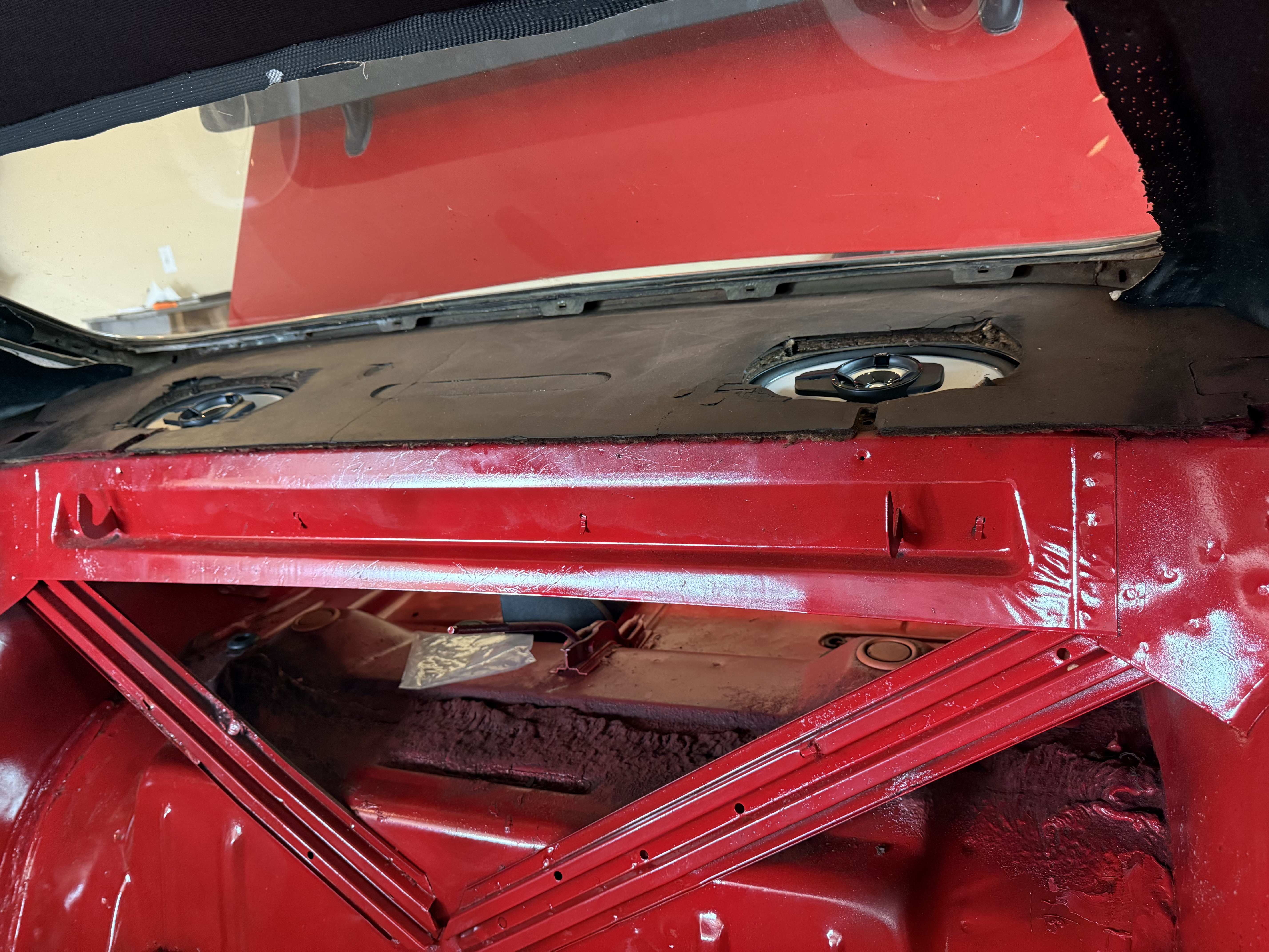

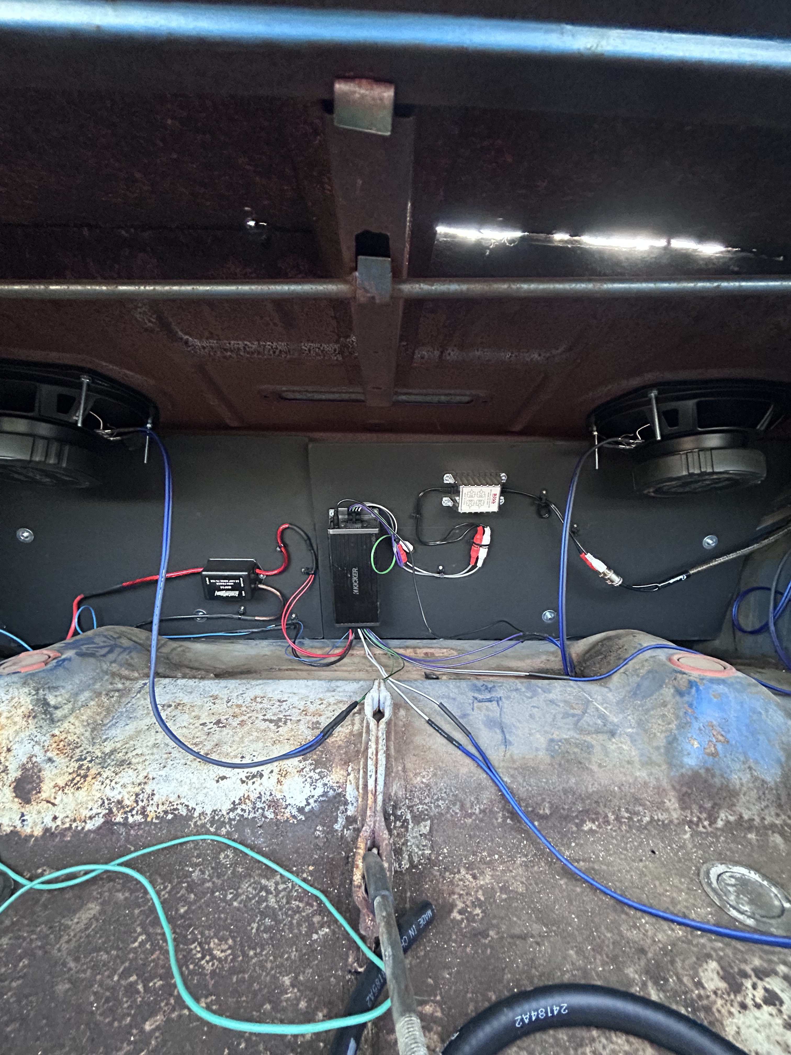

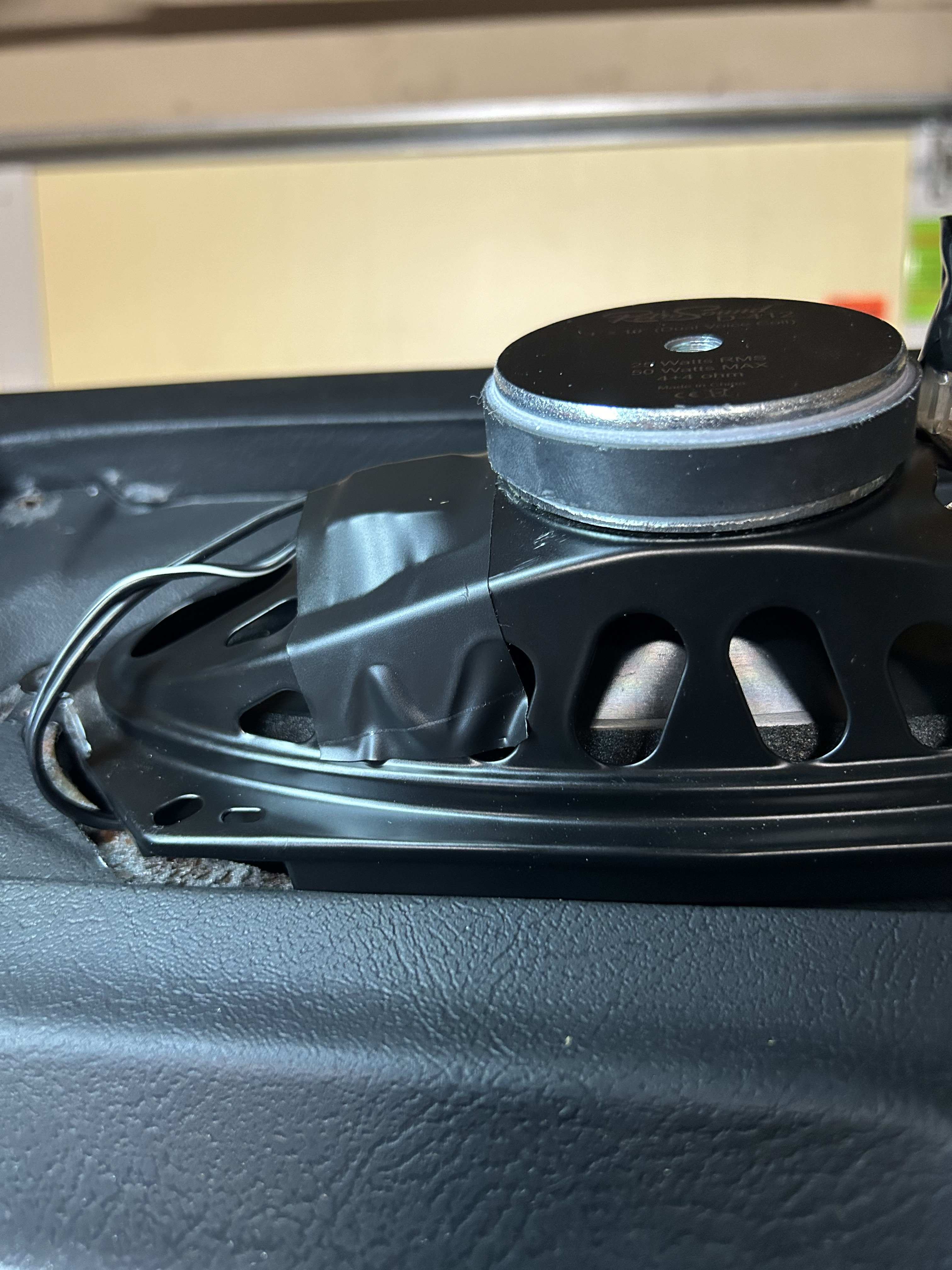

Olacmot
Dec 5, 2022
78
36
Scottsdale

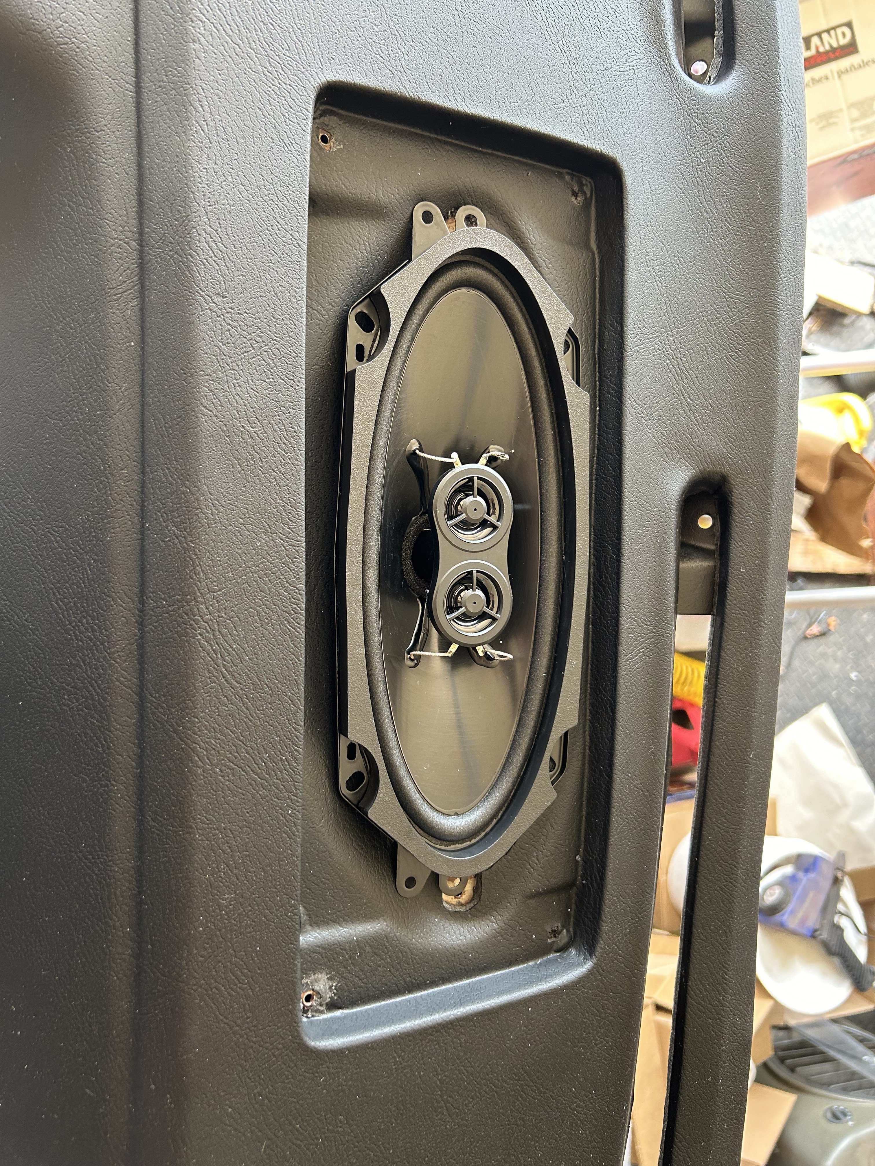

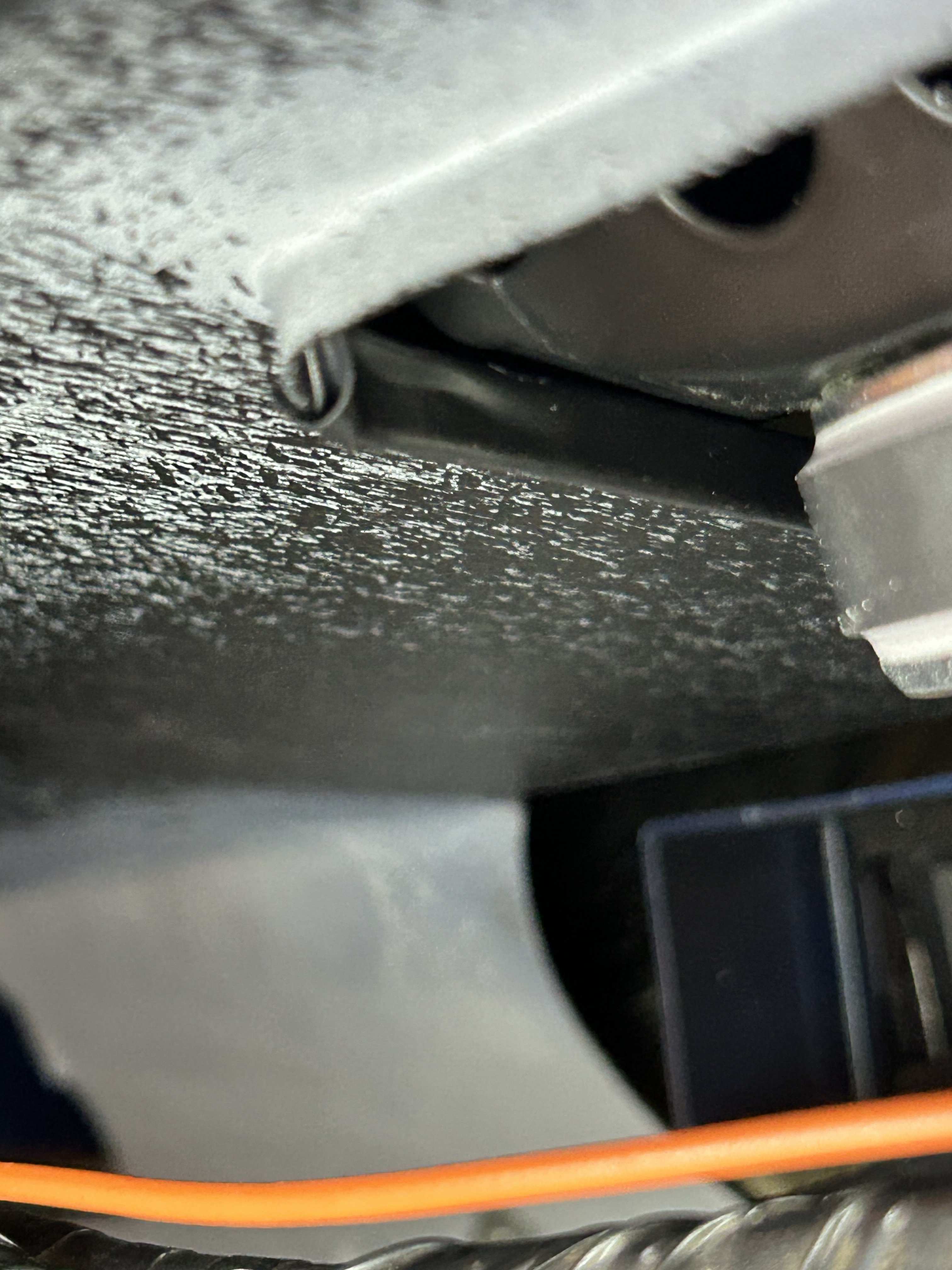

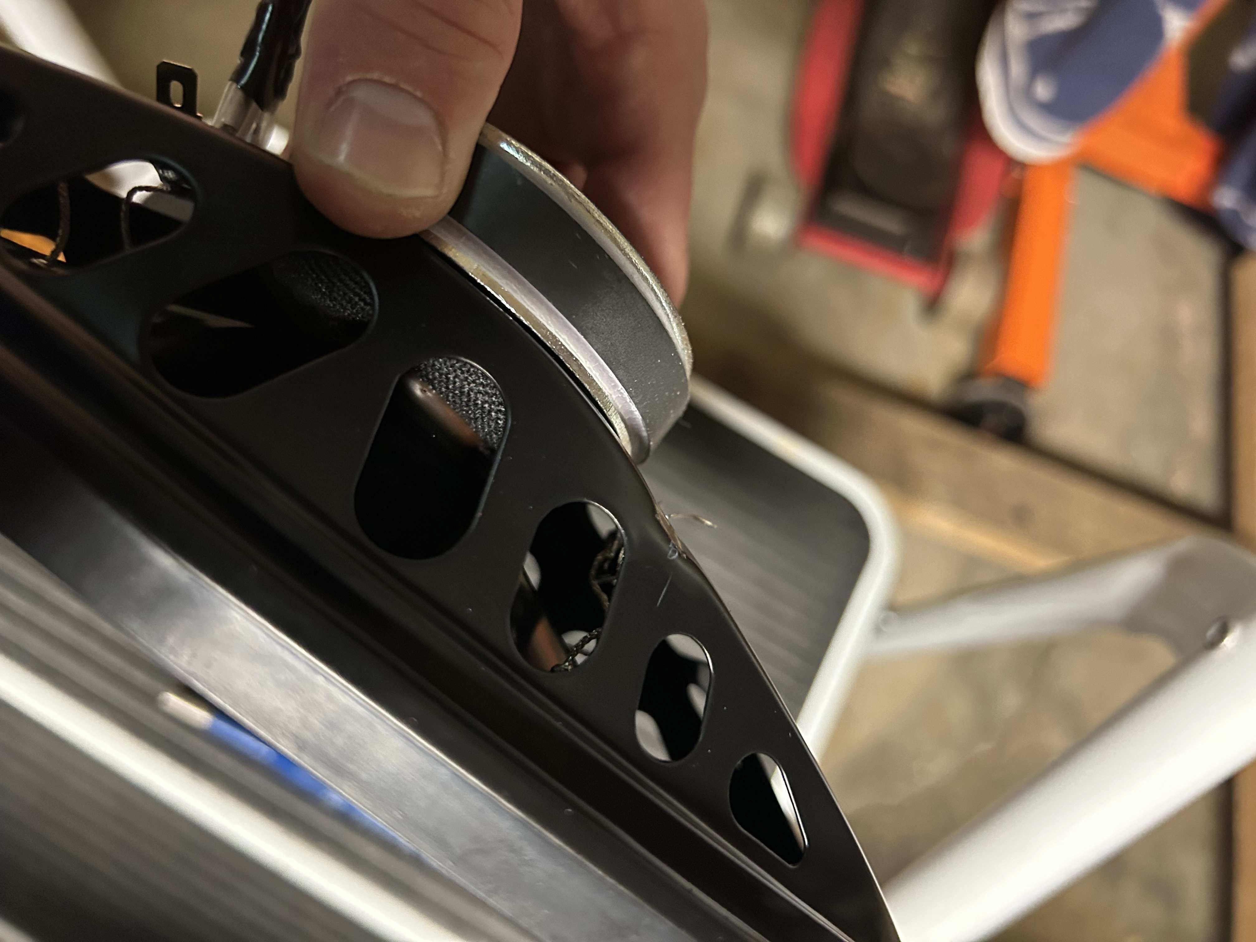

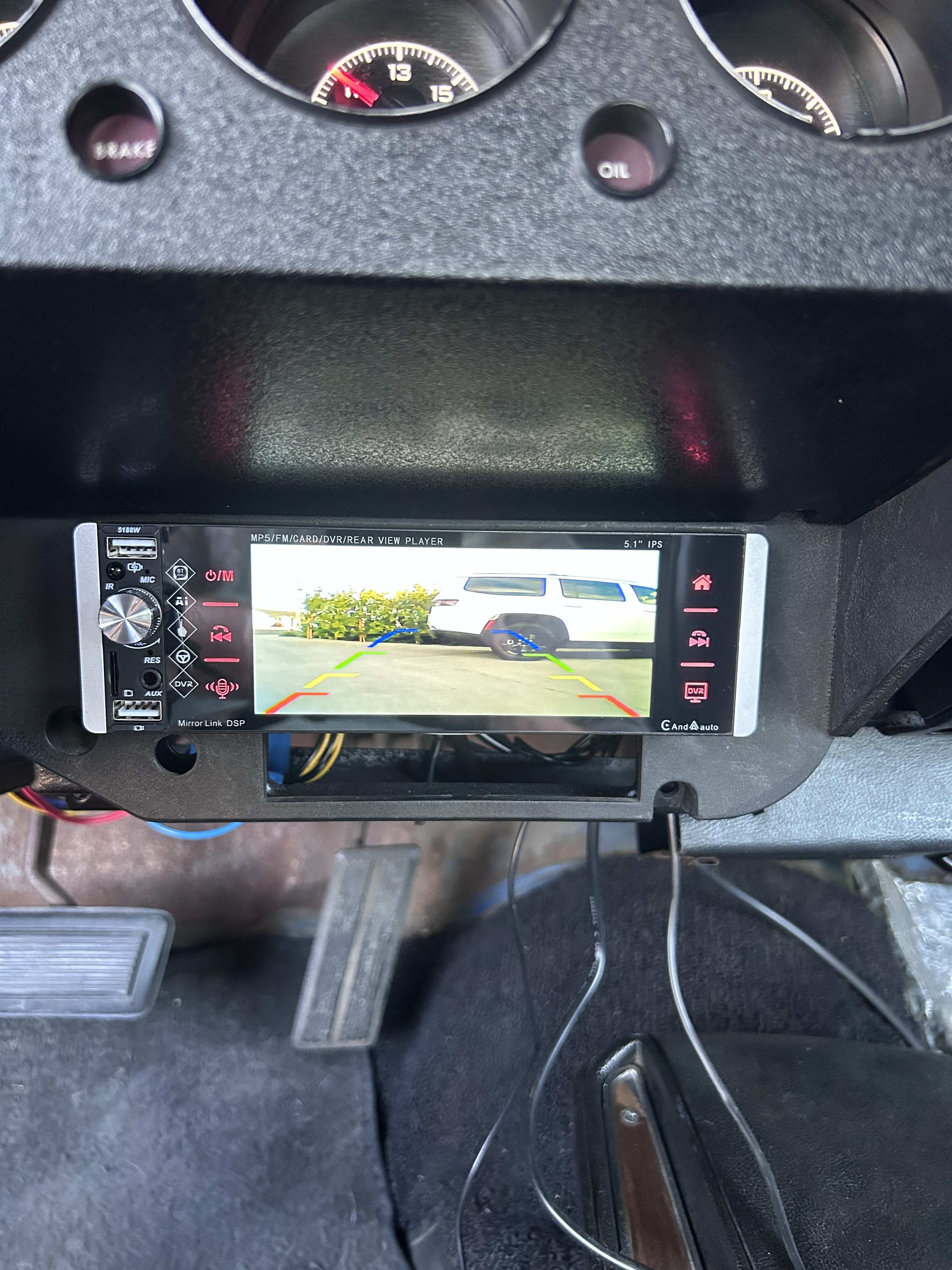

I took all of your advice and made this fit. I took a punch and hammer and bent the speaker’s frame in one spot to bend it down to get the smallest amount of clearance from the dash frame. You can see the dent I made and the clearance in the last two pics here.
I also had to trim two of the speaker grill stand offs to make it sit more flush, then used electrical tape to insulate the passenger side terminals for the speaker so they wouldn’t ground out.

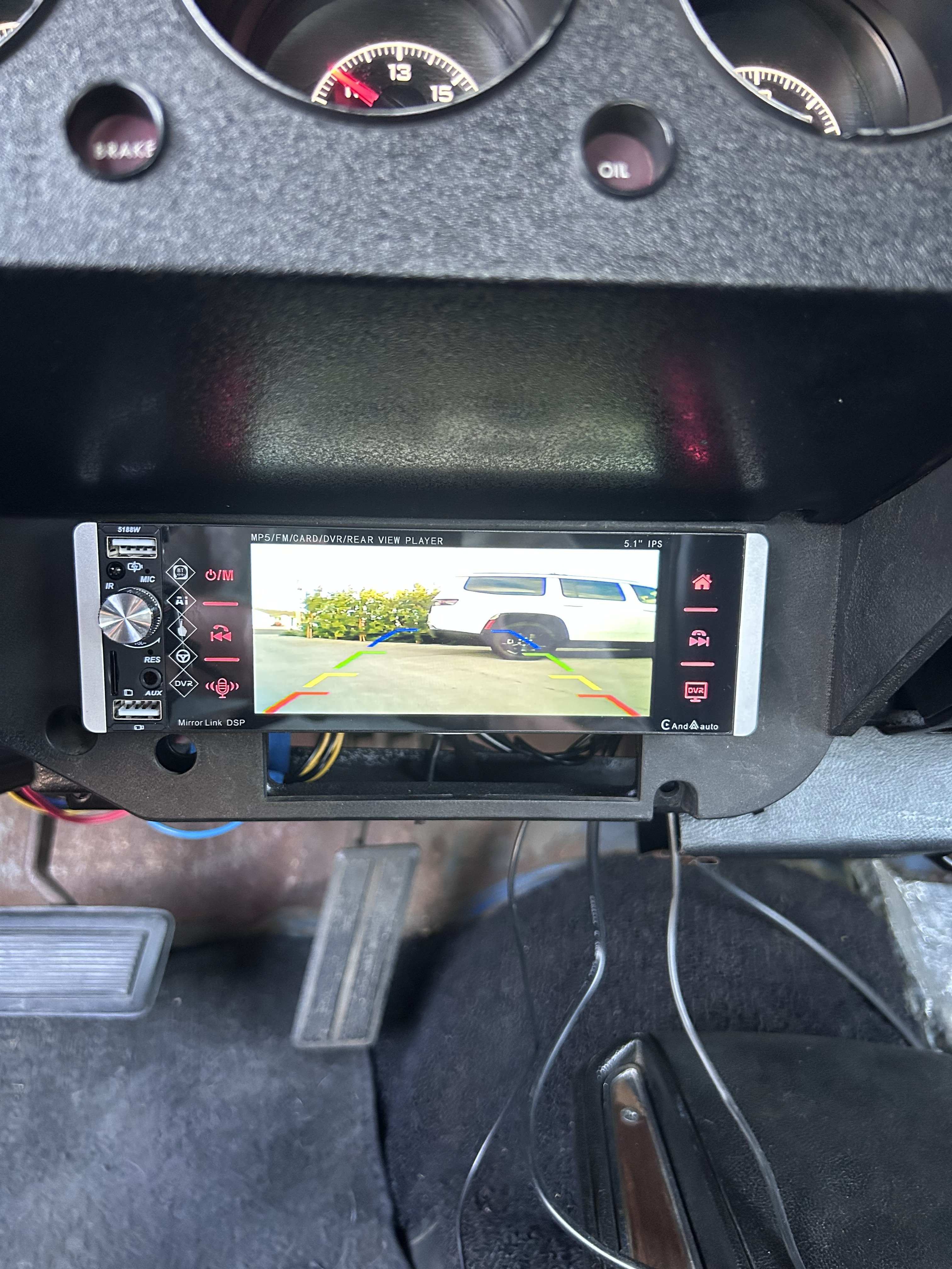

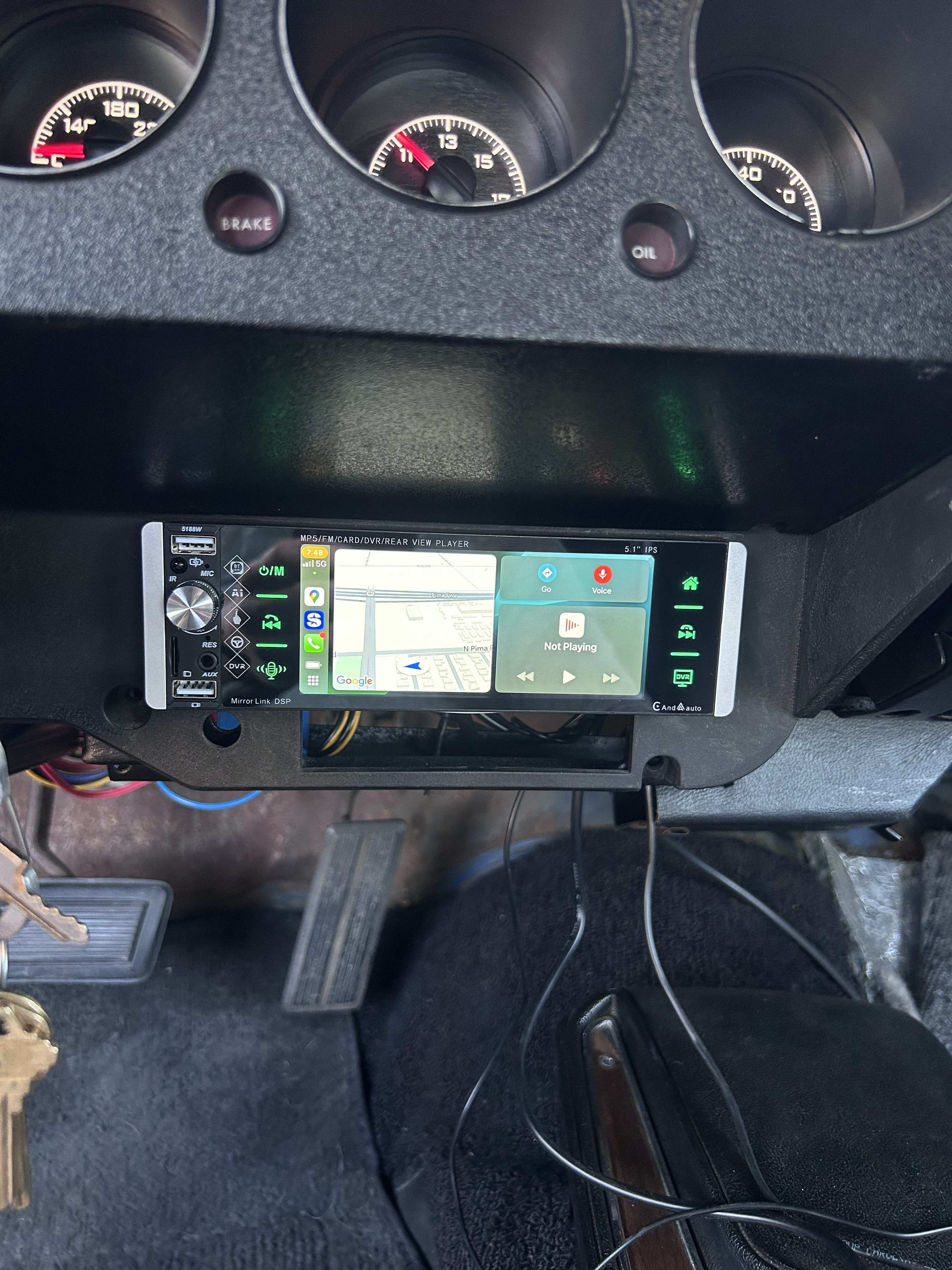

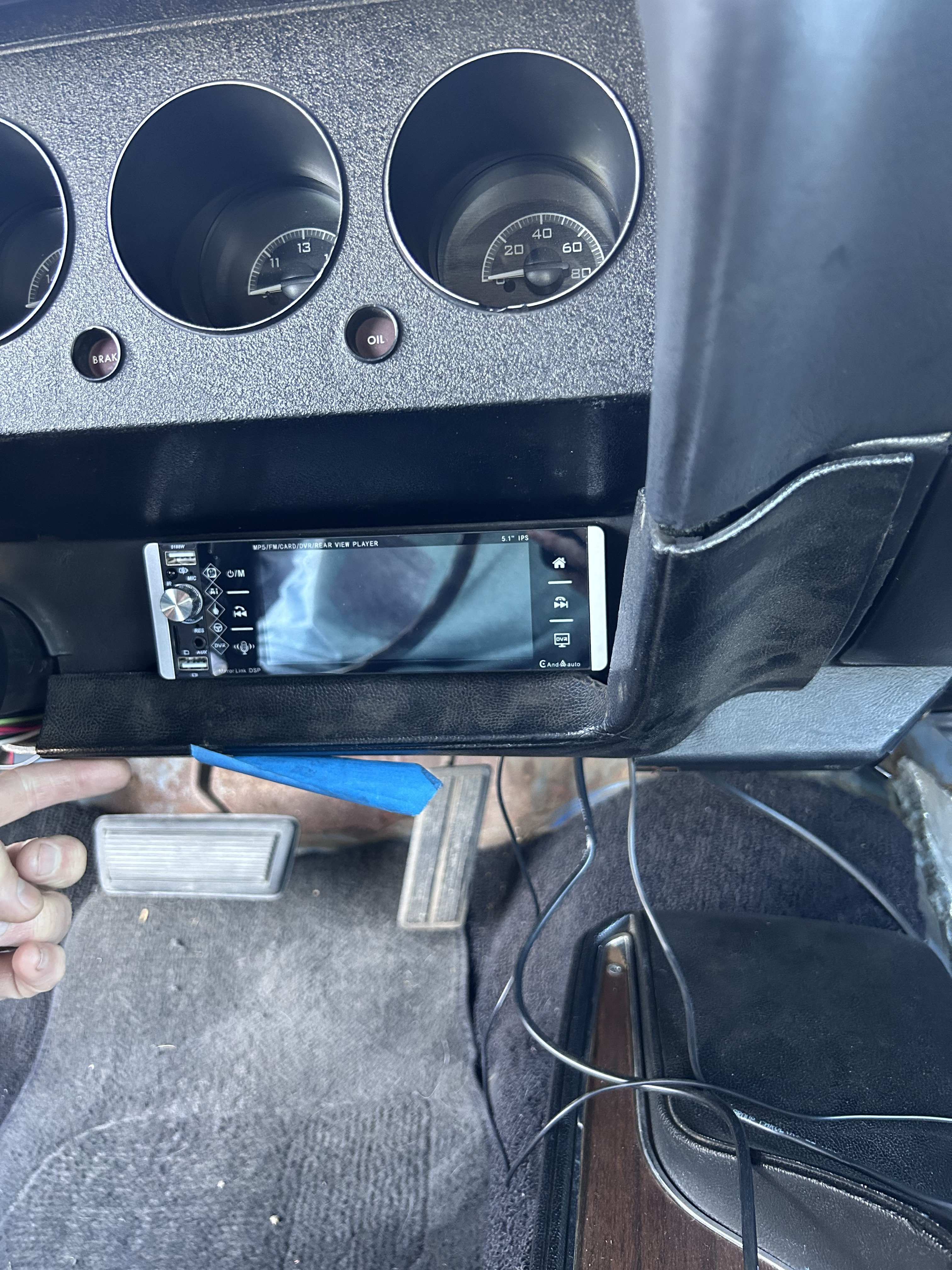

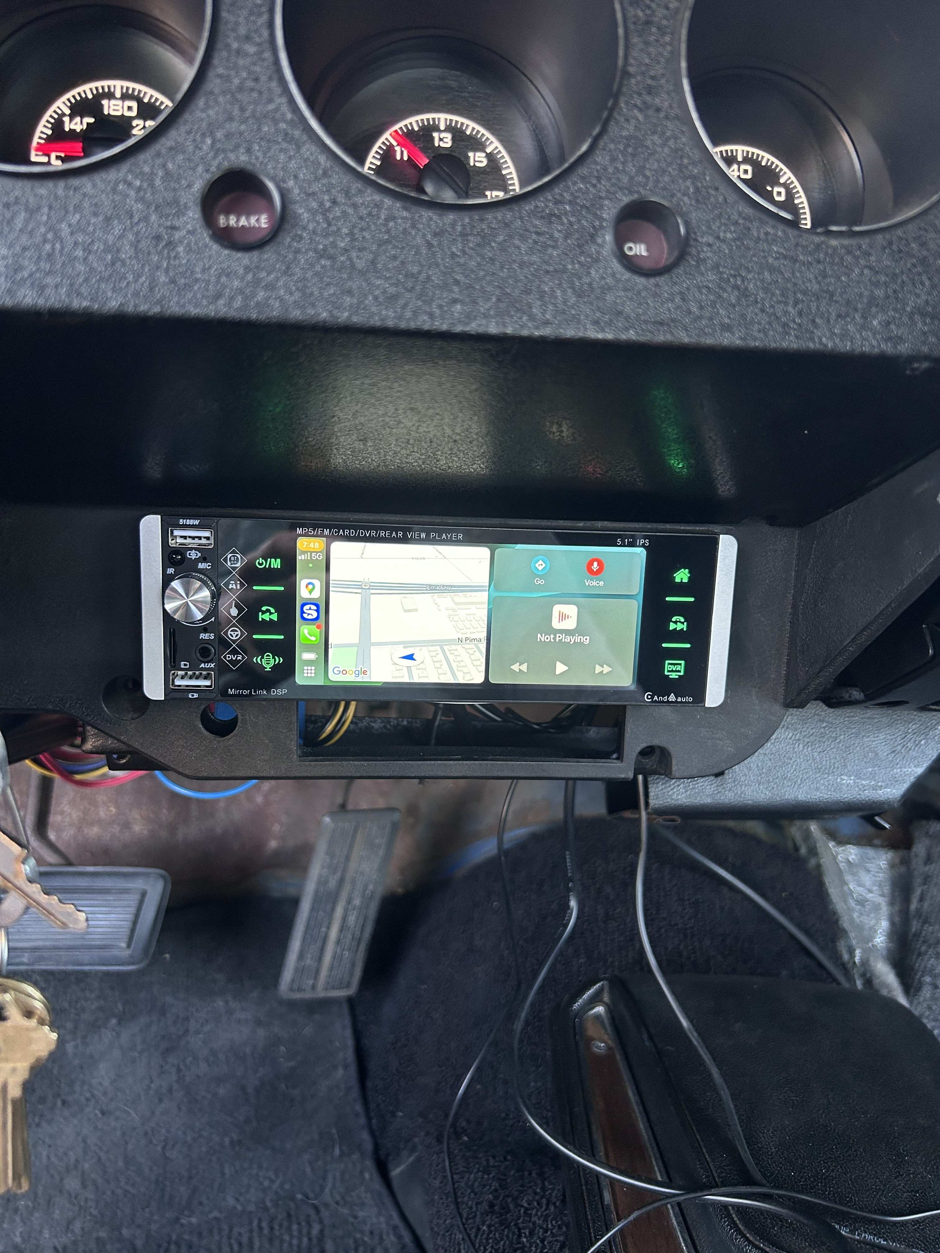

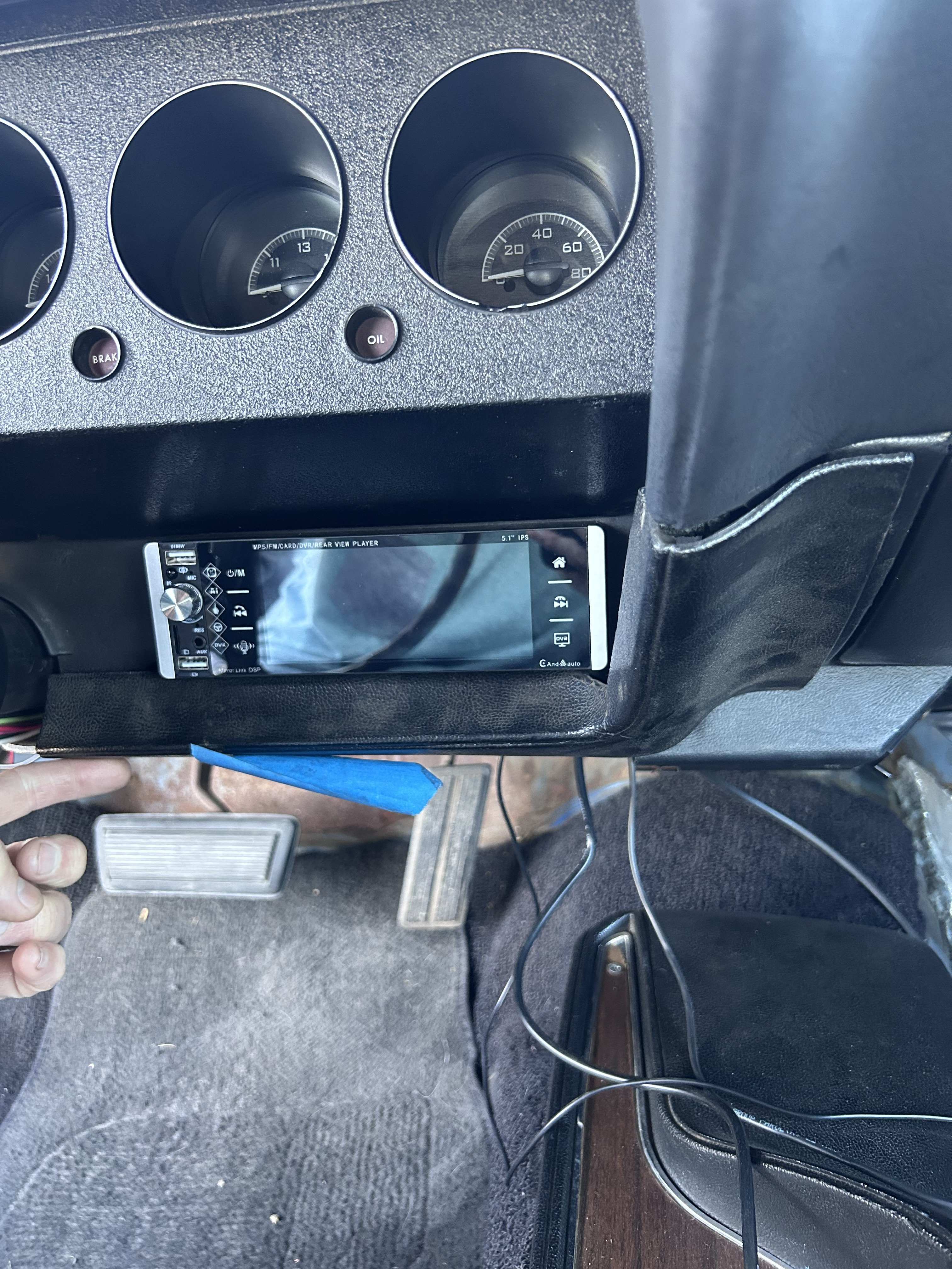

I haven’t splurged on a stereo or rear speakers yet. I was thinking about trying a cheap single din stereo off amazon that has a back up camera capability, but I’m saving that project for later once the car is running again.
I’m satisfied with the fit! I’ll definitely do the kill mat once I get to the rear speakers. I remember them rattling really bad 20 years ago when this was my daily… the speakers would rattle rust out of the back window each time I turned it up 🤣 😳
