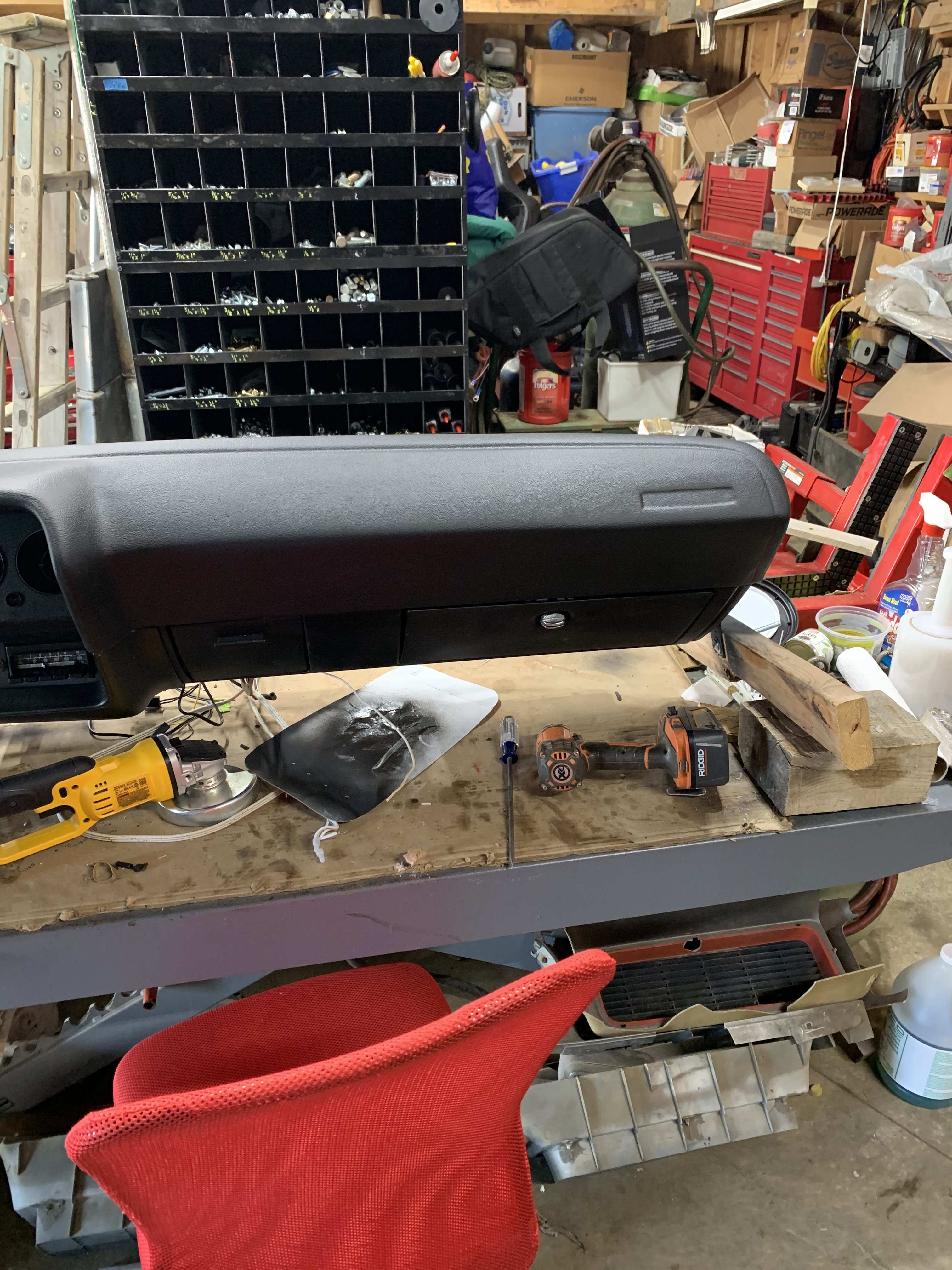

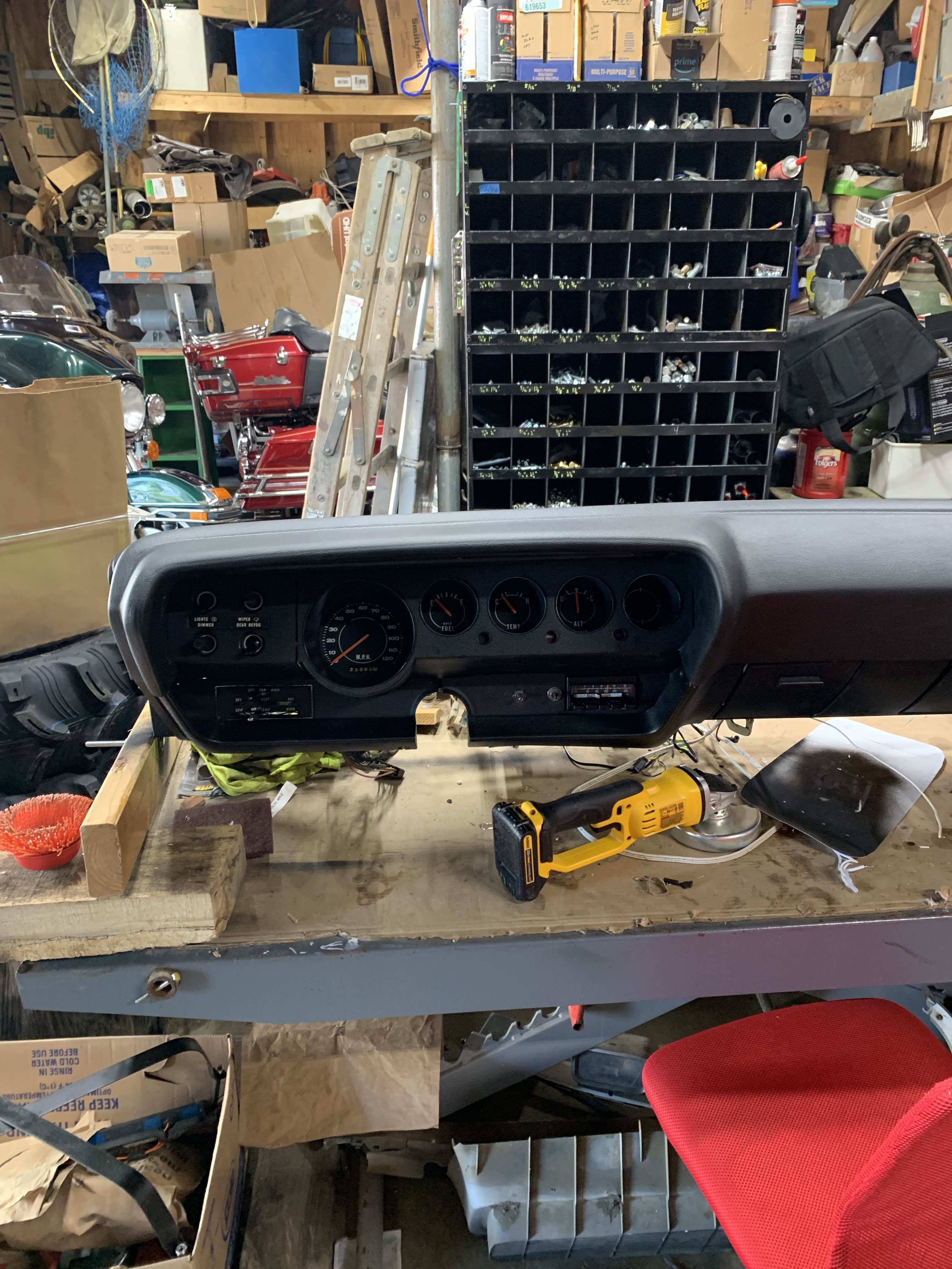

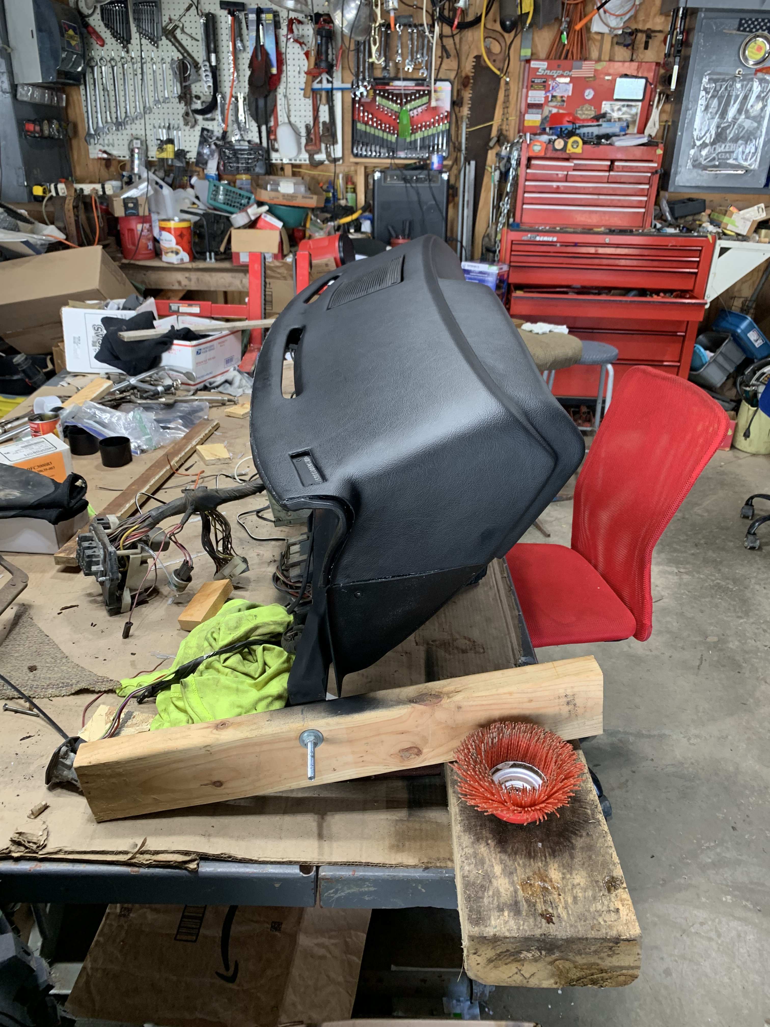

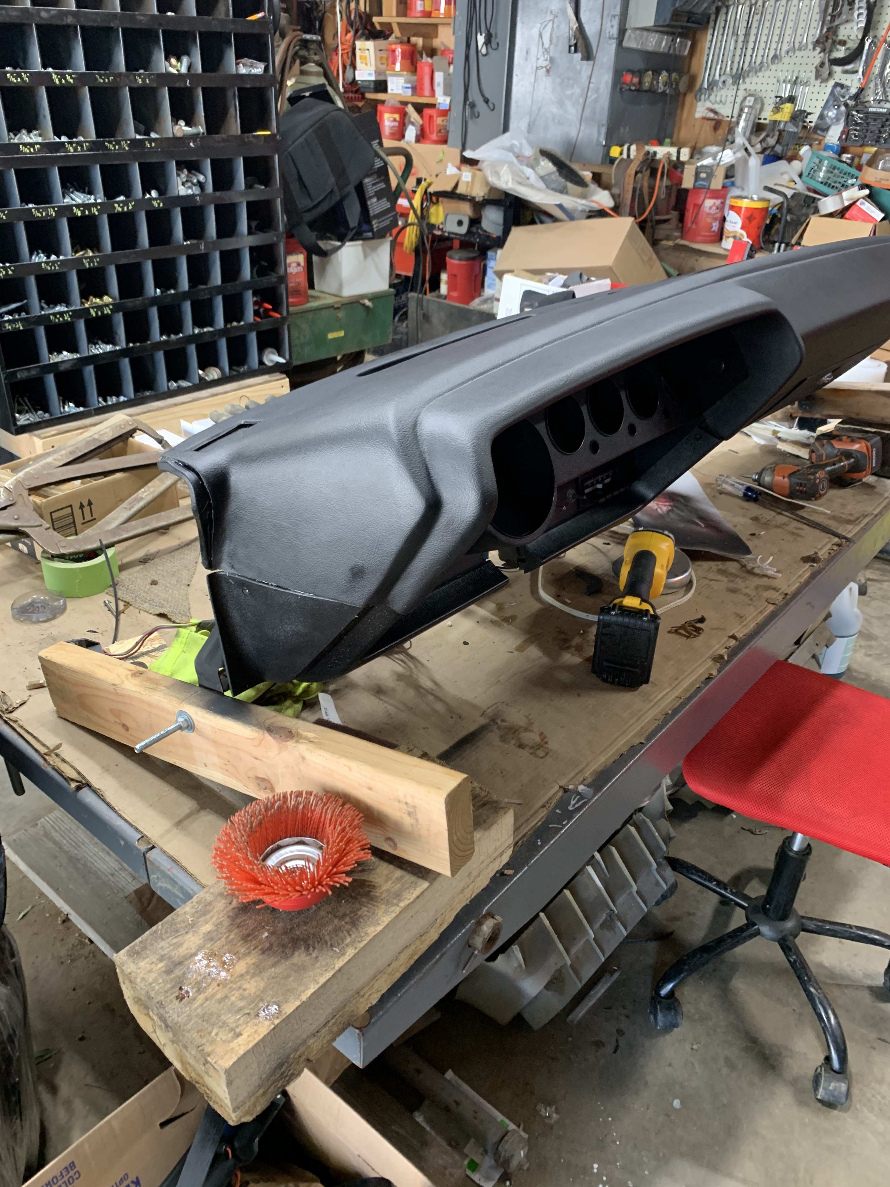

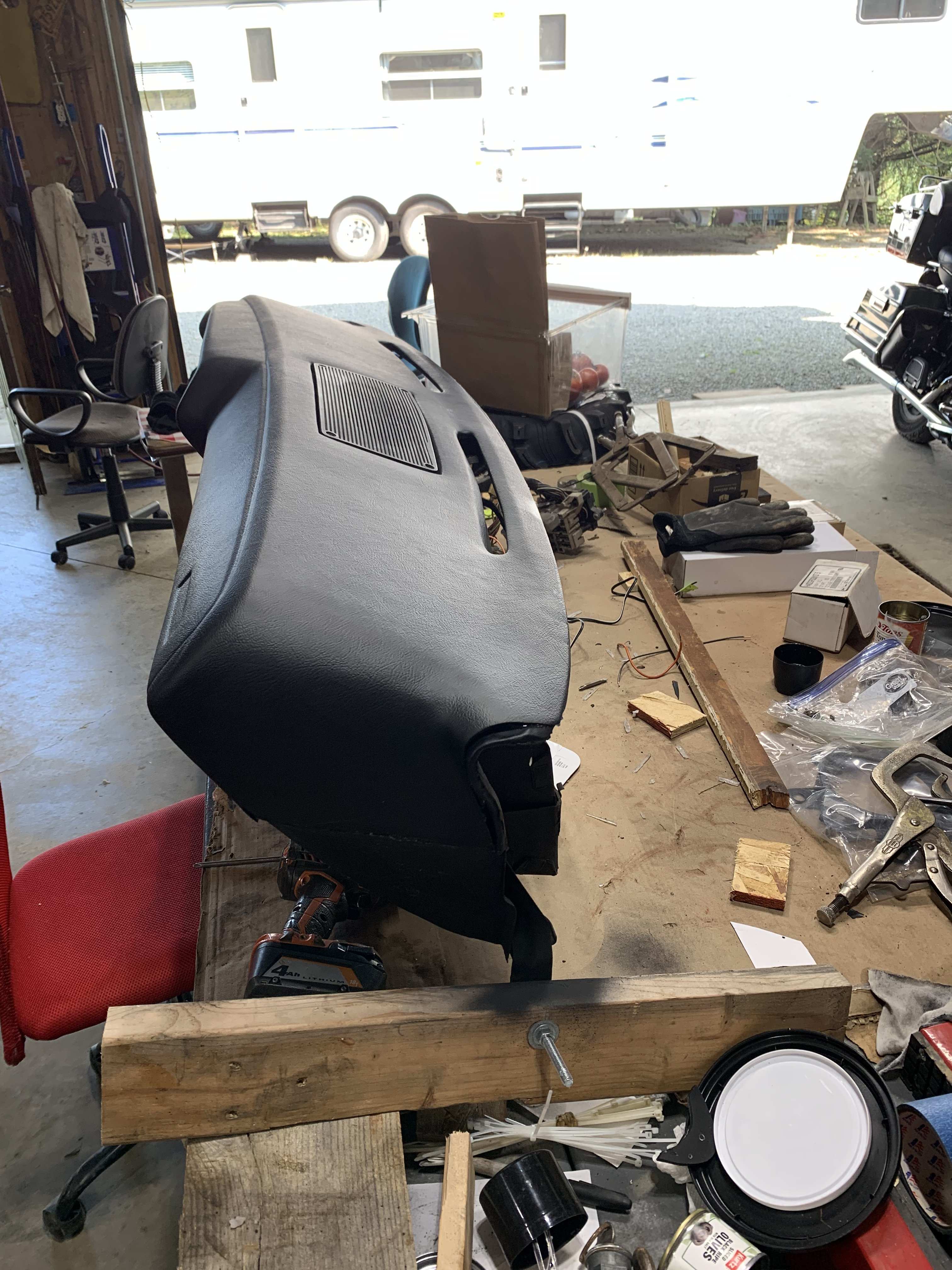

update , i almost have my cap installed. i did it one area at a time . after trimming the high areas and filling in some lows and cracks in the base foam . i’m actually happy with the results. looks darn good for the time and money invested. a few small flaws but will work fine until i locate a new pad….i stated by dry fitting and trimming any high spots , clamping for a good fit useing vise grip c clamps of all sizes and wooden blocks against the cap to distribute pressure. un clamped the windshield side of cap and silicone glued vent and vin tag areas . clamped and let cure 48 hours . then un clamped opposite and sides of cap , applied glue about an inch from edges and re clamped the whole thing . again let cure 48 hours until i removed clamps . at the area above the glove box i used 2 ratchet straps and a wooden 1x2 to keep pressure there …

Nice!
I’ll say it again, the dash capped dash I took off looked better than what I got from the Texas guys.

Looks like a very nice job. Congratulations. Sometimes I think we try to make these original $4,000 cars too perfect.
