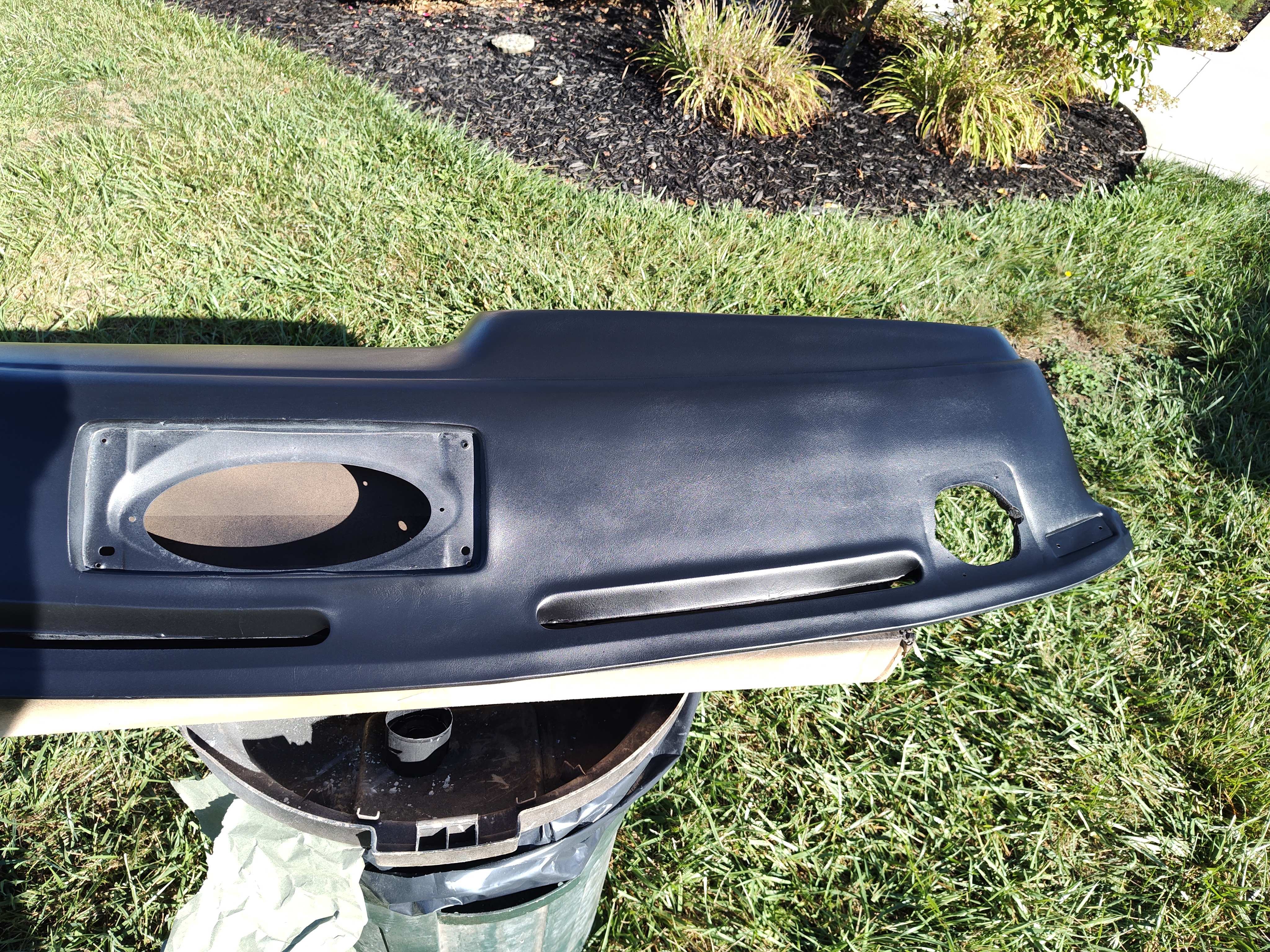

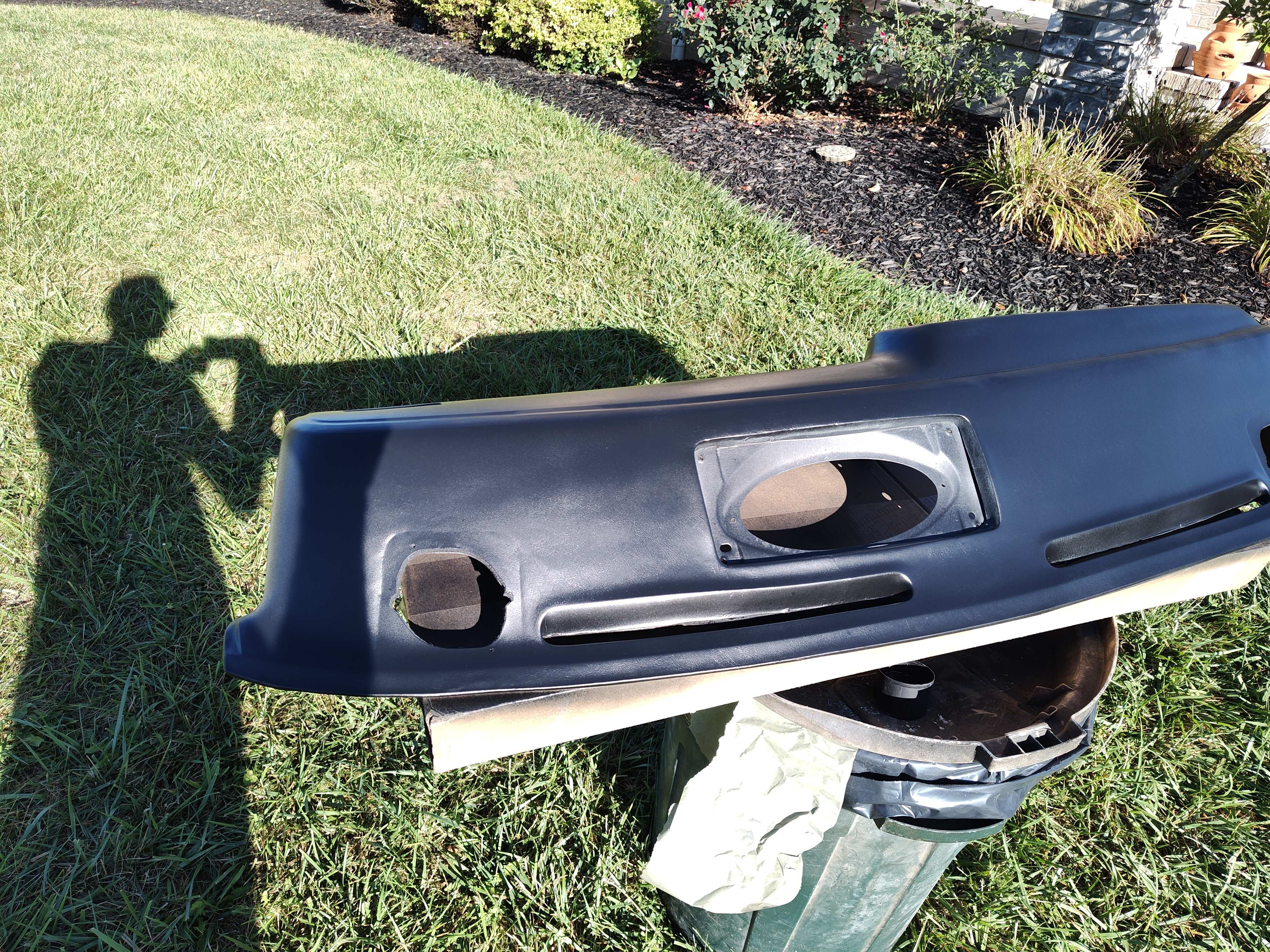

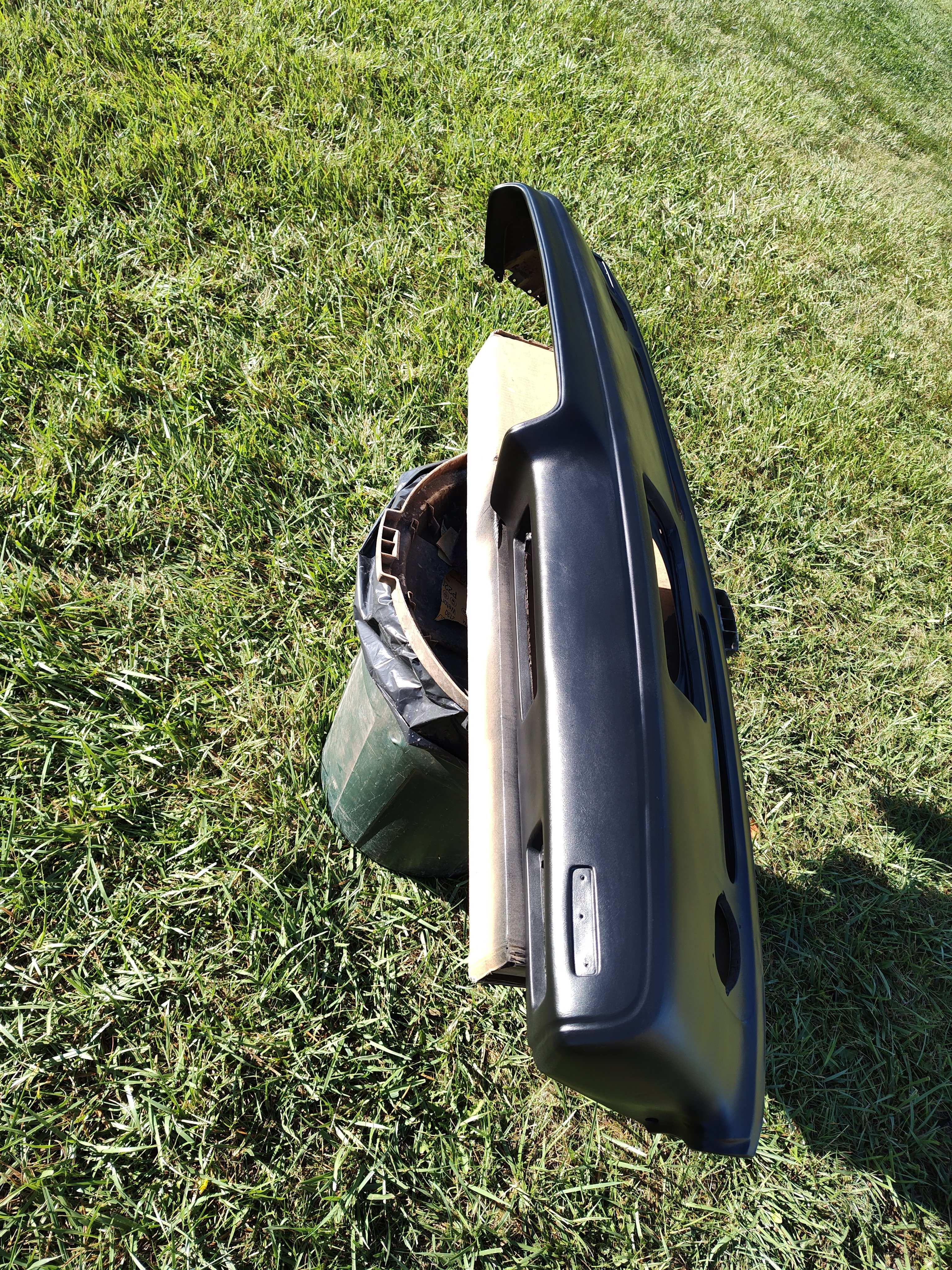

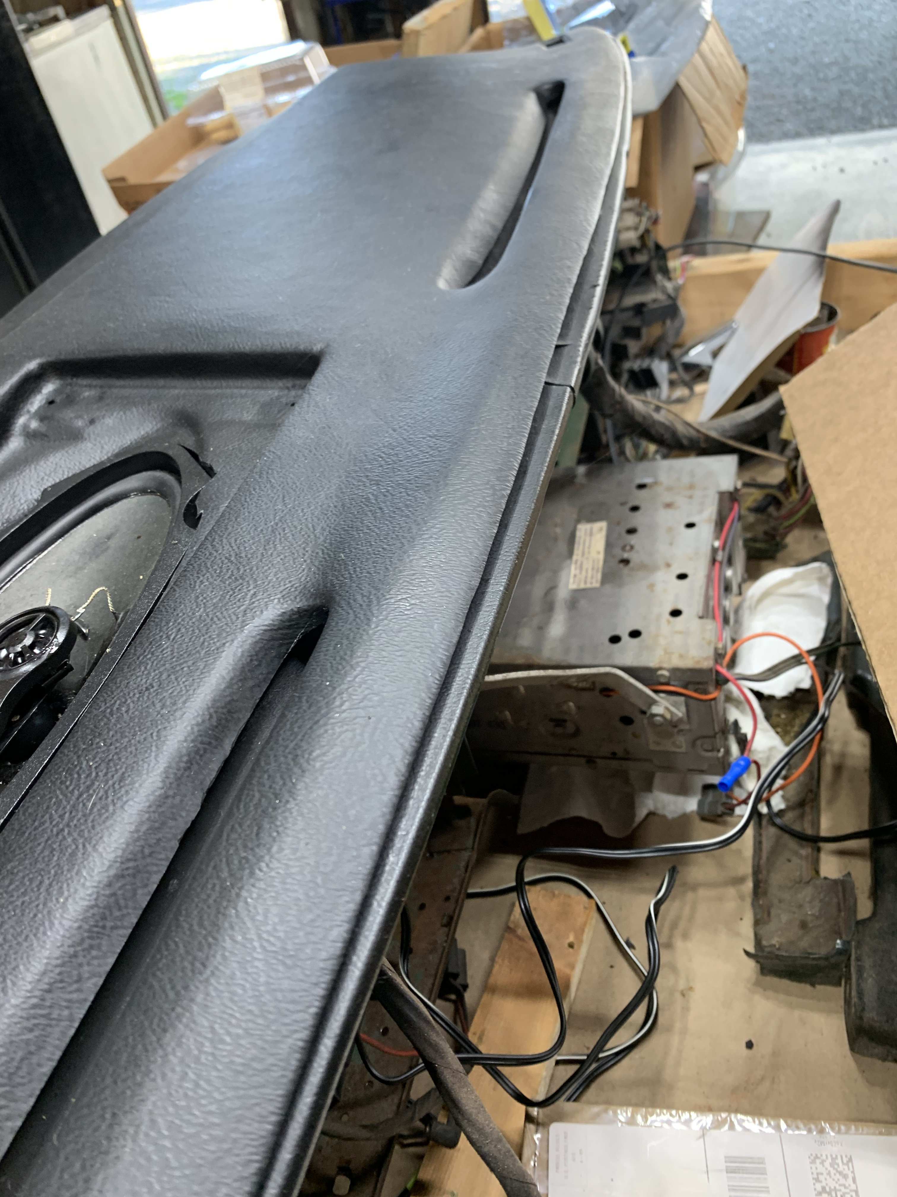

Cut the dash painted and clear coated with a matte finish. It actually looks a lot better than I expected. I was ready to pull the trigger on a replacement dash pad but I think call reconsider since this is an original pad. Either way it was an interesting exercise.

Oh this was a great exercise in owning light body work and interior skills. The car I'm building is fairly high dollar and I don't think I would be happy with the dash. I'm sure someone locally will snap this up since these are hard to come by. I put it in the sun and it has one soft spot

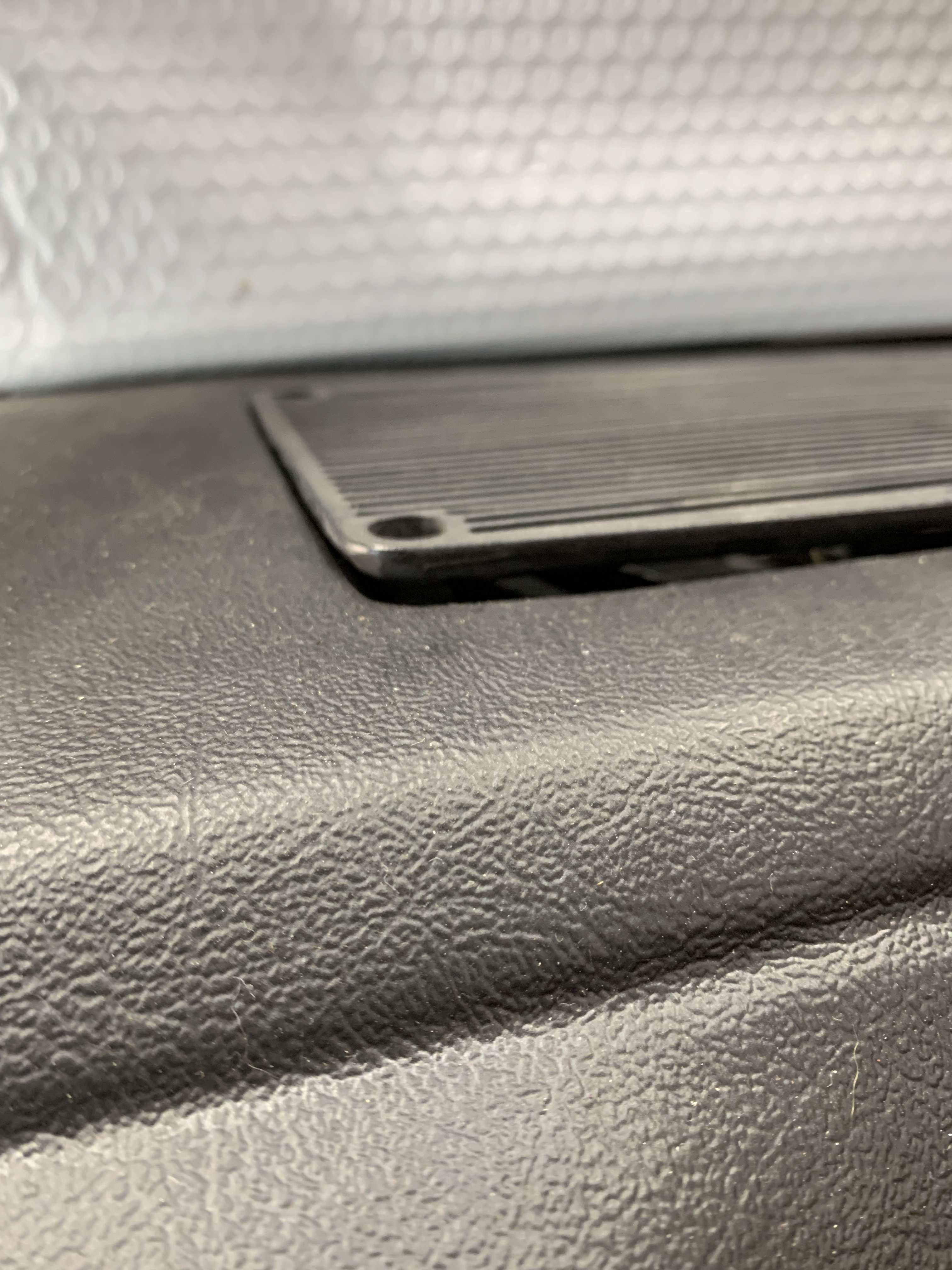

To finish up this thread I think that the repair technique would be fine for a few defects. I tried to repair a long segment right below the speaker and I had a total of 20 repairs on that dash. Most are well hidden and blended but it was an interesting experience.

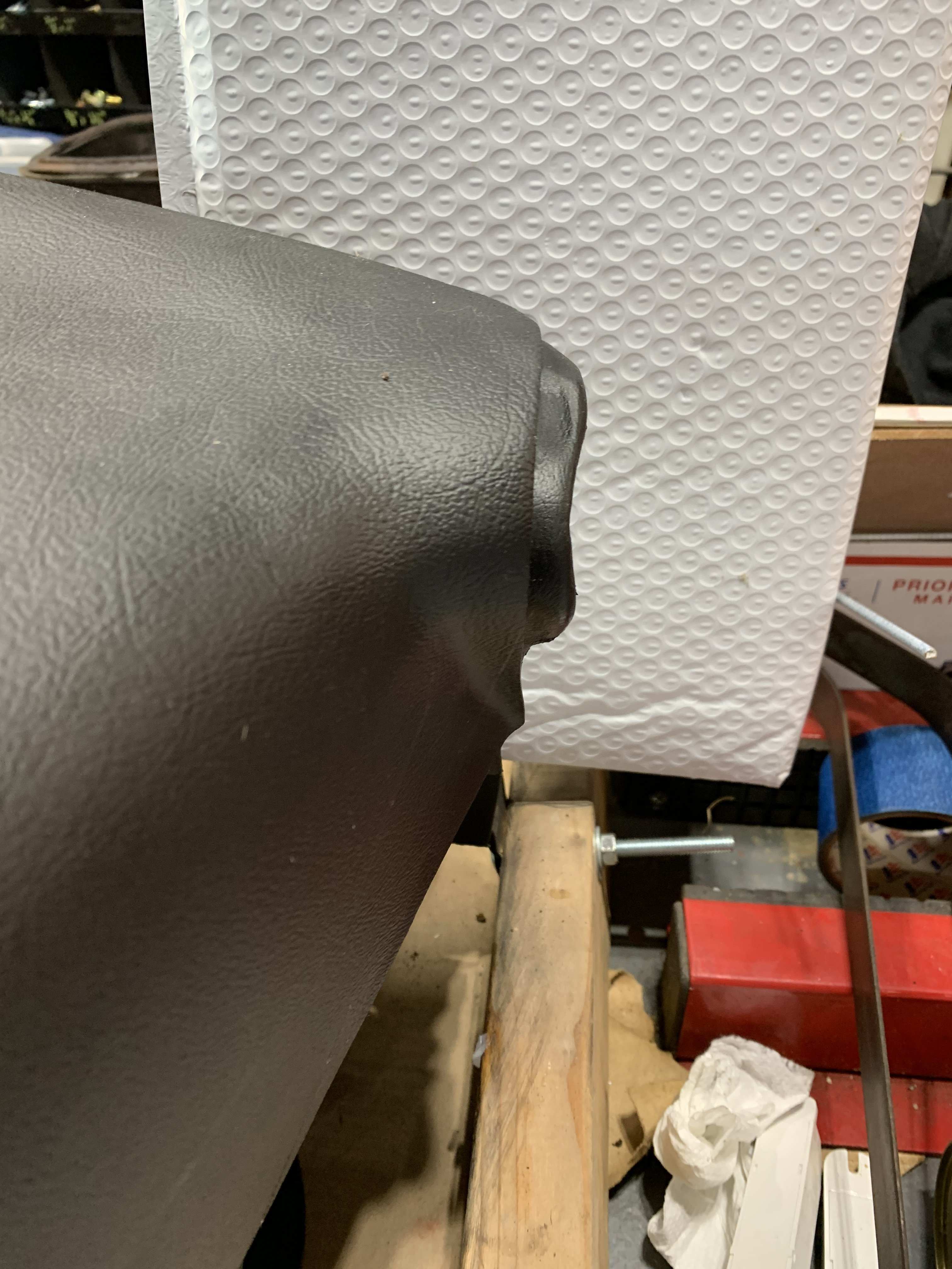

There are a few videos online which show how to do plastic welding and the kits are inexpensive I think you can get them on amazon. A lot of the dash repair videos have you cut a lot of the dash material out and then fill it with home Depot foam and then Bondo. I think the problem is when things get hot everything expands at a different rate and sometimes things show like with the ABS dashes. If you cut out the buckled crack and then you melt plastic in your essentially putting the same material back in and you don't have the expansion problem. My only problem with this was the vinyl was thin and one spot and when it gets hot out in the sun now it sinks a little bit because there's not enough foam under it. Most people would live with it and it wouldn't bother them. When the dash gets cool again it returns to its previous shape in that spot.

The dash pad looks really good. But I'm not sure we know how it will stand up to abuse by the Sun, global warming, and UV rays. That may also be said for newly restored dash pads by businesses abroad.
If it was painted, is it rattle-can or 2K paints?

I used sem landau black with a matte clear on top. I did rattle paint it. I really wasn't sure I was going to like it for a finished product so I didn't want to invest in 2K paint. I think for occasional use it would have held up just fine. I decided to go ahead and send a second frame I have for replacement foam and vinyl. The quality level of the car I'm restoring is a bit higher than I would have been happy with for this dash
