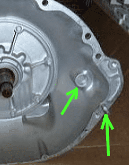

Some bell housings has a dual pattern for one of the starter bolts - maybe in the wrong slot.
It happened to me when using a 130 tooth flywheel it would barely catch and grind - just took it out and checked the holes.

Being an "auto" not much you can get wrong is there? Starter locates off a stud and the nose pilot I believe. What starter are you bolting on? Some "mini" have a clearance issue with the block I hear.

It could be the starter itself or it might just be a spacing issue. Does your trans have the thin sheet metal debris plate still on it?
