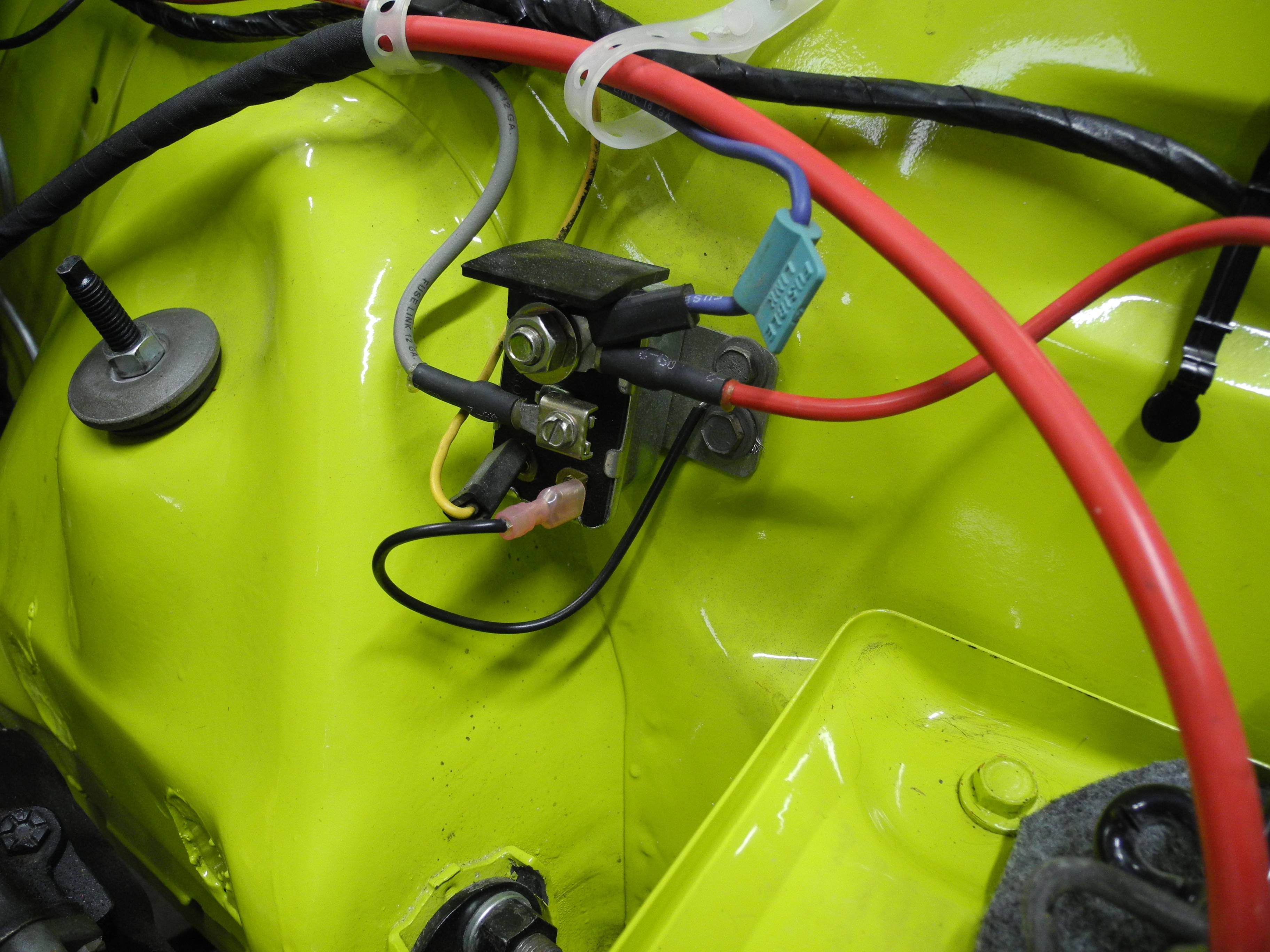

I'm really showing a lot of Mopar ignorance here, but I have to ask - Where is the starter relay on a 71 Challenger R/T? It was relocated for a trunk battery application by the prior owner. I just want to put it where it belongs, not under the car somewhere.

Just to the rear of the battery.
Ralph
Mar 5, 2013
350
71
Here is a picture of it with the motor removed so you can get a better idea of location. There are two sheet metal screws holding it in place on the inner fender. Taken from 71 challenger RT
