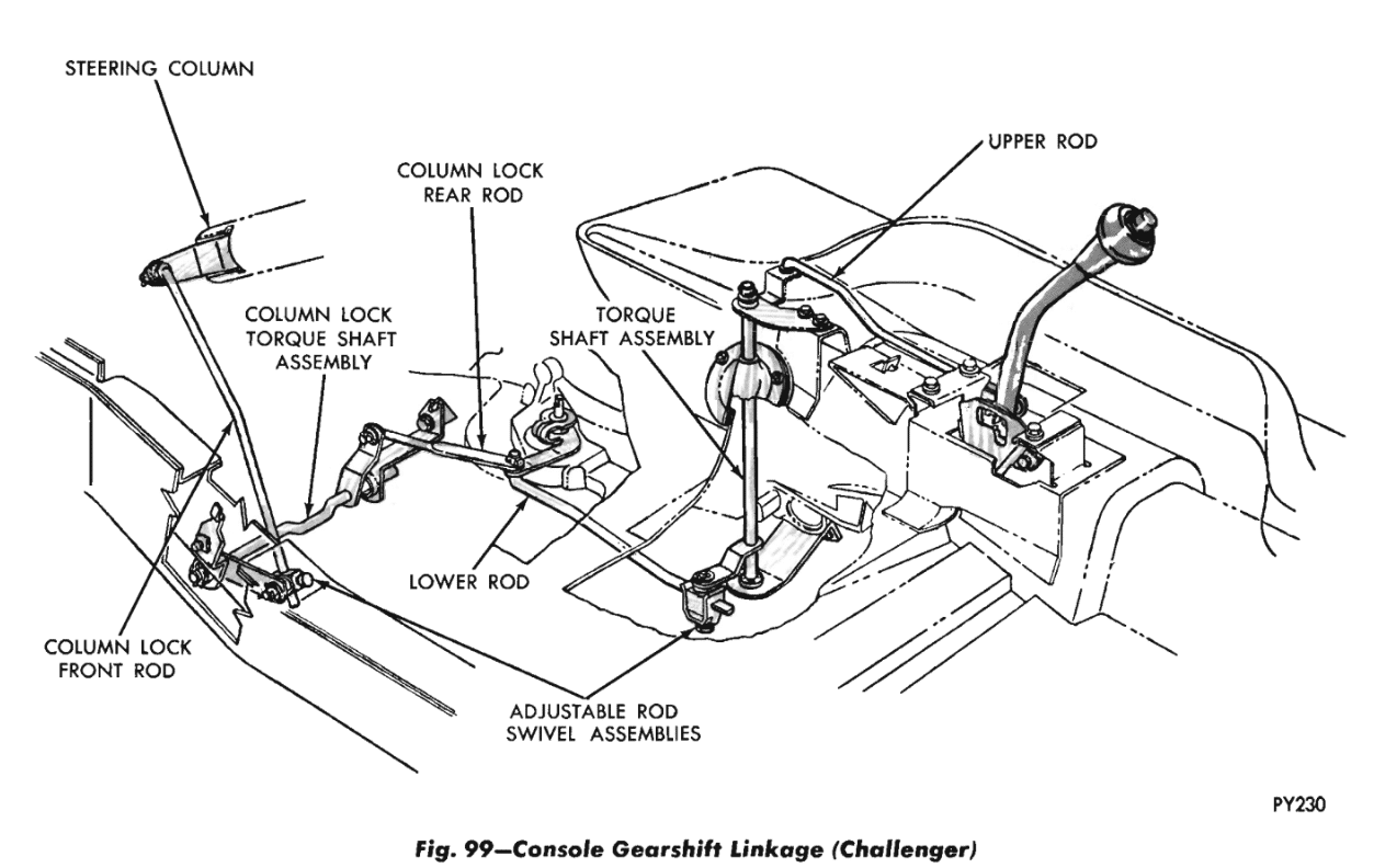

I noticed my ignition key was not smoothly going in and out of the ignition, so I applied some graphite and it seemed to solve the issue. A few days ago, I drove the car and when I went to shut it off, the key would not return to the release position. The assembly is stuck one position forward- one click short of the acc position.
How can I get this issue resolved?
As noted, the shifter/column lock front rod in your floor shift 1970 Challenger may need adjustment:
After the shifter linkage itself is adjusted to match the transmission internal detents, the column lock is set with the shifter in park by rotating the column section inside the car to allow key operation and adjusting the column lock front swivel. For more detail see the Automatic Transmission section about console shift linkage adjustment in the factory service manual.
