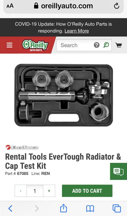

Did you pressure test your cooling system? Does it hold pressure? Free rental at Oreillys.
