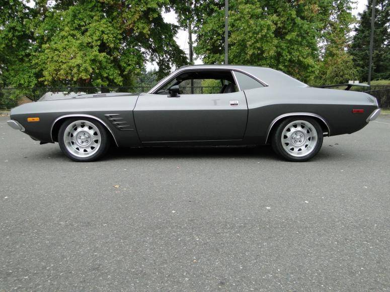

Sorry for the delay in response, the gas smell is greatly dissipated. DetMatt, the capped line when all the way back to the fuel tank. There is still some smell but I expect that. At some point down the road I'll replace the tank and all the grommets/boot gasket but for now I think I am good. I want to ask yet another question if OK. I think I have a bad fuel sending unit. When I ground the wire to the unit my gauge reads full but when connected it reads empty. I also tried grounding the grounding strap with the wire connected to no avail so I think I will now move to replacing the FSU. Here is the question, do I need to drain the tank to do this and are there any gotcha's that I need to concern myself with? It looks pretty straight forward. I think I will take off the driver side rear tire to give myself more working room but other than that, any expert advice?? Also, per DJ's request, here is a picture!!
