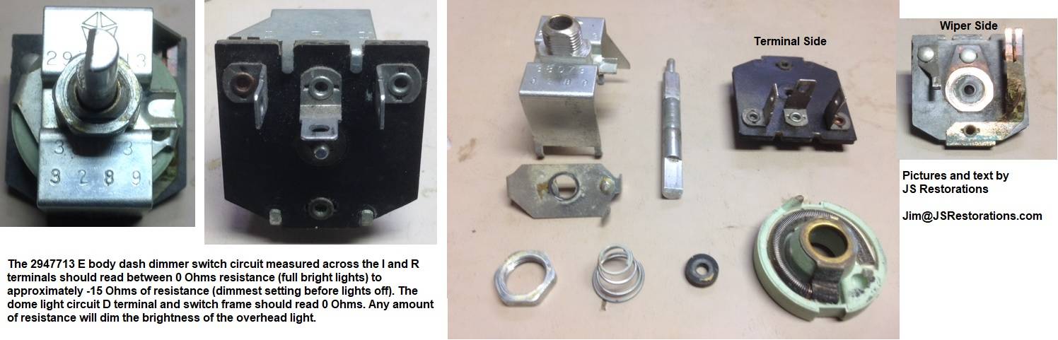

Some info on the dimmer switch that Slotts a.k.a. JS Restorations put out in the past.

cool... thanks for the pic... very helpful
