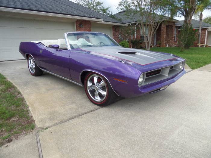

Sorry for the late reply. The car had a Magnumforce set up when I bought it so I kept it. If I was buying today I would go with Gerst hands down.
Your four speed should not require any mods. Just the correct clutch, flywheel and bellhousing. You may want to gear down a bunch because not having an OD sucks.
My fronts are 19x9 w 4” BS. Running a 275/35. It does rub in tight turns even though we trimmed the outer fender as much as possible but this is more due to the car being so low.
Hope this helps.
