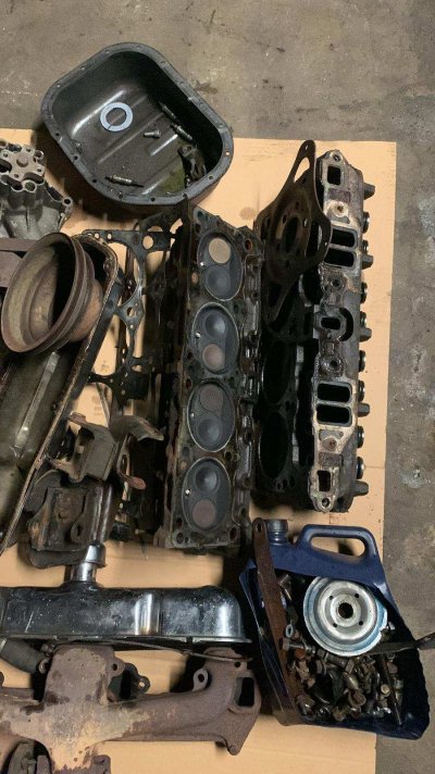

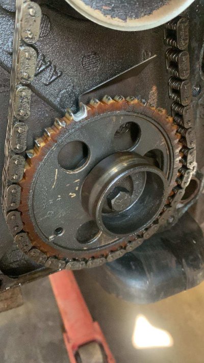

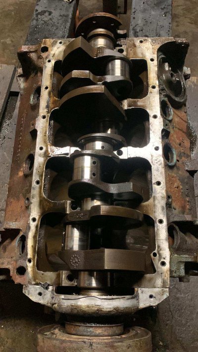

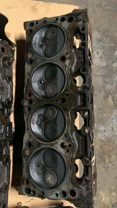

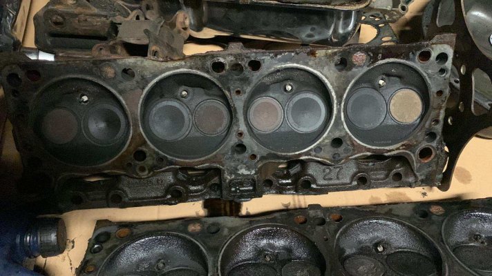

I got some pictures of the block torn apart. I think it's safe to say i gatte look for a cam kit with timing chain.
IMG-20240724-WA0001.jpgIMG-20240720-WA0005.jpgIMG-20240720-WA0004.jpgIMG-20240720-WA0003.jpgIMG-20240720-WA0002.jpg
Those factory "silent" cam gears were a curse and a blessing. Curse because they'd break teeth off and skip timing. A blessing because back in the 80's you could pick up a nice car that ran like crap and was like new with a new timing set!
Definitely time for a rebuild, but nothing sticks out as looking bad.
