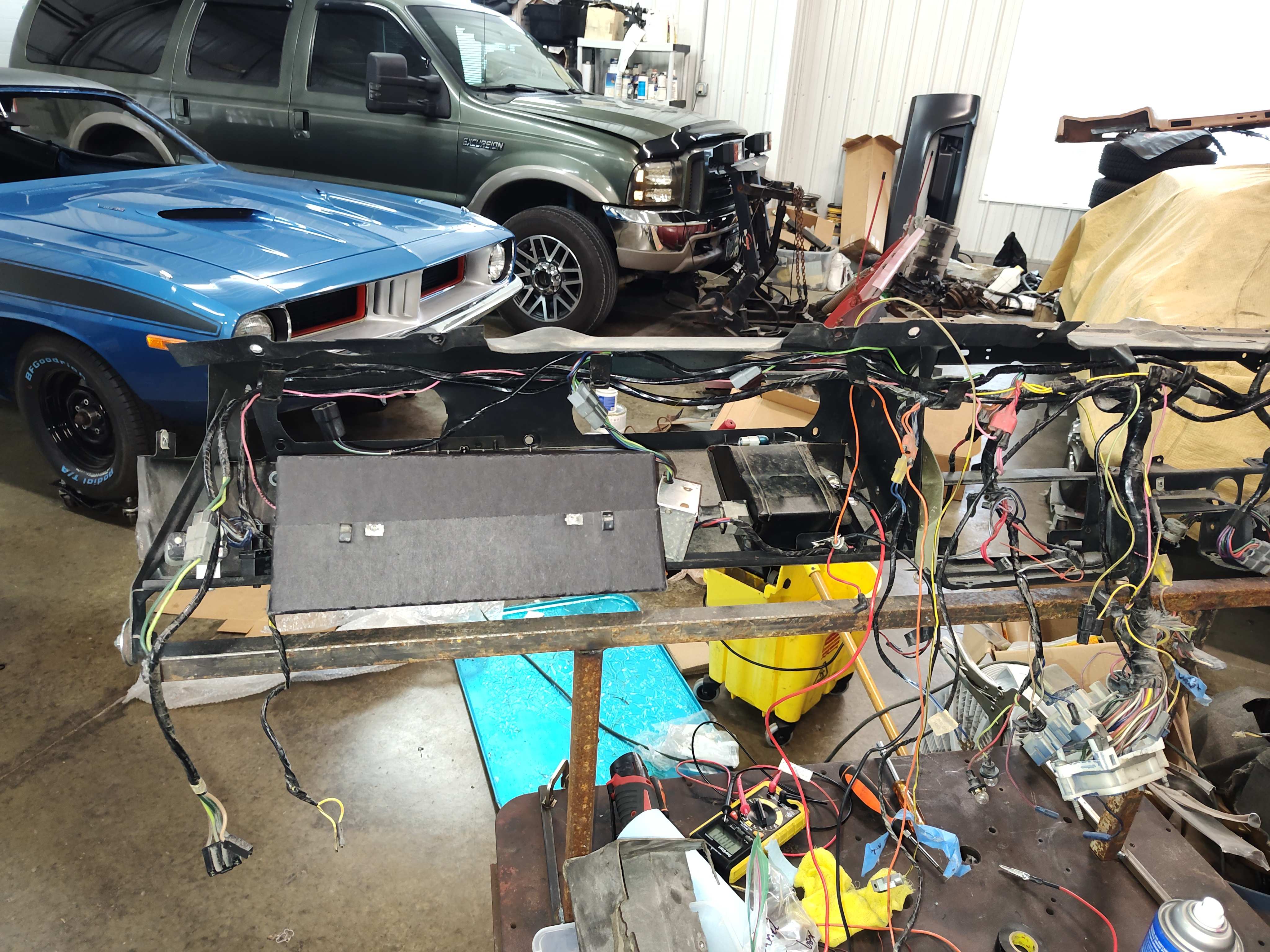

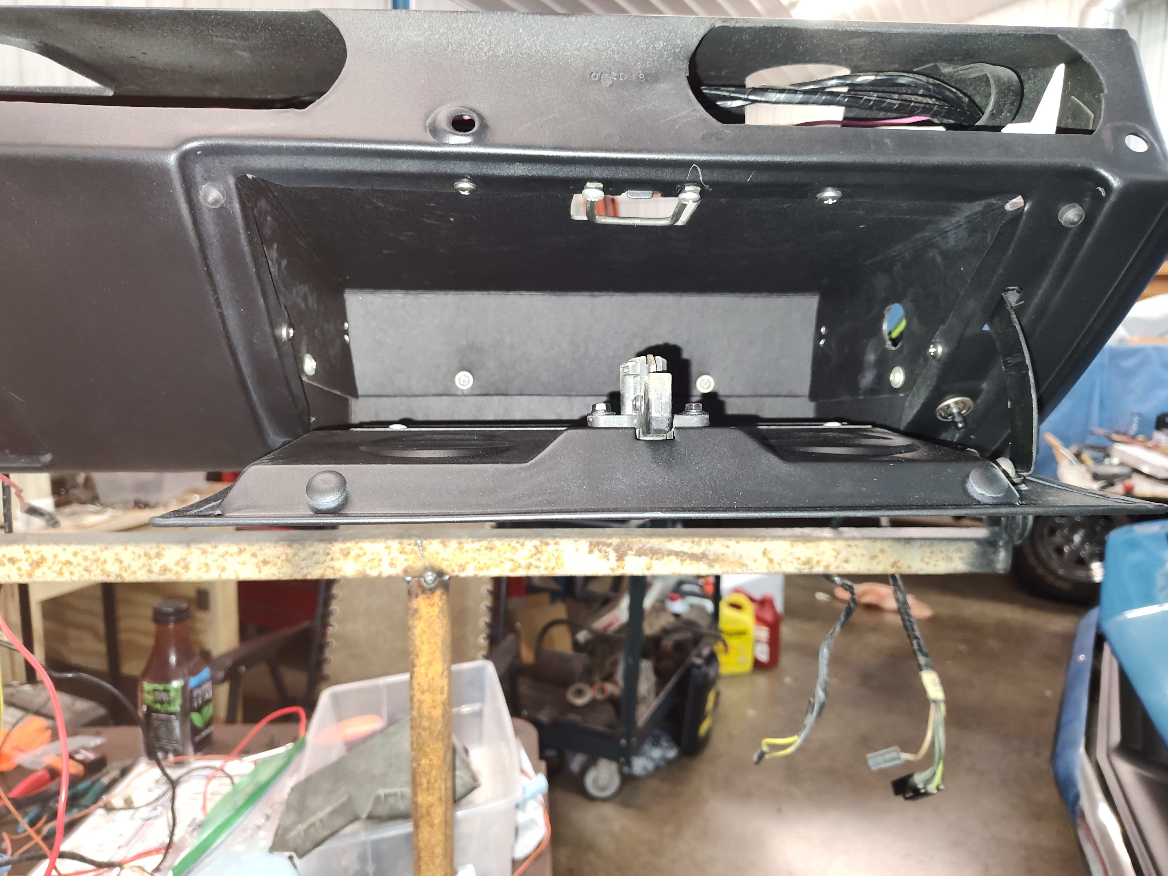

Unfortunately I don't have any experience with changing a dash pad in place but from my understanding it can be done but the front four screws require some creative use of I'm extensions and swivels. I decided to refurbish my entire dash so I pulled it. I was surprised how easy it was. When the steering column down it was a matter of literally four screws in the front the two nuts on the side and disconnecting the fuse box heater cable wires in a couple of vacuum hoses. Once you have the dash out it's nice because you can go through and fix wires and light bulbs etc. I've included a couple of pictures of my dash frame mounted to the jig.
